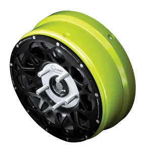

So your front wheels can be locked, however I wouldnt recommend it. It would be similar to a welded differential or a spool. It would not be selectable so it would be 100% all the time. Which would create alot of tire scrub and ruin your fuel mileage.
A different route for more traction on your hybrid would be electric wheel hub motors. There is some guesswork to be solved but it is something I have wanted to do for muscle cars or fun 90s fwds for a long time. Here is one company offering options.
https://in-wheel.com/en/solutions-2/direct-drive-in-wheel-motors/
Yeah I've thought about this for the rear wheels- getting the software management right would be the trickiest part.
It'd probably be "easier" to swap an AWD EcoBoost rear suspension and Escape Hybrid AWD PTU. Still would involve a good amount of fabrication and modification on the driveshaft/half-shafts, most likely. And intelligent AWD power control would be a whole vat-worth of worms, but could be simpler to just enable/disable the RDU clutch on demand (maybe could get fancy and PWM dial it).
Well one other thought is Fords own E-axle kit they put in the MachE. It was offered for a while in Ford Racing. Presumably there would be similar throttle programming on its control systems given that its a Ford product. Still would take a bunch of programming and sorting out. But it sure would be fun to kick in the rear drive and add in another 280 hp. The weight would go up because you would need another battery pack. So call it a 4800lb truck with 475 hp. Still not too bad.
