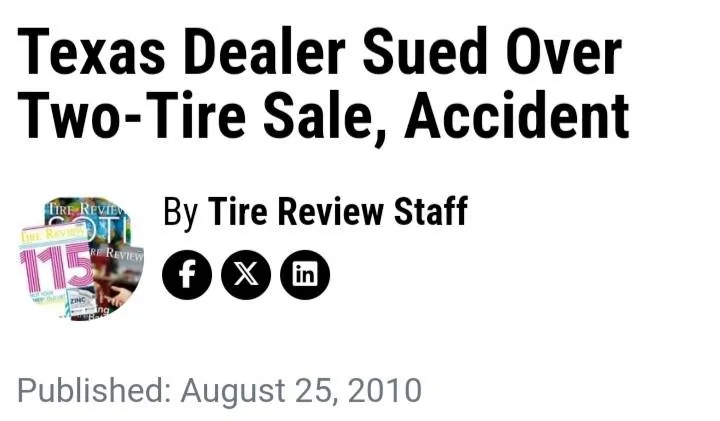

Ford Maverick Dealer wouldn't do Tire Rotation because 2-3mm difference Front to Back. 30k mile service. 20241010_073635
Right or Wrong what if.....(the decedent could have been driving too fast for conditions.) But what if....? ( The new tires had been properly placed on the back??)
Just the hint of a lawsuit involving a death. Add a sympathetic jury.
That'll tighten the sphincter of a corporate attorney.
Anyway you look at it.
It's going to be $$$$$$$$
It's funny.
Everyone hates lawyer's. Until they Need one.
Then they want the best there is
🦈 or 🐈
