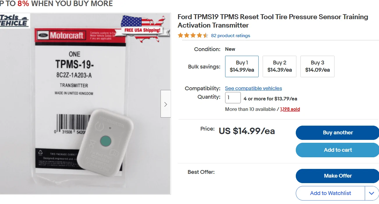

Try, with the key in the on position but not running, press the hazard lights button on and off 3 times. The dash will tell you in activation mode and to start on the left front wheel. I installed a aftermarket set of wheels from TireRack and did this but my TPMS tool failed to activate each new sensor. It even said the learn process failed but they still worked anyways. I bought a 15 dollar FORD activation tool but have not tried it since they are working.
***UPDATE***
This TPMS19 tool did not activate the new sensors from TireRack. I was able to use my Foxwell TPMS tool to activate the sensors and relearn after a software update to the scan tool.

My cheap programmer, like the Amazon one above, worked just fine
