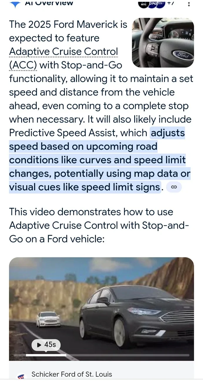

These tips may help.
While the 2025 Ford Maverick manual has over 500 pages. It also has a search feature.
On my phone I found when I entered into google. "Predictive Cruise Control settings 2025 Maverick."
It came back with this page including a video. It even references this forum😉
