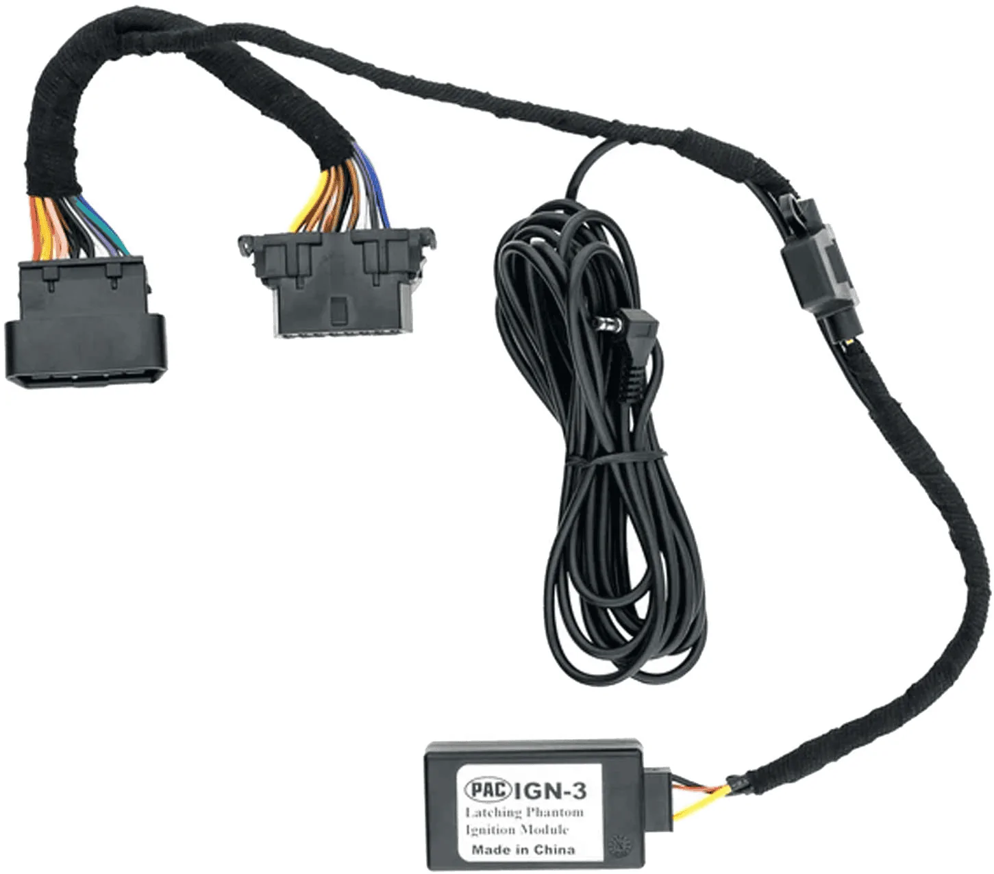

My Dashcam has a mirco b plug for power.
If I can find an adapter I would buy the Ford harness to power it.
Any idea the size of the connector on the Ford Harness?
