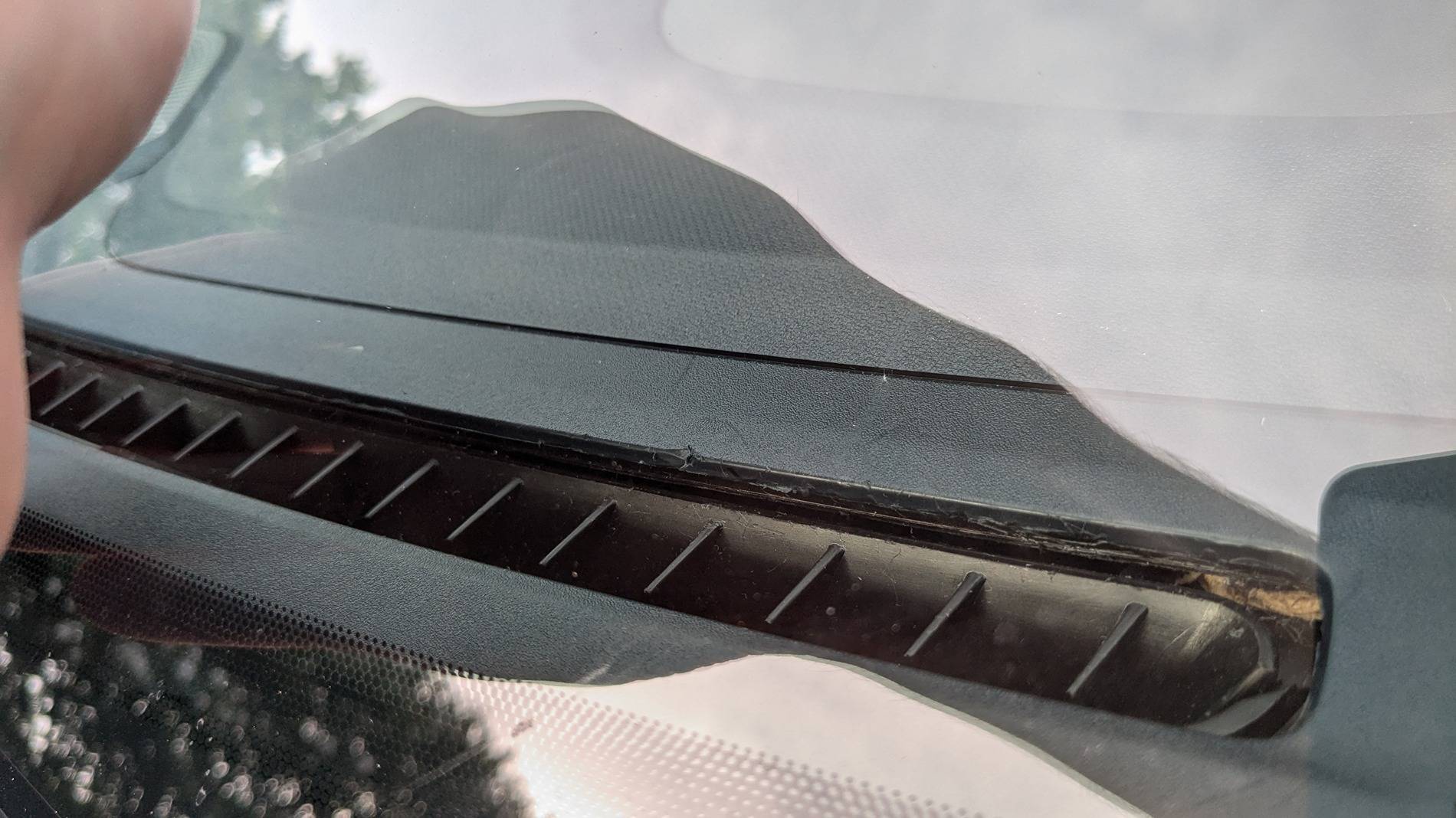

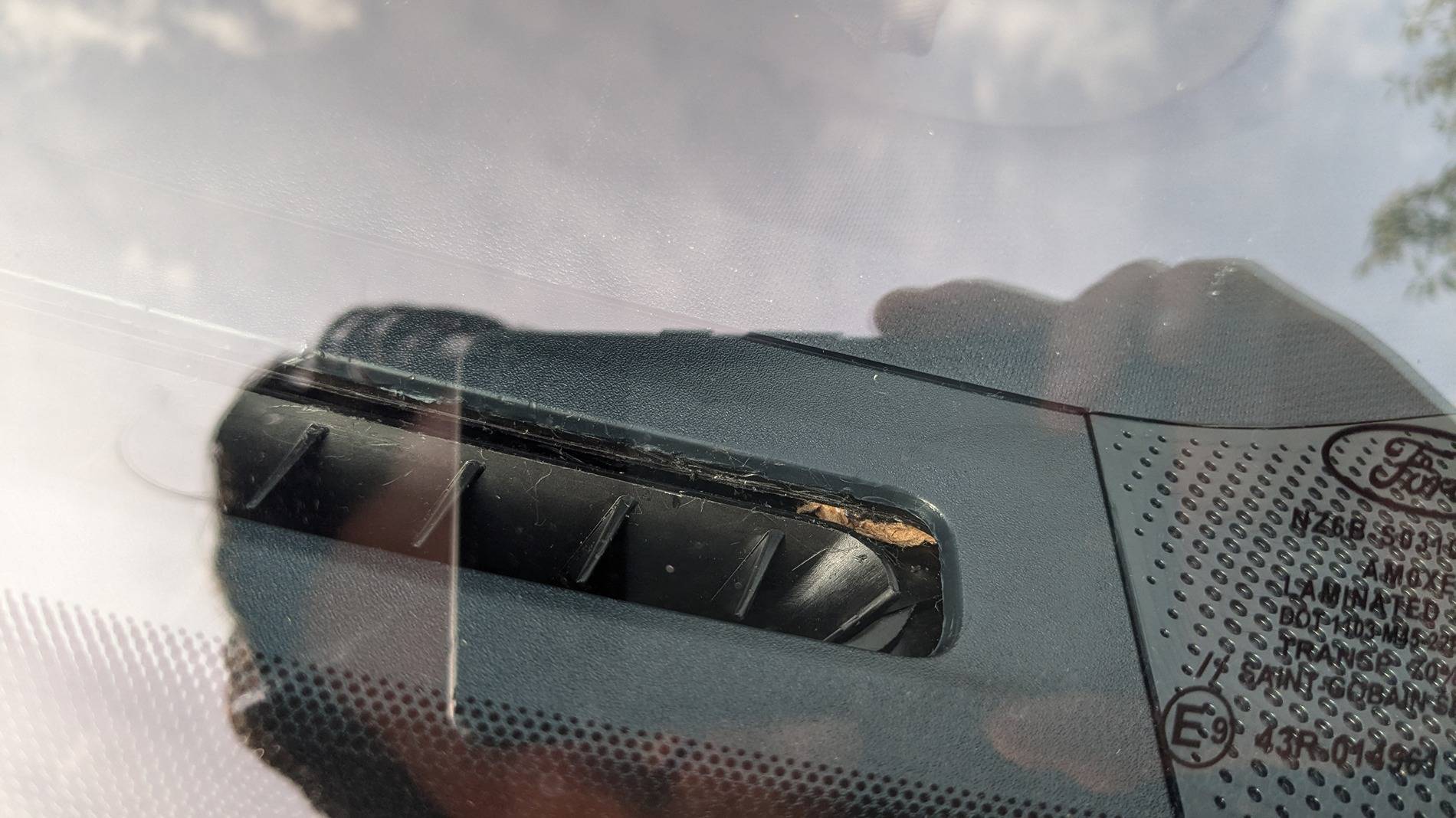

I have the same rattle, had one of my local dealerships take a look into it - they tried to fix it by stuffing cardboard into the defroster vent! they scratched the heck out of my dash doing so, really upset about this.
I took matters into my own hands and attempted to put some foam in between the dash and the vent,, reduced the rattle by about 50% but it still drives me mad.
This is what mine sounds like. If I push on the vent it stops.

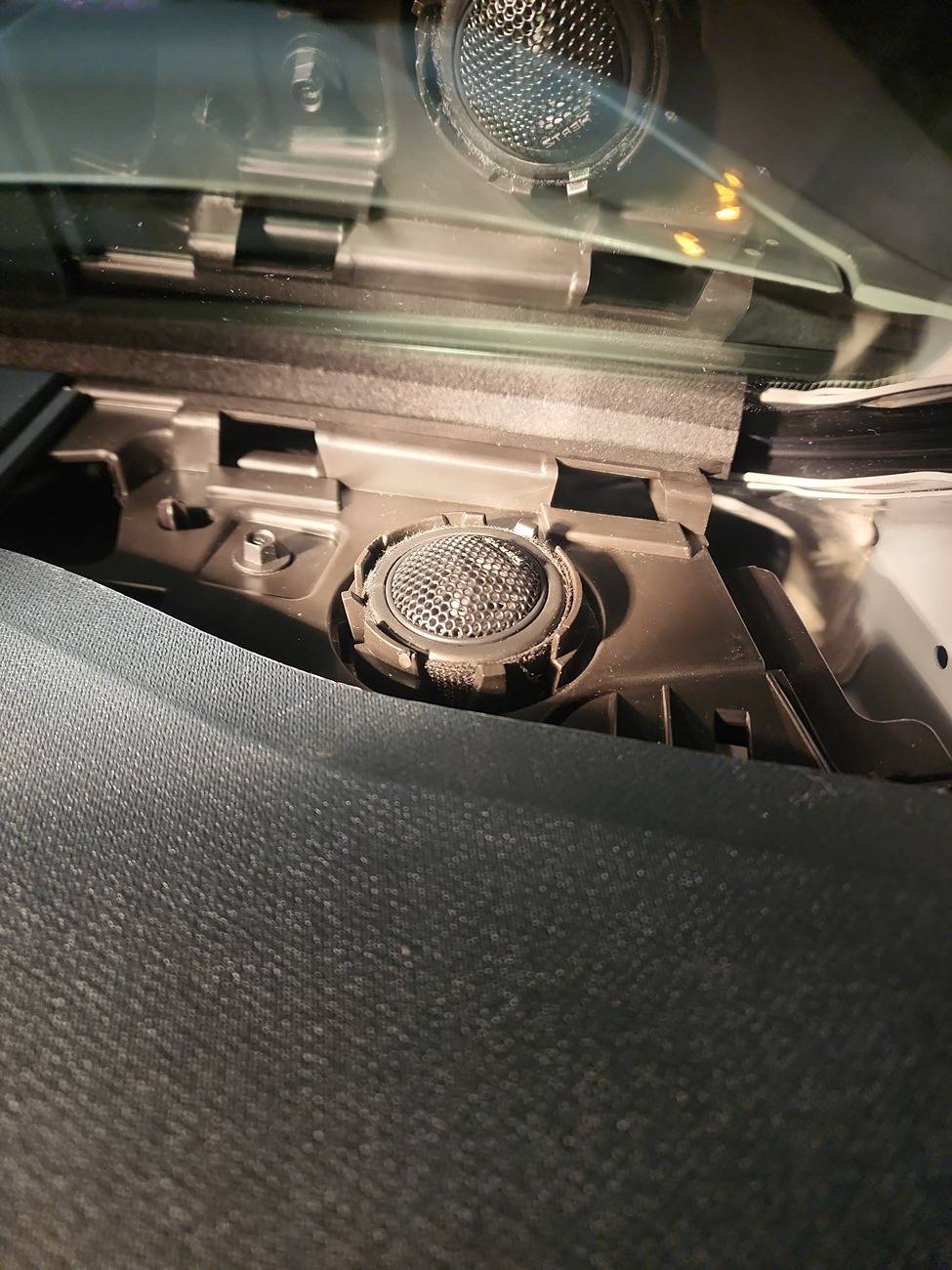

I don't have the dash rattle but I noticed on my 24 XLT there's a 1-in by 1 in thick piece of foam up against the edge of the dash and the windshield. Was noticeable when I upgraded my stock stereo replacing the front tweeters. Might be the fix you guys are looking for.
Interesting...you bought it new? Not sure why they didn't suggest the same on the TSB then.
