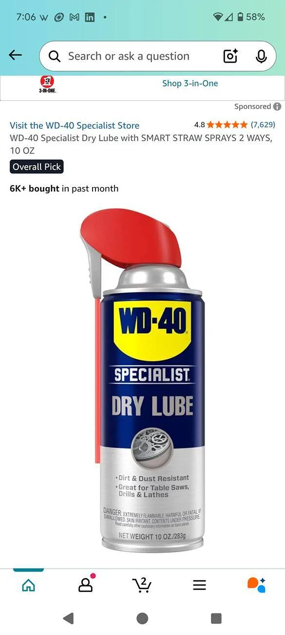

UPDATE: WD40 dry lube for the win! When hot my dash was quiet but on cool or cold days it drove me crazy. I originally tried the WD40 without success and kept trying foam, O-rings etc. with nothing working. I tried the WD40 drylube again spraying it back more toward the steering column and this time it worked. I've been rattle free for about as month. Thanks Strydertortois for the help.

Where exactly are you spraying this? Noisy dash and battery issues are my only really complaints about the Maverick, both quite annoying.

I sprayed a good bit of it between the (blue) dash and the (black) defroster vent. Driver side. Had to spray it back towards myself. Laid the can flat and aimed tube back towards me. Make sure you have the dry lube. Good luck, it took me a couple tries.

:eek: Dang I think that dash noise is truly driving us nuckin' futs if we're resorting to spraying mineral oil into our dashboards! Don't get me wrong, if mine gets much worse I may do a blast of it too!
