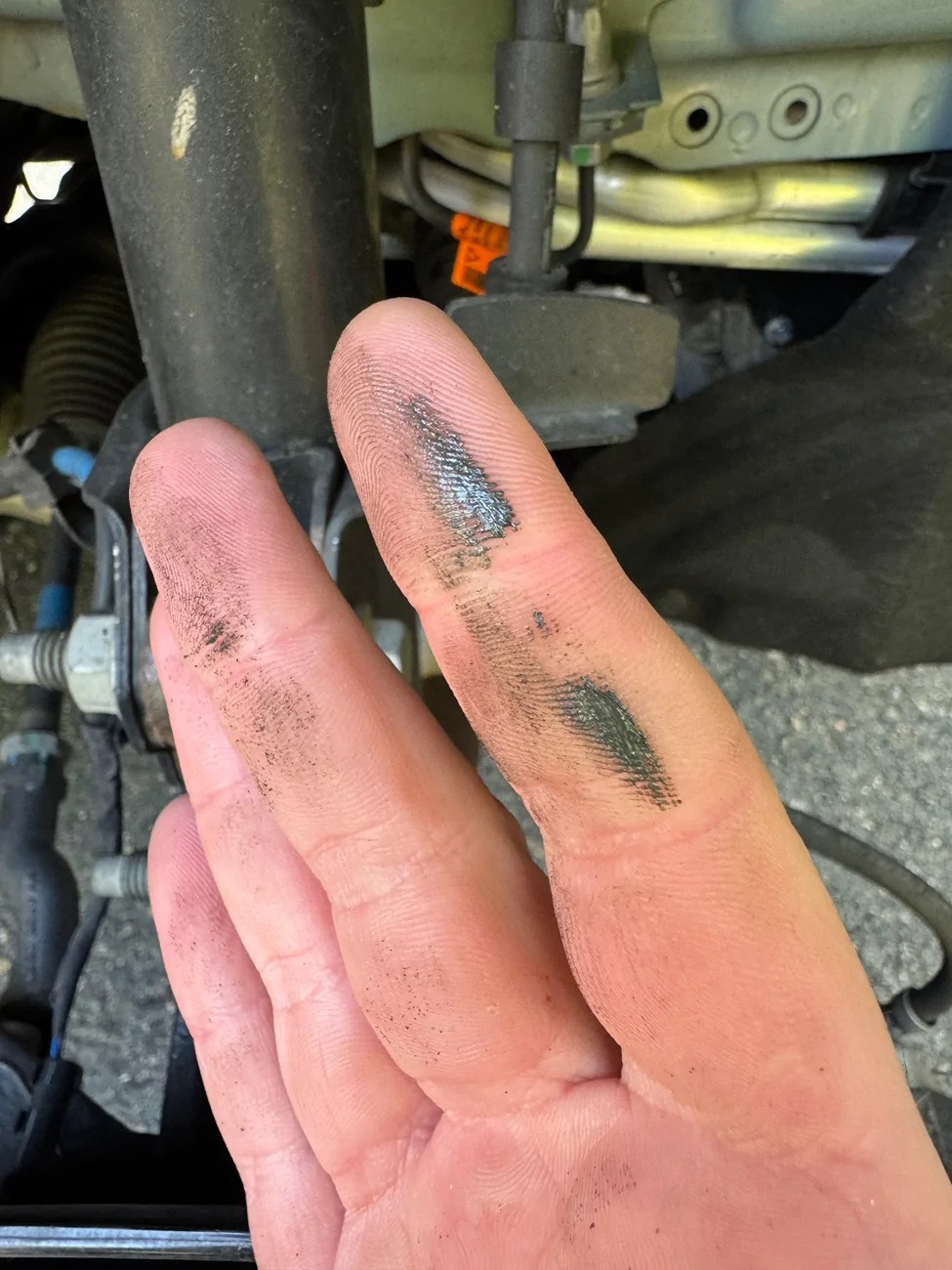

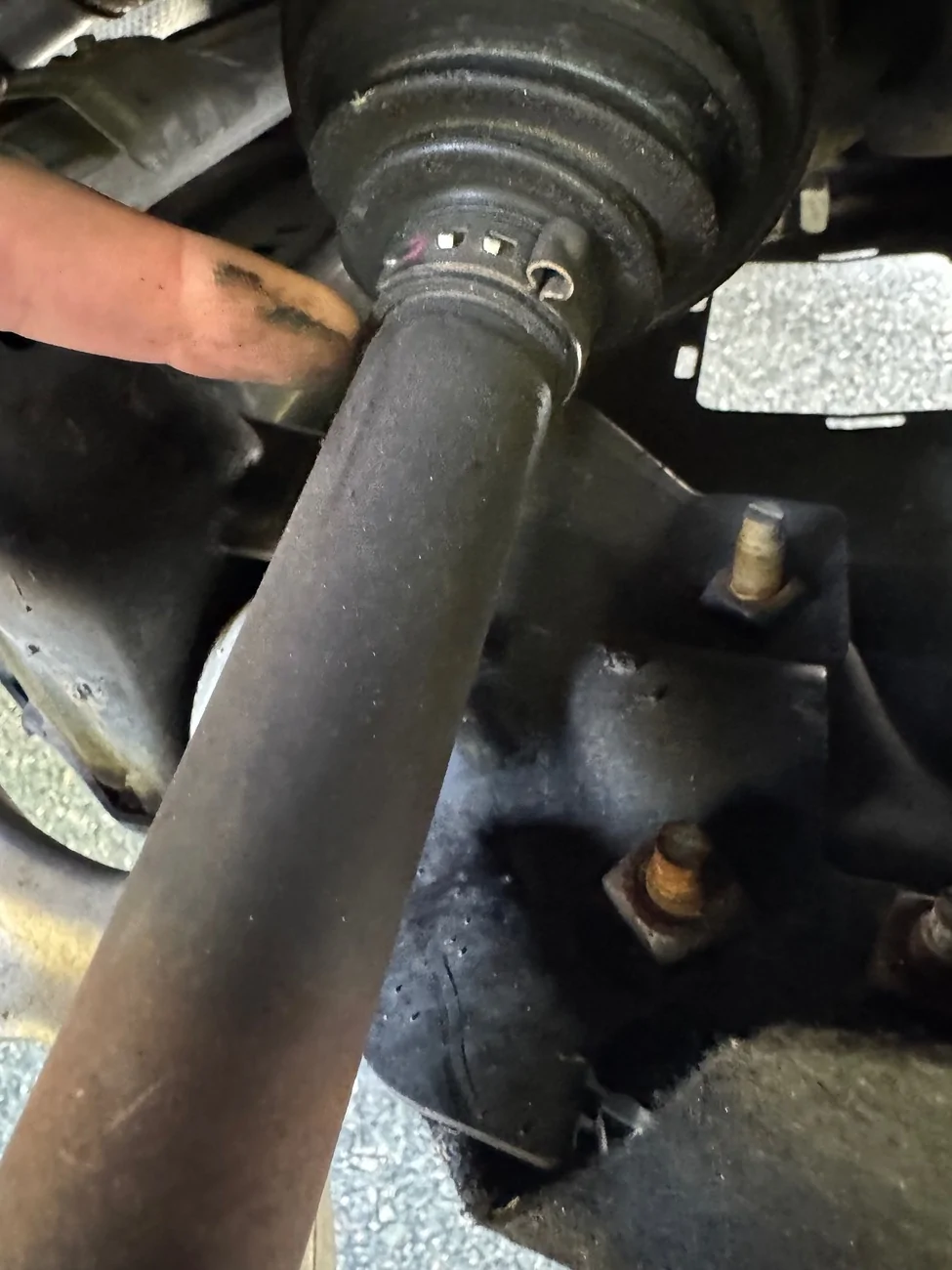

Popped the wheel off today and look what I found. Grease at the base of the boot.
Put that back!
Don't want it looking too clean.
On boot 2nd crease, left of top center, whitish spot in pic - start of a tear, or just the camera, or fluff?
Had your 10K services done?
Just imagining if they keep playing hard ball, will they bring up boots being examined every 10K?

On boot 2nd crease, left of top cent, whitish spot in pic - start of a tear, or just the camera, or fluff?
I think it’s not a tear and they’ve even dir a “multi point inspection” in February
