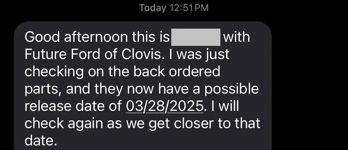

Just wanted to chime in and mention this text I got from my service advisor regarding the redesigned axles yesterday.
Gary,
I don't have a problem with my axles yet.
I appreciate you taking the time to keep informed and posting the update
Thank You
GB
