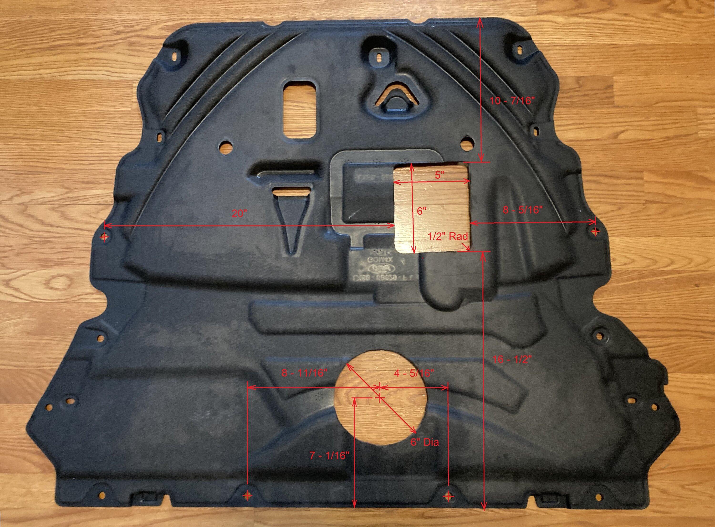

I found this a while back. See if any of this helps you out. I forgot what power train this cut out is for.....sorry.
Ford Maverick Cut a hole under 2.0 engine shield for oil change accessibility? C36C7D9D-19C9-4633-840B-CEBD1BD347A5

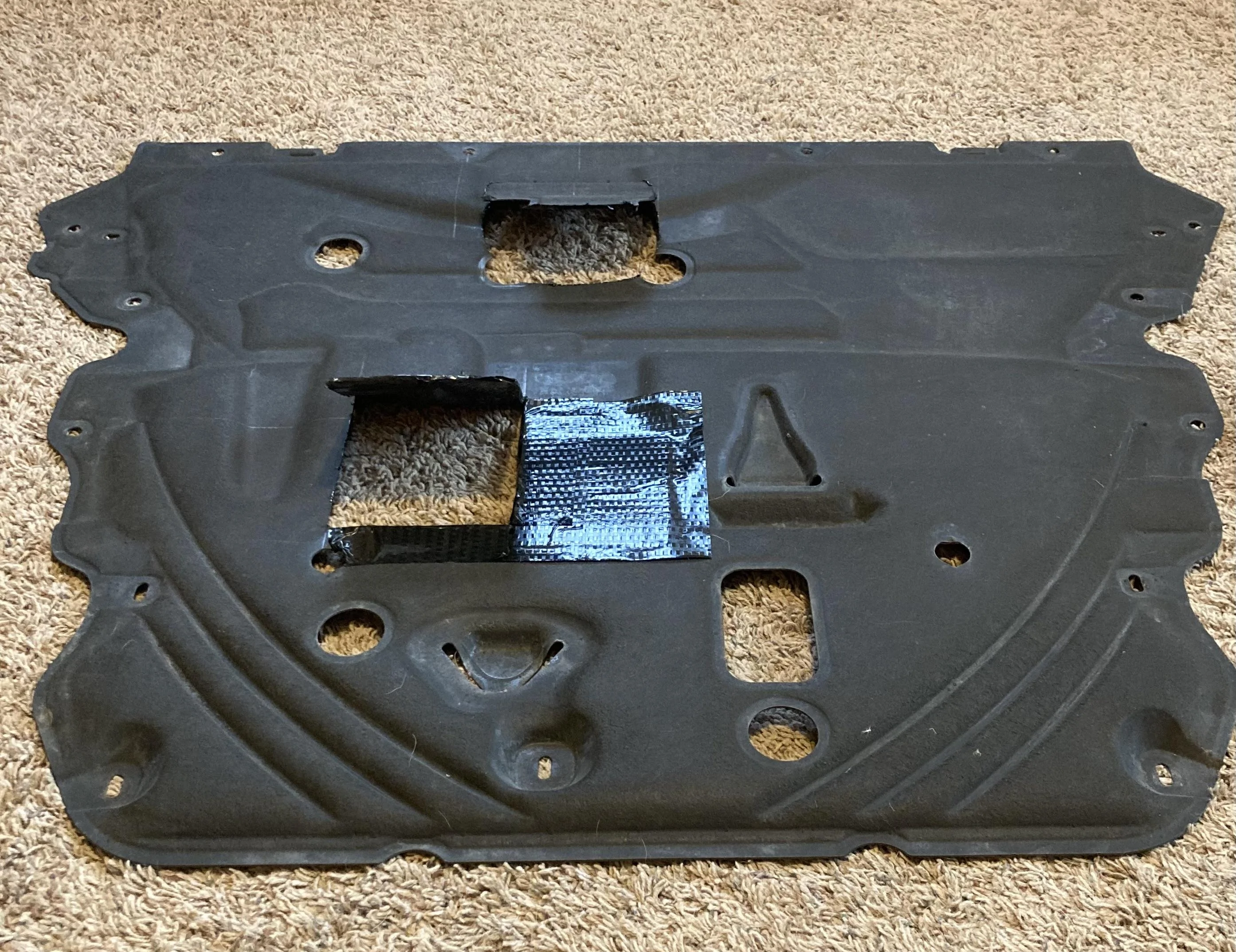

I have that saved, lol. But my shield looks different? Has a large square hole cut already? I have two thumb turn cam locks I’m hoping will work
And I have hybrid. Cam locks won’t be here till Tuesday, I measured oil filter location, and it looks same as pic from thingyverse. My panel missing large part near drain plug is goin to mean just removing more of the panel, not sure how my foot plan is going to work with material missing. Almost ready to cut

Now I’m spooked to start cutting not knowing where the openings need to be on ecoboost vs hybrid ☹ gonna check the thingyverse file for the access panels to see

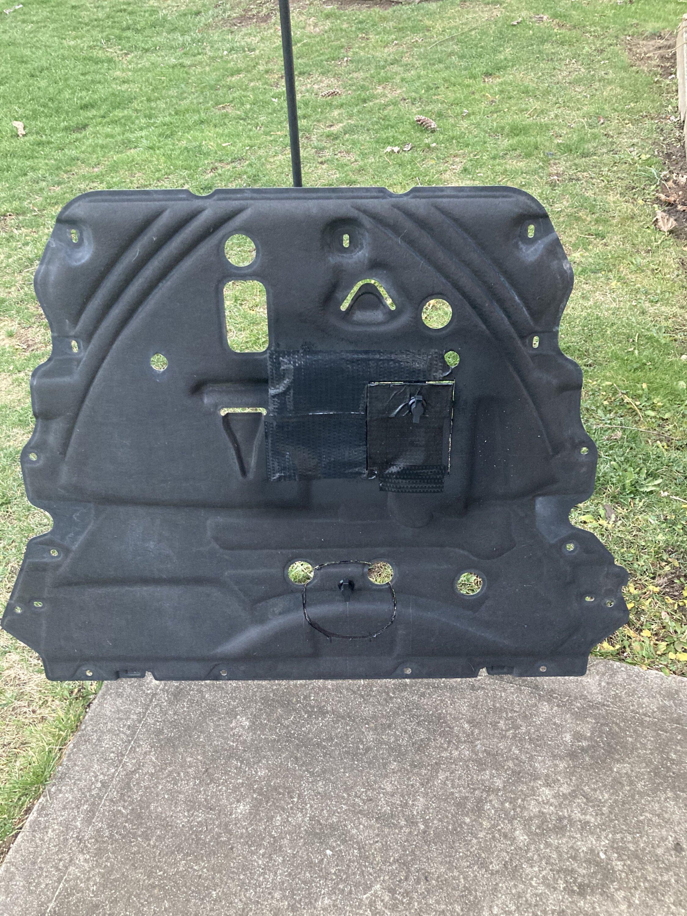

Almost finished, waiting on thumb latches. Had to fill in the big hole
Hoping this works until I get the 3d access panels printed
Ford Maverick Cut a hole under 2.0 engine shield for oil change accessibility? IMG_9691

The thingyverse access panel template that’s for ecoboost motor is the same on the hybrid. Out panel back on tonight but phone was in truck so I didn’t get pick of it installed. Should work perfectly
Ford Maverick Cut a hole under 2.0 engine shield for oil change accessibility? IMG_9713
