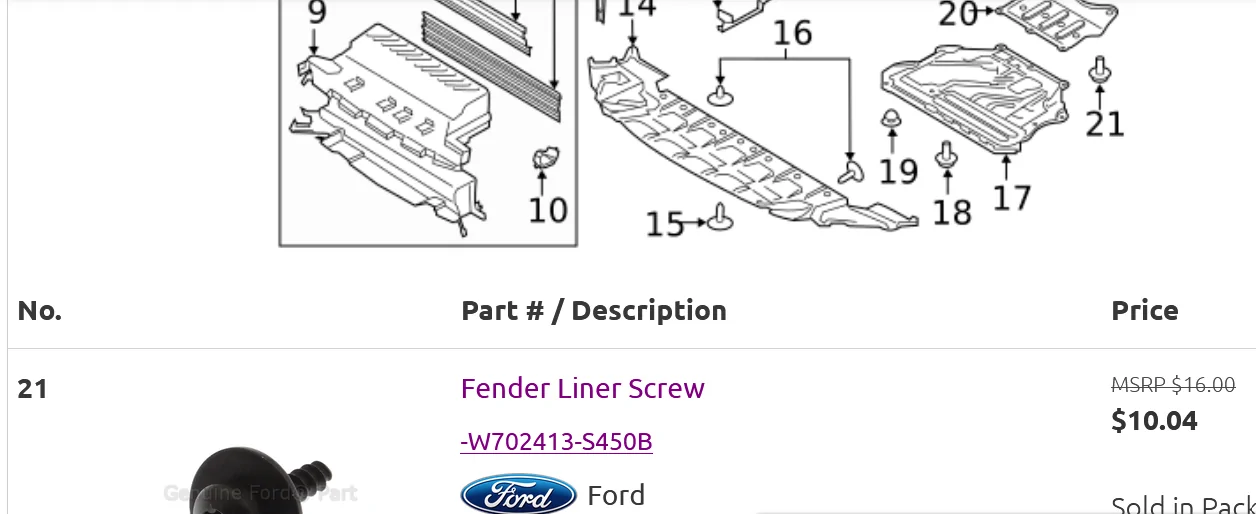

I had an oil change done recently, and about 500 miles later the underbody splash shield came loose. It started flapping in the wind at highway speeds and dragging at lower speeds.
I took it back to the oil change shop, and they secured it with a few zip ties. It's holding for now, but I'd really like to put it back the way it was from the factory rather than relying on zip ties.
Can anyone help me identify which OEM screws, clips, retainers, or fasteners are supposed to be holding it in place? I'd like to replace any missing hardware and restore it to like-new condition.
Any part numbers, diagrams, or advice would be greatly appreciated.
I have a 23 hybrid. There are 15 screws that hold the cover under the engine. The cover tucks above the front and in the middle back. If it's tucked in correctly, it will hang there by itself with no screws. That makes it easy to reinstall the screws. It's an easy process if done correctly.
