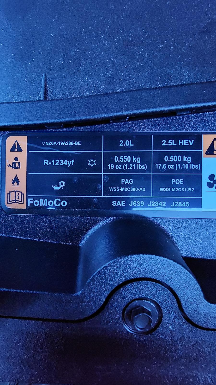

The manual states the spec that you mentioned.
However under the hood it's a separate spec for the 2.0I.
Now go look at 5-30 motorcraft oil and you will see that spec that I mentioned which is also on the sticker under the hood.
Definitely contradiction compared to the manual
