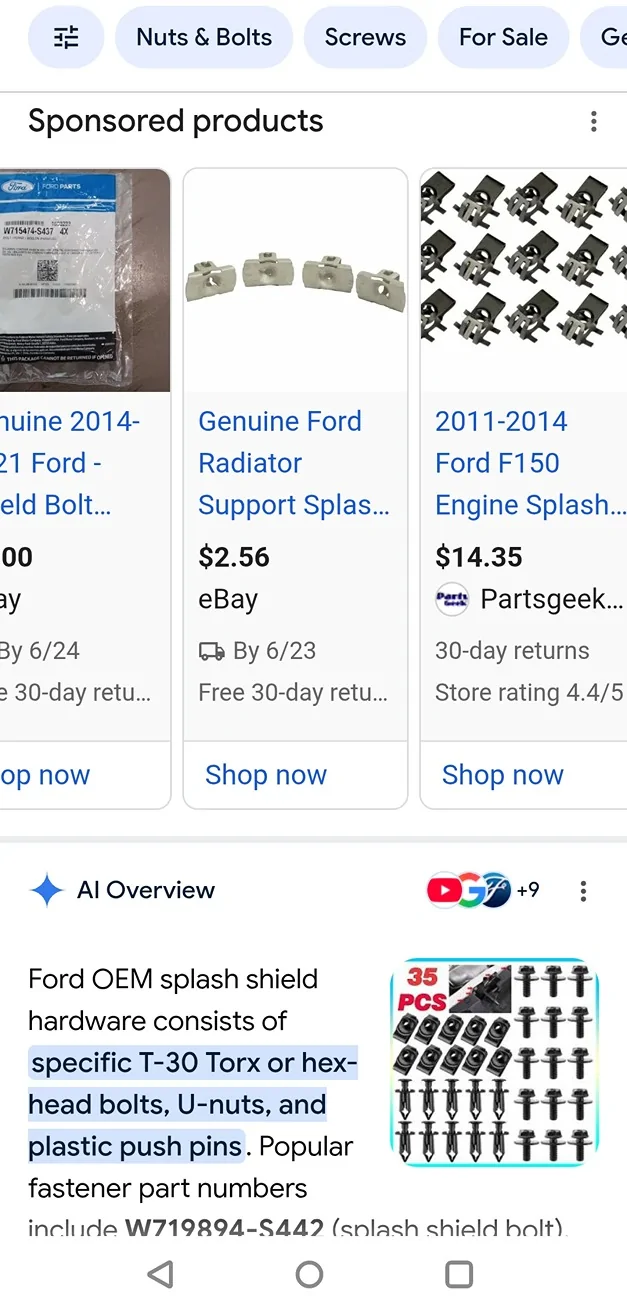

Better might be questionable.
The OP requested OEM.
So I googled and posted OEM.🤷‍♂️

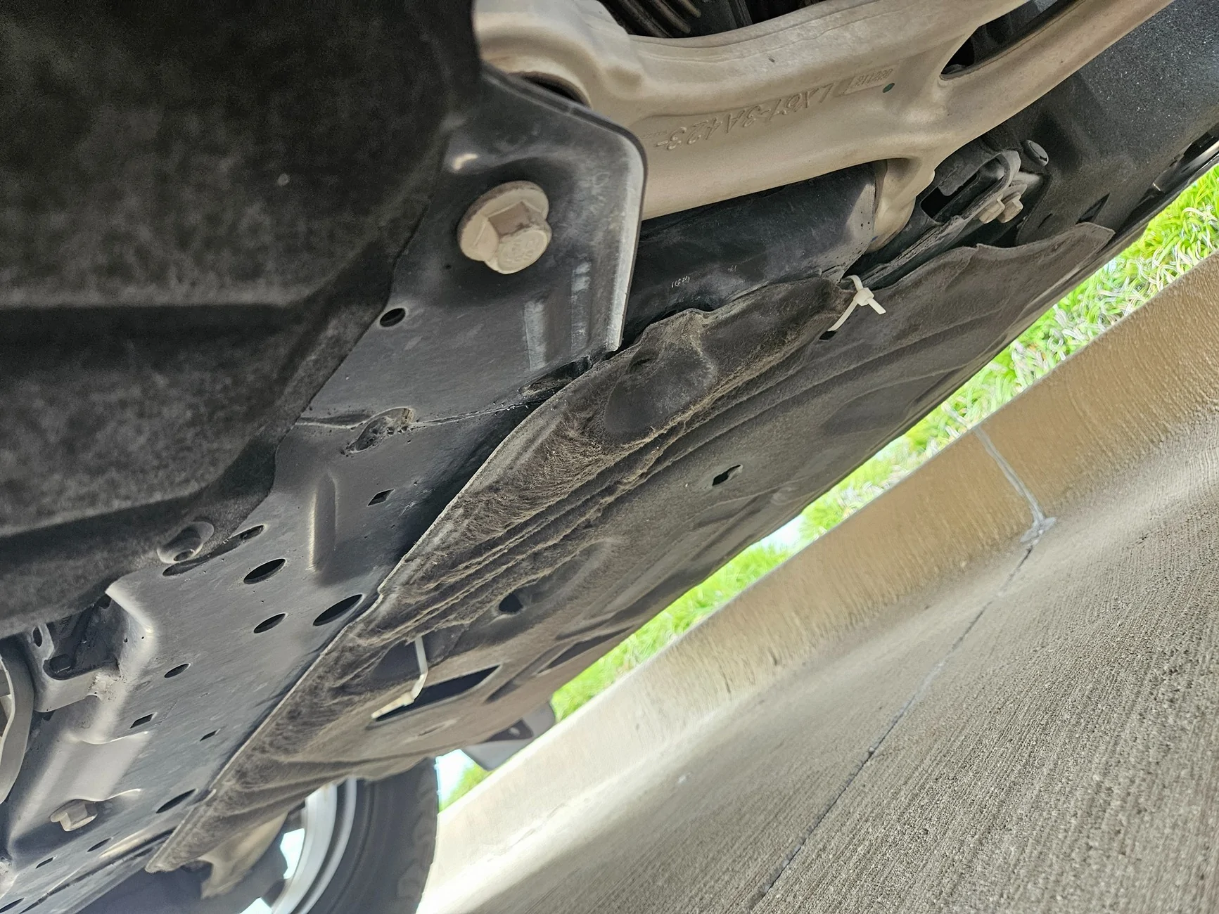

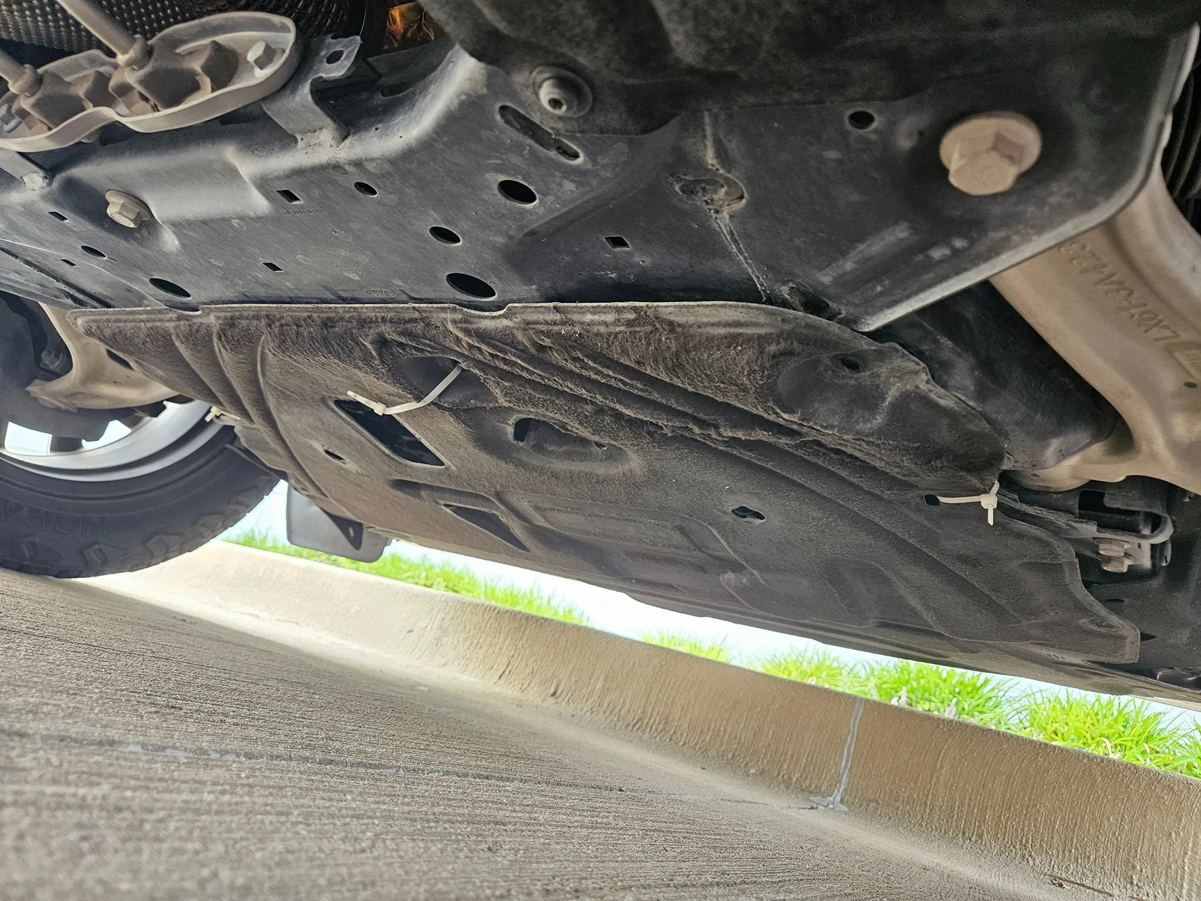

@Glen Baker LLC - Of course I've googled it. I'm a bit unsure exactly what I need which is why I'm here asking for advice.
@DrNoobNStein & all - Please see my photos below as requested.
There are 3 position points fastened with zip ties. The rear of the pictures is what was loose and dragging. The front towards the front bumper did not/has not yet become loose.
