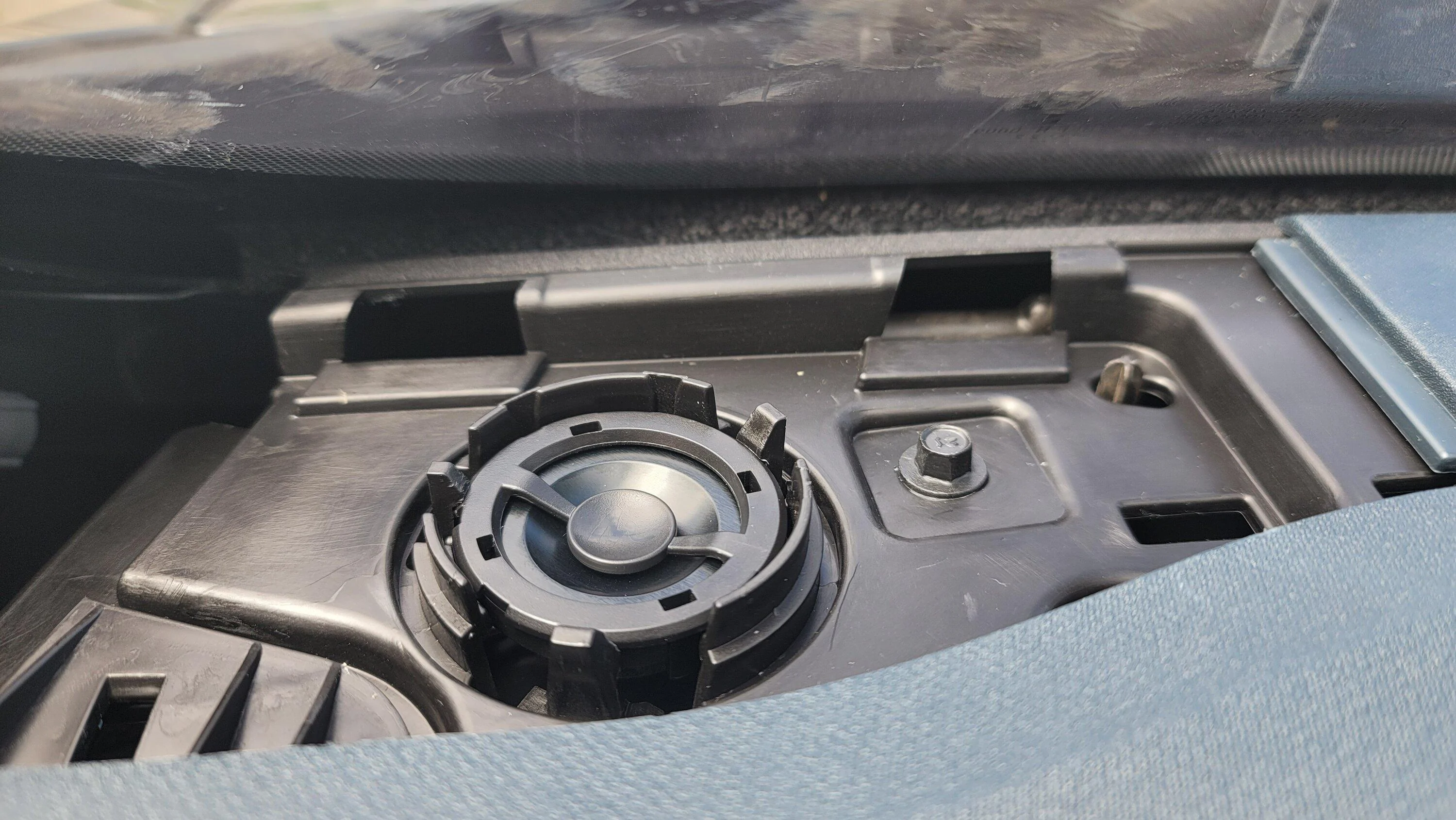

Not my experience. The tweeters are wired directly from the head unit. The crossover is part of the head unit. I will check it out when I get a chance but I installed the Infinity reference without their crossover and it is obvious the components were carefully crossed somehow.
Not according to the wiring diagram. The tweeters are wired in parallel with the door speakers.
Ford Maverick Crutchfield research on the non B&O system incoming... page_2-
MavVa1024
TC
Nov 15, 2021
132
Charlottesville, VA
2019 Nissan Kicks
I am sure the B&O system has the speakers crossed over differently. Specifically, I suspect they filter some of the base out of the signal sent to the door speakers and send it to the subwoofer. My setup with Infinity reference delivers an increased base response from the door simply because they are better speakers. It is almost too much, if I turn up the volume it feels like I could blow apart the doors. That's why a sub is a good idea.

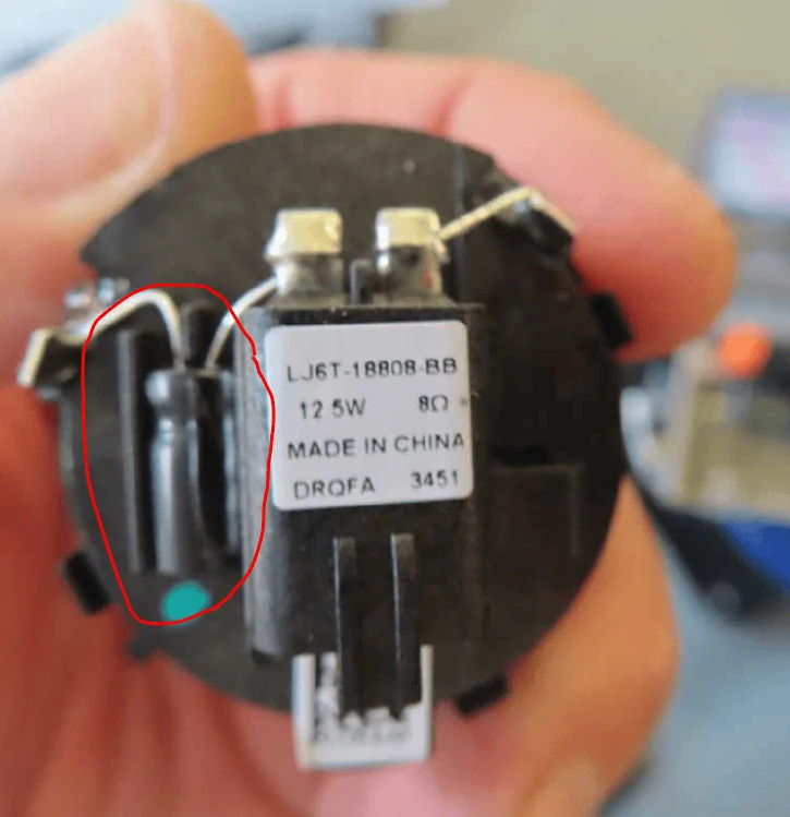

The Non-B&O tweeters are not discreetly amplified. They are wired in parallel with the front door woofers. The stock tweeters 100% have an in-line capacitor ( its attached to the back of the tweeter housing) . If you are installing new tweeters, they should either be actively amplified with an electronic crossover, have passive in-line crossovers, or you should use the crossover that comes with your component set. They may sound fine for a while, but without protection, they are being sent frequencies well below what they can handle, and will eventually fail.

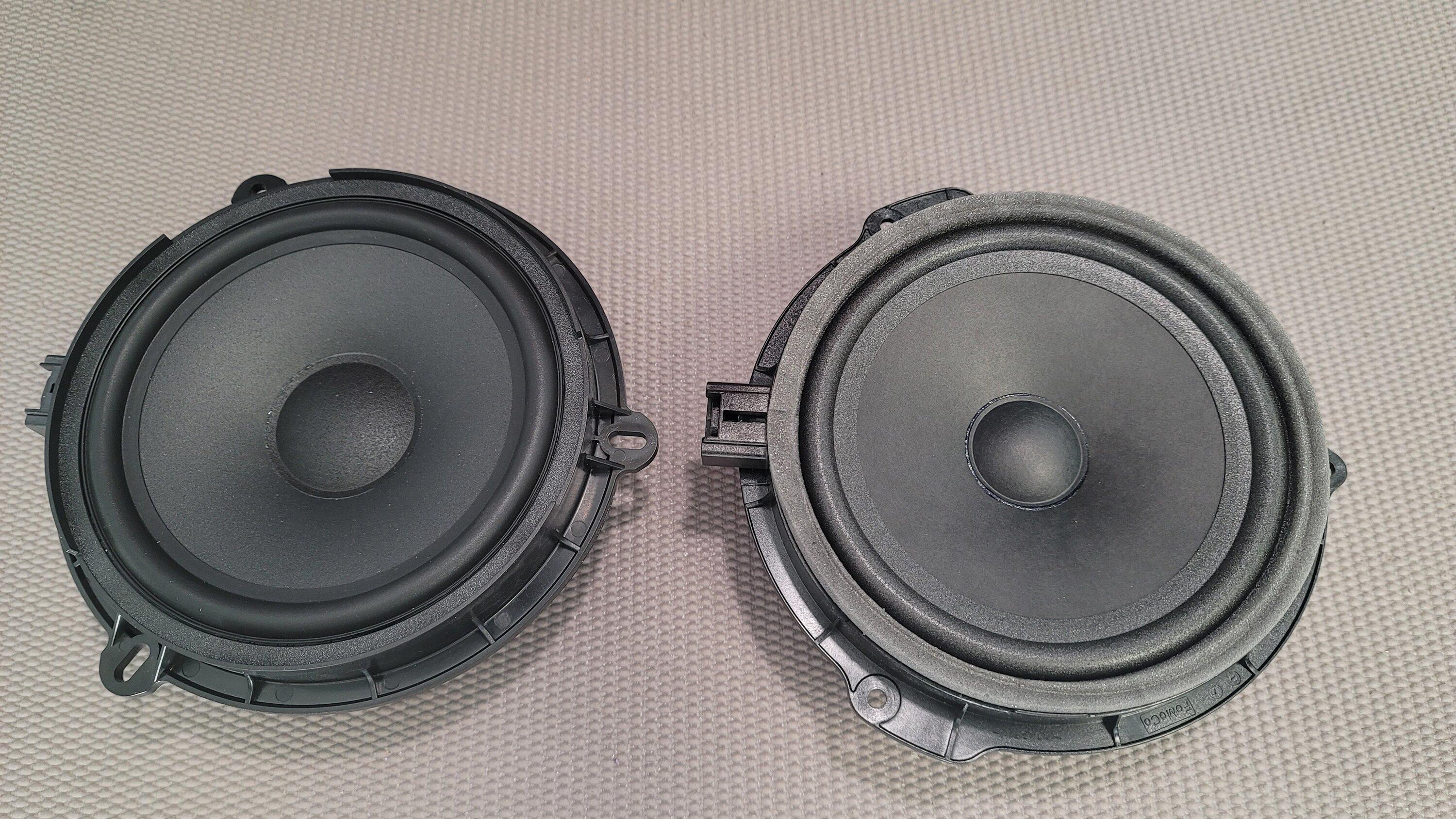

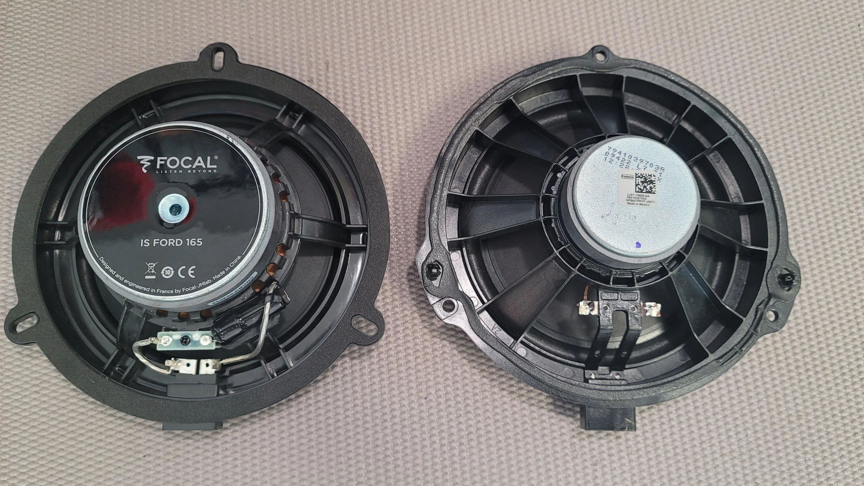

This is pretty similar to the Focal set I shared....same frame work. Differences being tweeter material (which effects sound brightness/harsness), frequency response, woofer material (which effects bass response/extension, sensitivity (a higher number here means the speaker is more efficient with the available power and thus plays a lil louder and protection. The Focals have inline crossover caps on both the woofer and tweeter, irrc the powerbass only uses inline caps on the tweeter. For the price and same installation the Powerbass may appeal to more people, however if you able to demo both side by side, it becomes clear why the Focals cost more.

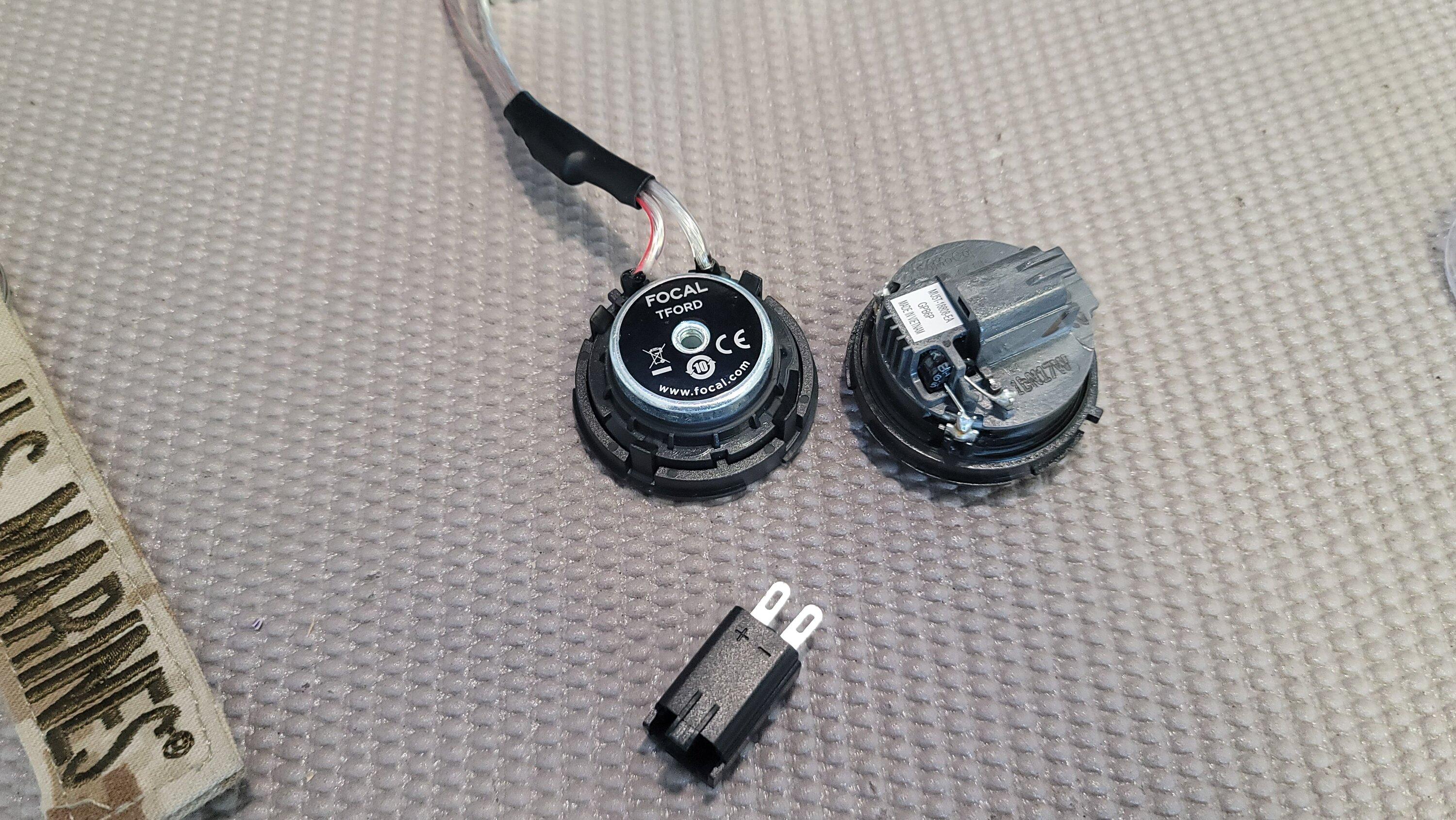

Having pulled apart both the B&O, and the non -B&O. I can 100% tell you that the headunit does not have active crossovers for the tweeters. The capacitors are on the back of the OEM tweeter housing for the Non-B&O system. This is confirmed by Ford's wiring diagram as well. Again, the infinity speakers you installed may sound fine, for now. over time the un filtered signal will degrade the tweeters. If you ever add an amp, you will definitely need crossovers.
Non-B&O tweeters shown below.

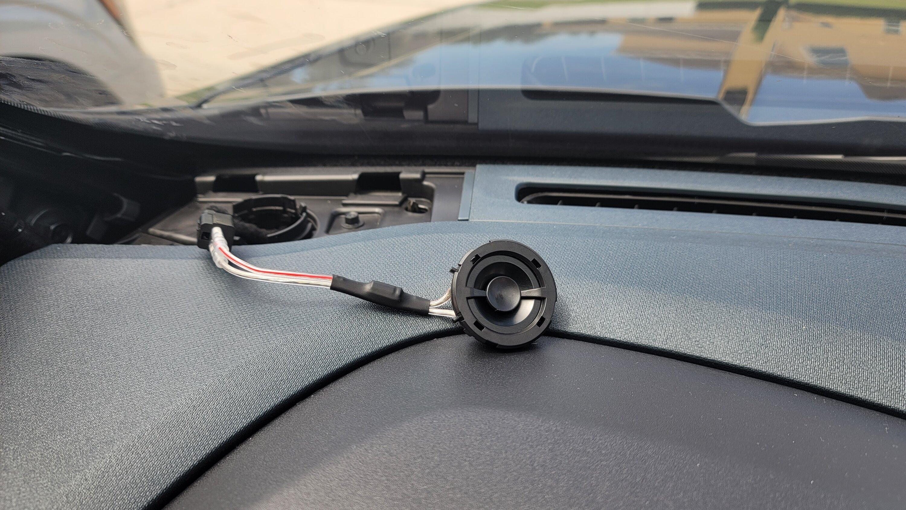

Topflite66
Fred
Dec 2, 2021
North Dakota
2023 Maverick

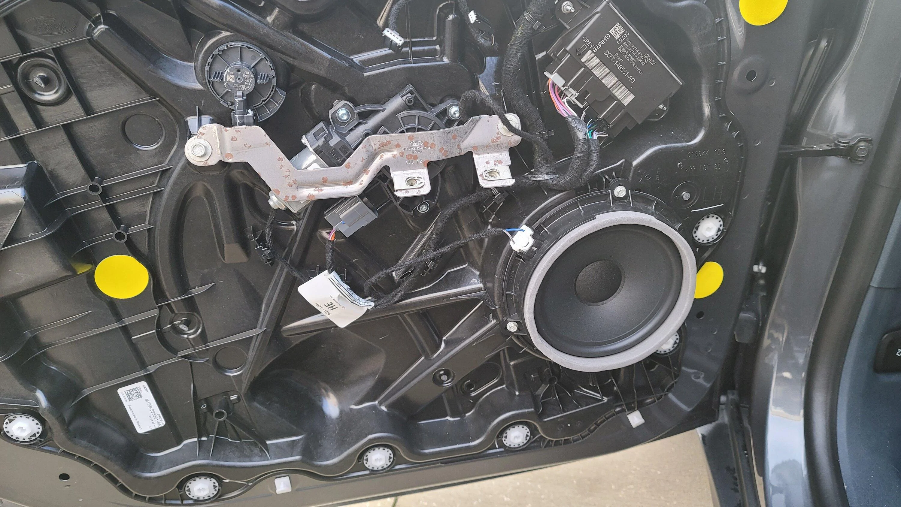

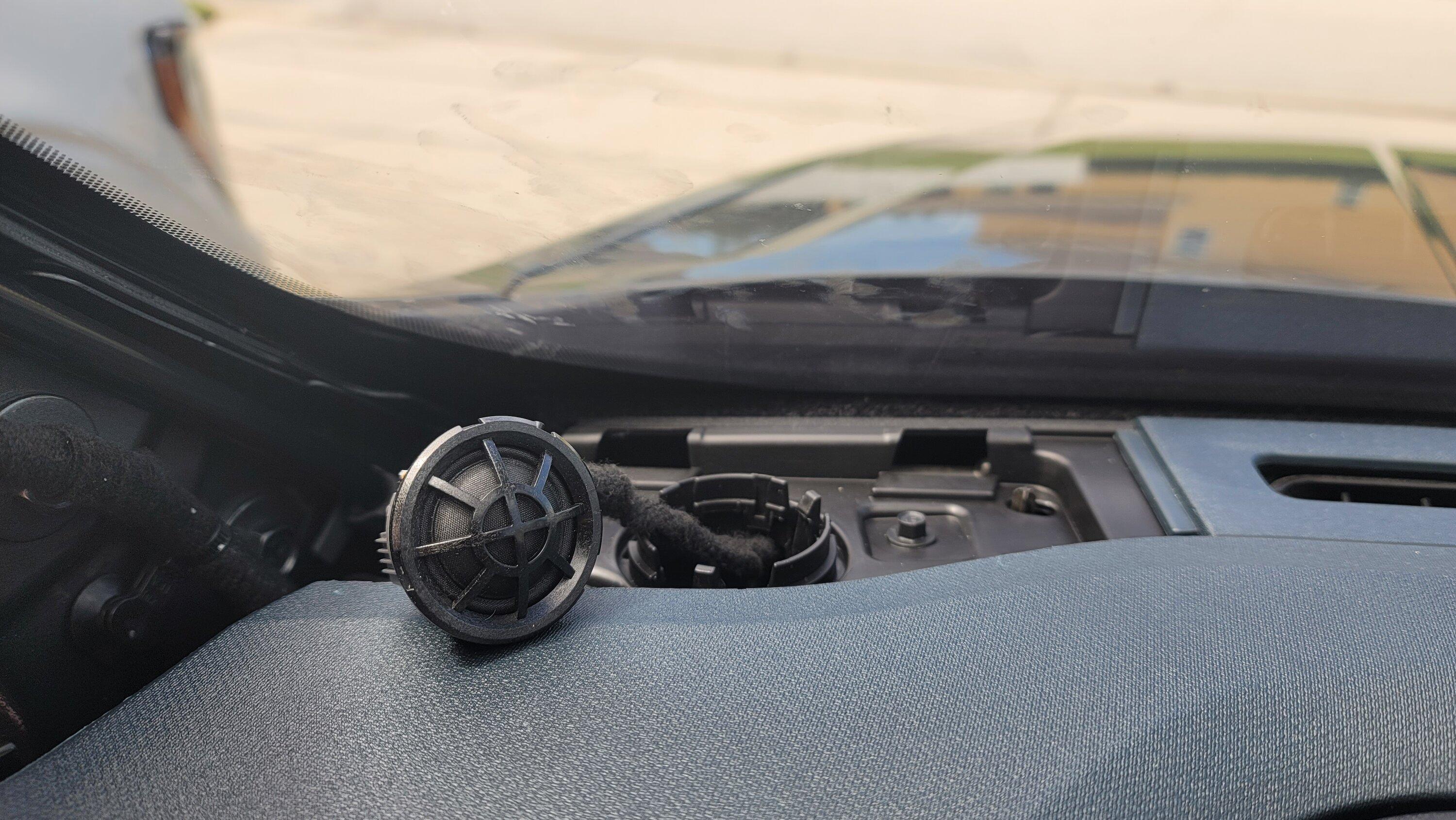

No need to wait for this. I have a Lariat Lux with the 8 speaker B&O and I just installed a set of speakers from Focal that I bought from Crutchfield. 6 1/2" for the doors and 1" tweeters for the dash. I also bought Morel 4" for the rear but haven't installed them yet.
Doors and dash were 100% PnP with NO wires cut or any other crazy stuff. It is considerable cleaner with nice bass response compared to the crap I pulled out. An external amp is planned as they still suffer from the necessity of additional power to truly make them "sing" but they are very musical. At the time I bought mine, a few days ago, the Maverick was not listed information wise as to what fits where. Even the bolt pattern was 100% and the tweeters snapped in exactly the same as the oem tweeters.... I went with these because I used the same system, but in a 6x9, for my 2021 F150 single cab with the same greatness and ease of install.
