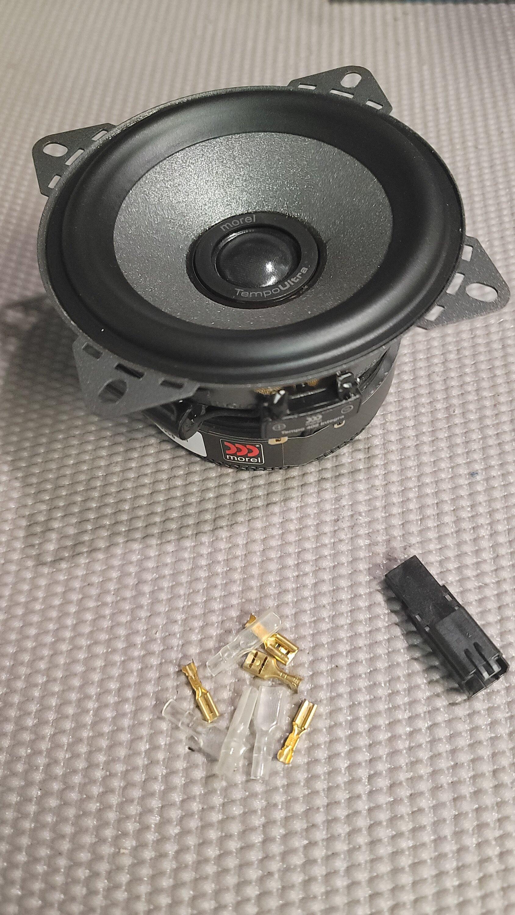

I also bought Morel 4" for the rear but haven't installed them yet.
An external amp is planned as they still suffer from the necessity of additional power to truly make them "sing" but they are very musical.
Will the Morel‘s be fully PnP as well?
Do you notice a big improvement with the stock B&O amp?
Do you get more volume, or just a richer sound?
Did you had any sound deadening to the doors?
Any plans for the center speaker?

With this upgrade, it will not be a dramatic increase in volume as the amplifier power is still the same. With this said, because of the high sensitivity there is a little increase in volume and alot more rich sound quality over stock. Morels will be PnP AFAIK. I sought them out specifically because of the inline cap on them as well. When I installed my Raptor 3rd brake light I had to drop the headliner....which required me to remove several panels..one of which where the rear speaker panels. Bolt pattern is the same...hole for magnet should be an issue.
The Morels only come with the speaker terminals so I will be making my own PnP adapters. Yes I plan to replace the center speaker. I also plan to upgrade the factory sub with a shallow JL Audio 10" with a 500 watt sub amp. Sound deadening was not added yet but it is planned for the absolute best in cabin sound reproduction and reduction of unwanted vibrations
