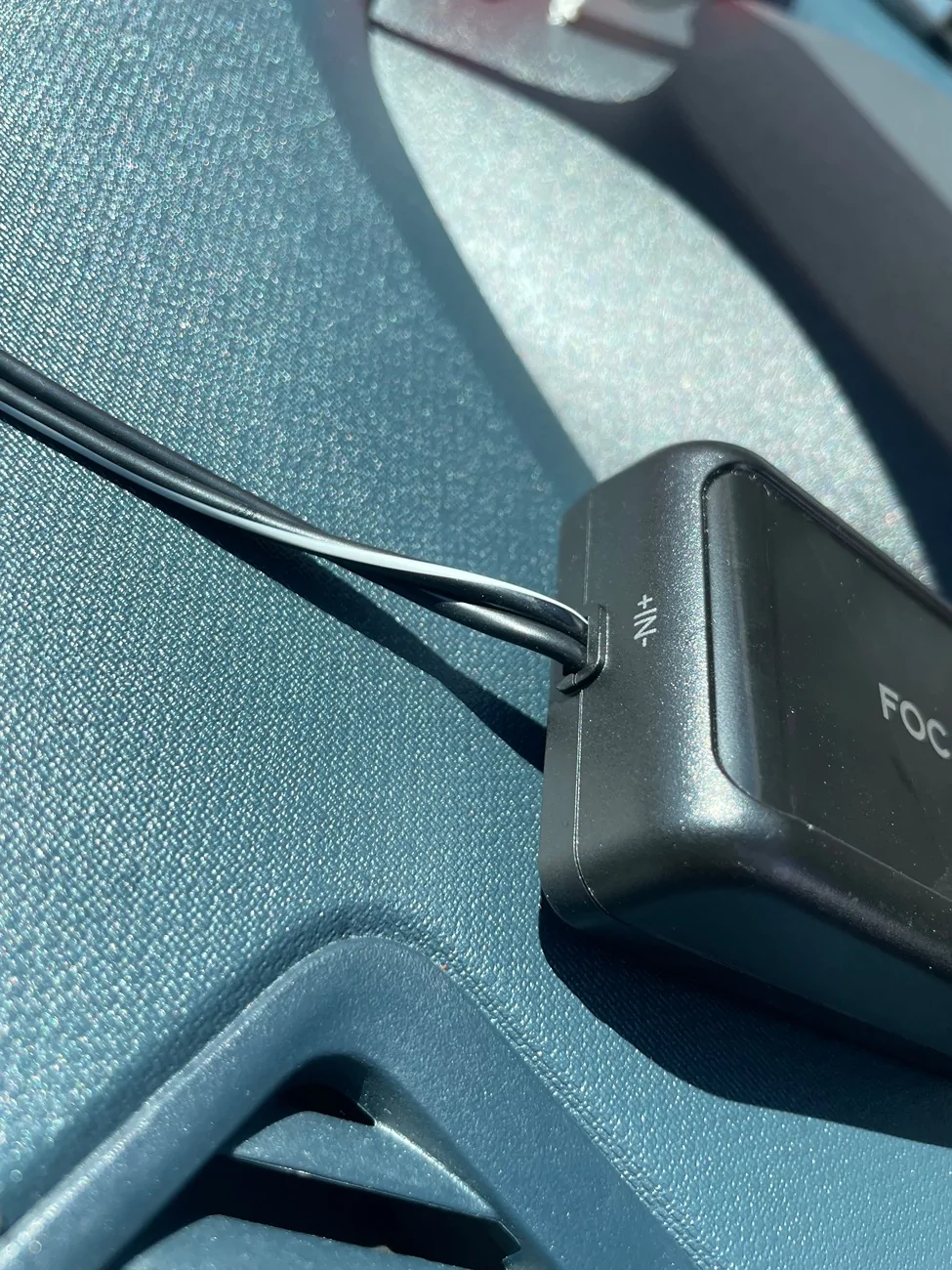

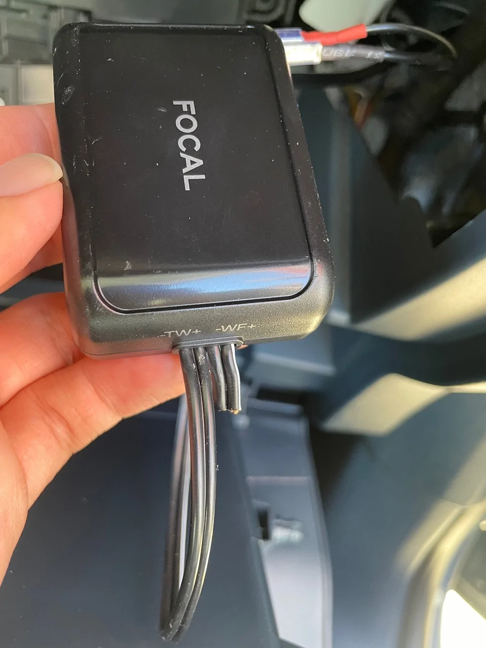

In order to correct the issue I will need to undo the tweeter connections and route them to the front door speakers instead, and then run new wire from the key 200.4 to the tweeter side of the crossovers, correct? If so what do I do with the factory tweeter wiring? Do i just cap it?
Do you know how the 200.4 is feeding the speakers up front? What should happen is that the 200.4 feeds into the crossover, and then the tweeter output goes to the tweeters, and the woofer output goes to the doors. Clearly it is not that way right now.
You could run new wire to the doors, but if the 200.4 is already feeding the doors somehow, I would just find that connection and undo/redo it. I would assume it is behind the HVAC controls, but who knows where they tapped in.
They did not leave you much wire to work with on the woofer output, and that sucks. Not to mention that if it was left like that, there was bare +VDC just waiting to short out and damage the crossover, or worse. At the very least you should get compensated for the cost of the crossovers, if not the whole damn "installation."
I would run new wire from the crossover output to the tweeters if it wasn't already done.

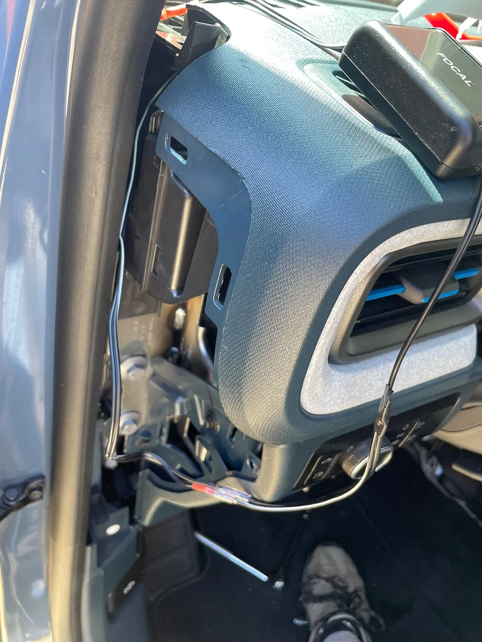

The key 200.4 is wired under the center console. Right under where the transmission rotary dial is. Looks like they cut into the wires coming off the harness. So the wires feed in then feed back out.
Yes, I have seen that the easiest way to route the wires is the way you described, but being that they already butchered it and hooked up the tweeters i think it would be easier to just run new wire to the door speaker wiring in the kick panels no? Then re-run the key 200.4 EQ function.
You can certainly do that if it's easier. I just figured the door wiring was already good as-is and you could make use of the hacked-up connections they'd already made in the console or dash. It probably makes a difference where the crossovers sit, and I wasn't clear on that.

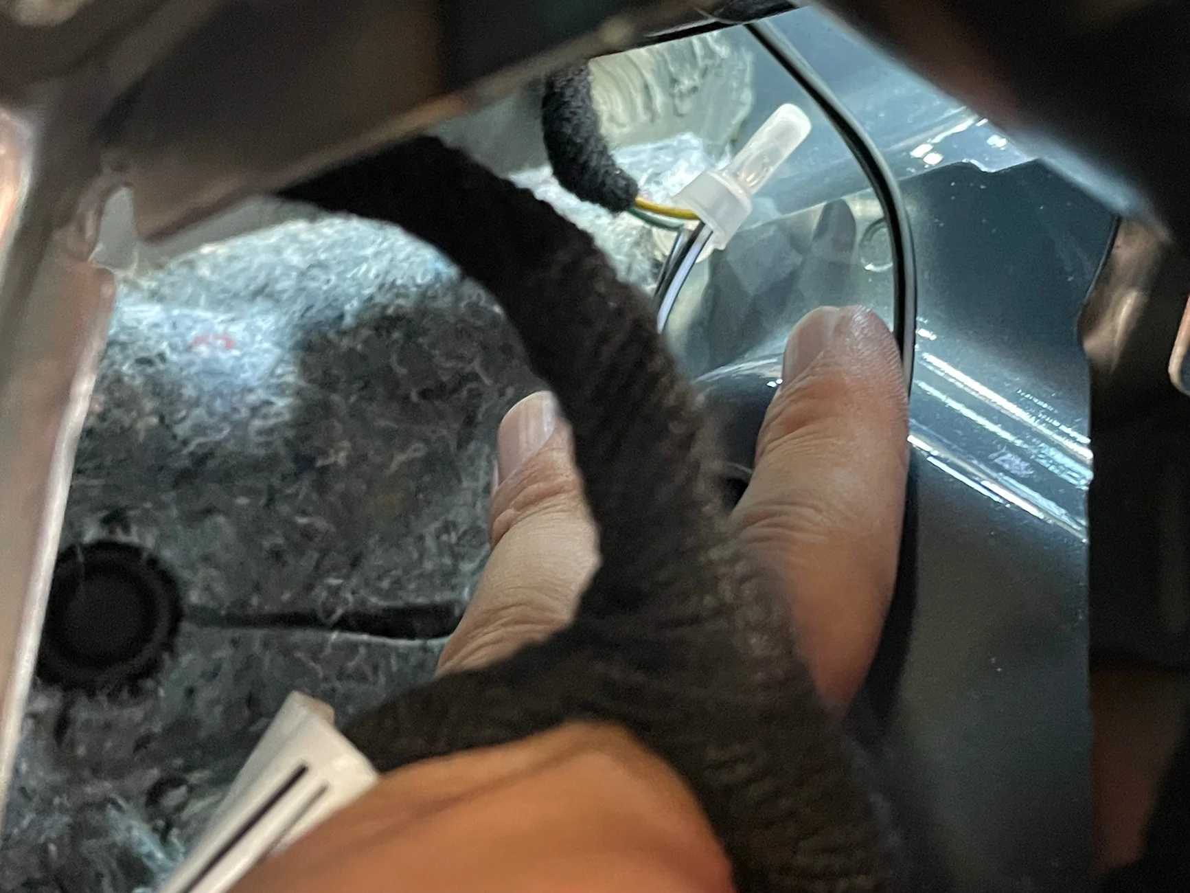

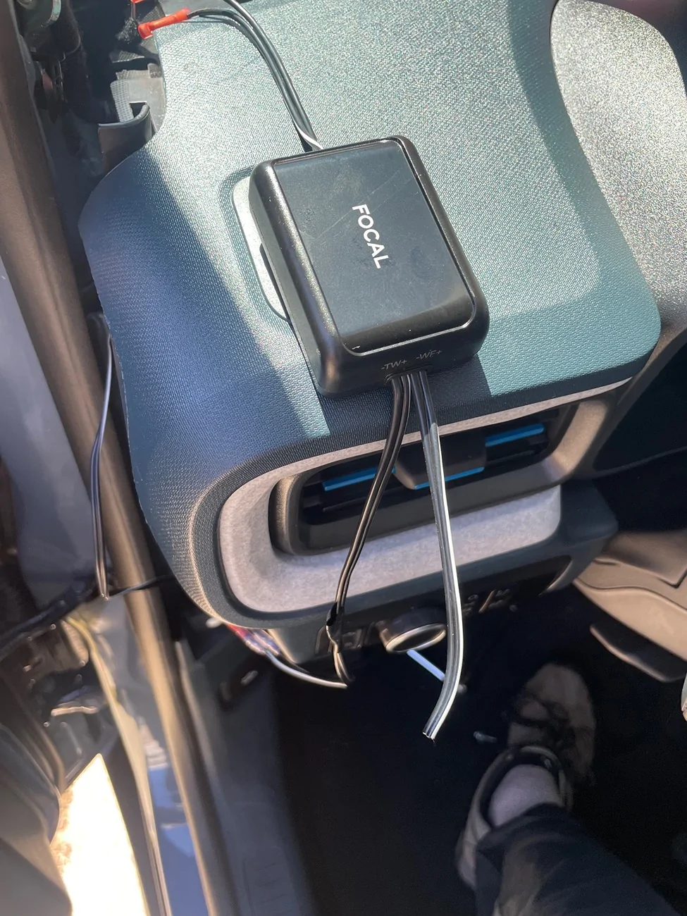

Gotcha. If I do what you describe then I’d be making 4 new connections (tweeters and door speakers) as opposed to just 2 (door speakers) since the door speakers are not currently connected to the crossovers. The crossover is tapped into the tweeter factory wiring under the dashboard, which just runs back to the Key where they cut into the harness wiring.
My thinking is that I can just splice the door speaker factory wiring near the kick panels before it reaches the rubber boot and Molex connector, solder in new wiring and run that up to the passive crossover.
