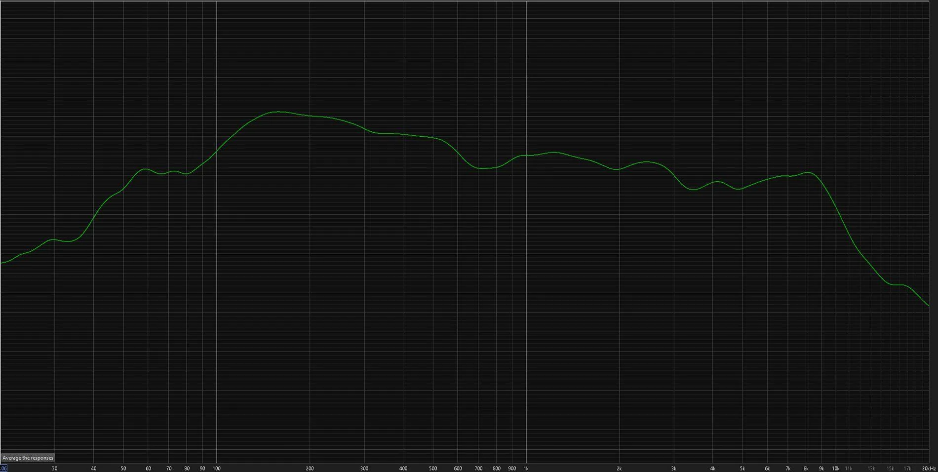

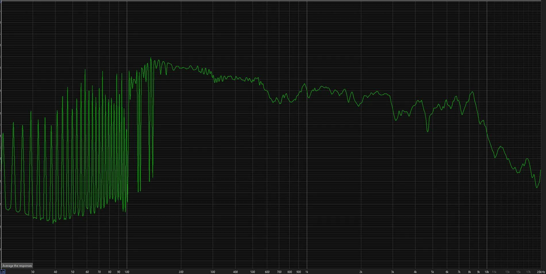

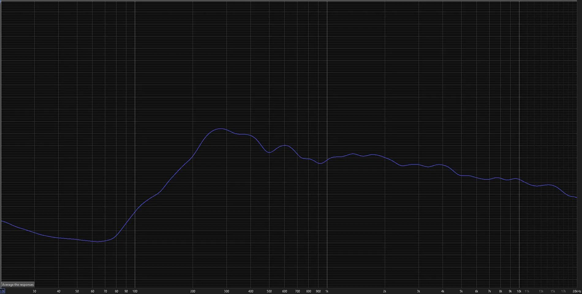

Overall I am surprised with the results, it is nothing to really boast about, but not half bad. There is a hump from 90Hz to 350Hz, if you take that out it is pretty flat from 60Hz to 3.5KHz with a little dip, then holds and rolls off gradually after 9KHz. Tweeters are off axis, this explains the high end roll off.

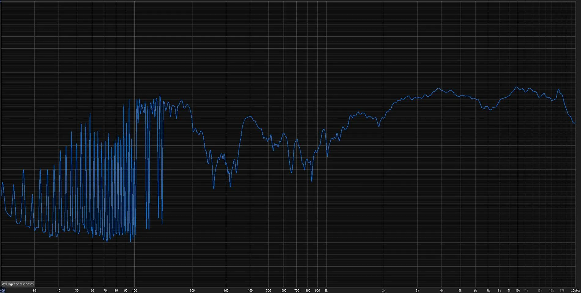

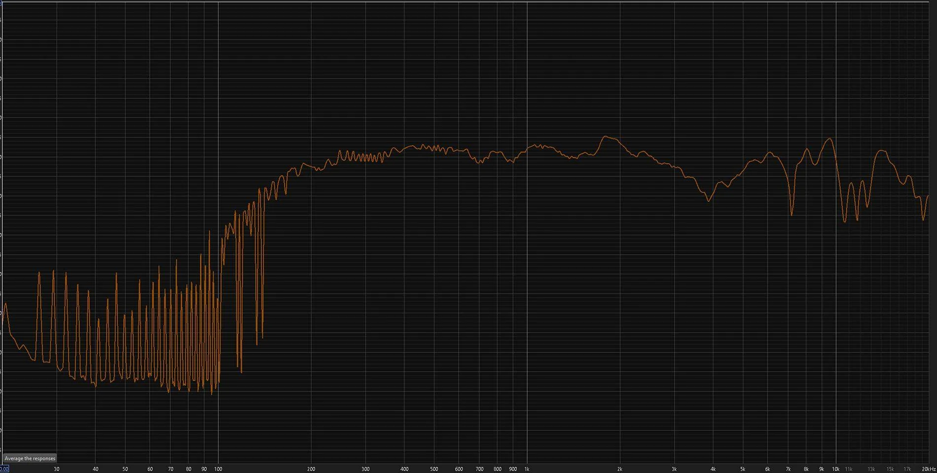

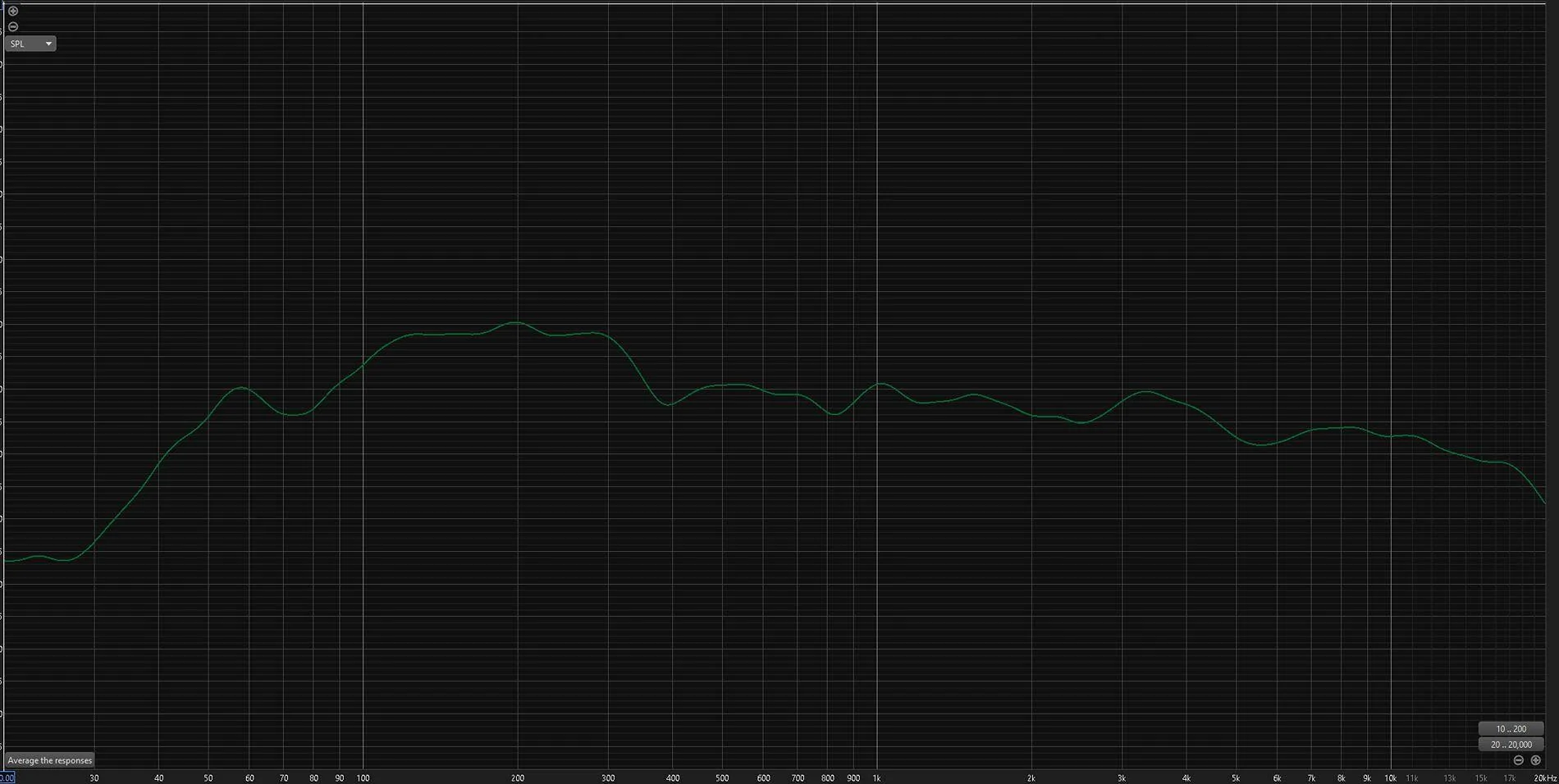

The near field measurements for the fronts are not accurate since I did not disconnect the other speaker when measuring.
I would assume the tweeter is actually rolling off around 2.5KHz and anything below that is from the door speaker.

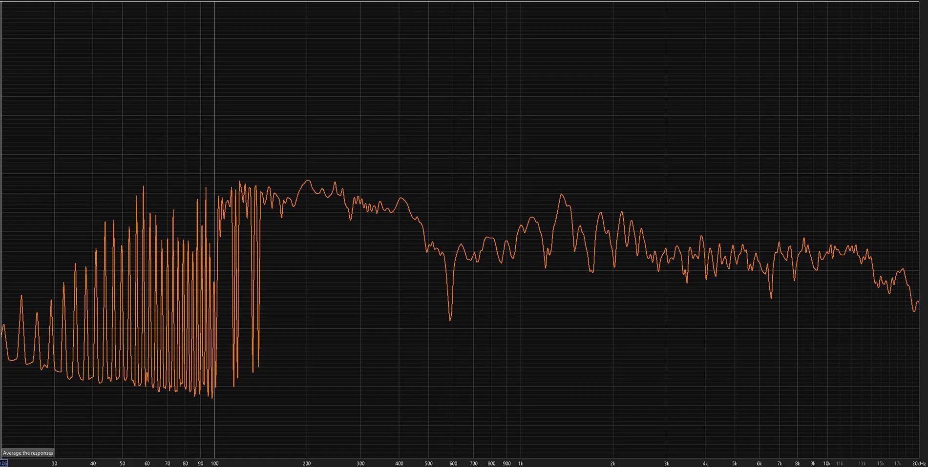

I doubt the 6.5" in the door is playing up to 8KHz, but this is on axis near field, it should start beaming around 2.2KHz, most of the higher frequencies do not reach your ear. If I had to guess, it is rolling off around 3KHz based on the measurements, but some off axis measurements might shed some light.

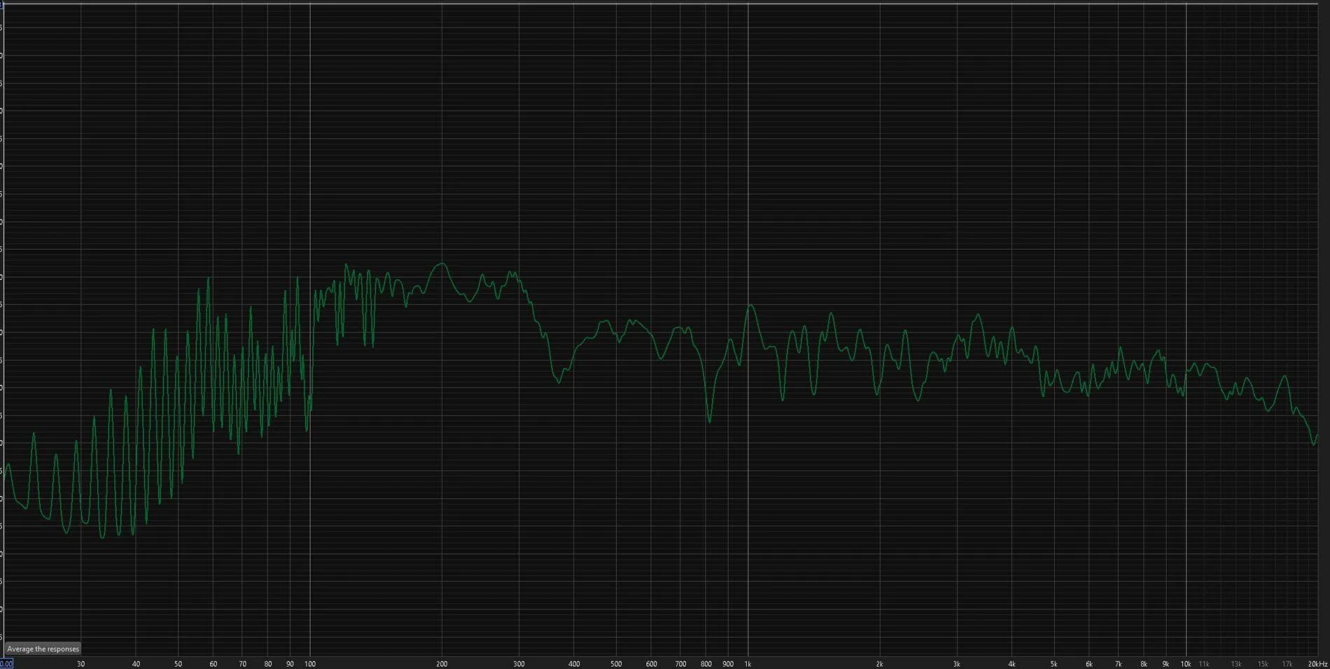

L + R All Speakers No Smoothing
Ford Maverick 2025 Non B&O Audio Measurements all_center_flat_ns
L + R All Speakers 1/3 Smoothing
Ford Maverick 2025 Non B&O Audio Measurements all_center_flat_13s
L + R Front No Smoothing
Ford Maverick 2025 Non B&O Audio Measurements Screenshot 2025-01-25 161343

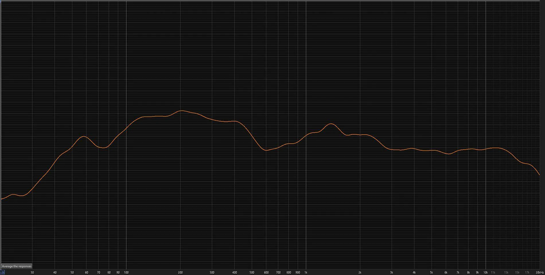

L + R Front 1/3 Smoothing
Ford Maverick 2025 Non B&O Audio Measurements Screenshot 2025-01-25 161549

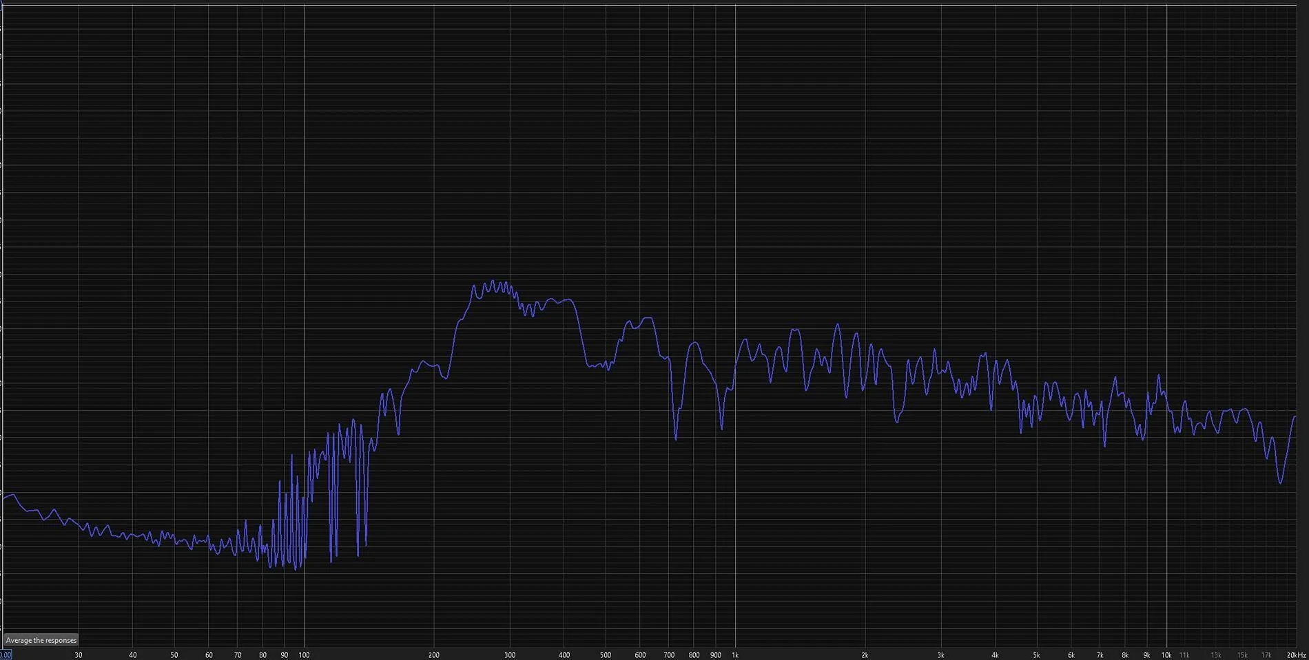

L + R Rear No Smoothing
Ford Maverick 2025 Non B&O Audio Measurements rear_flat_ns

L Front Door Near Field No Smoothing
Ford Maverick 2025 Non B&O Audio Measurements front_left_door_near_ns

I should retake these measurements, I was using the wrong sample rate, thus the fluctuations at the bottom end.
