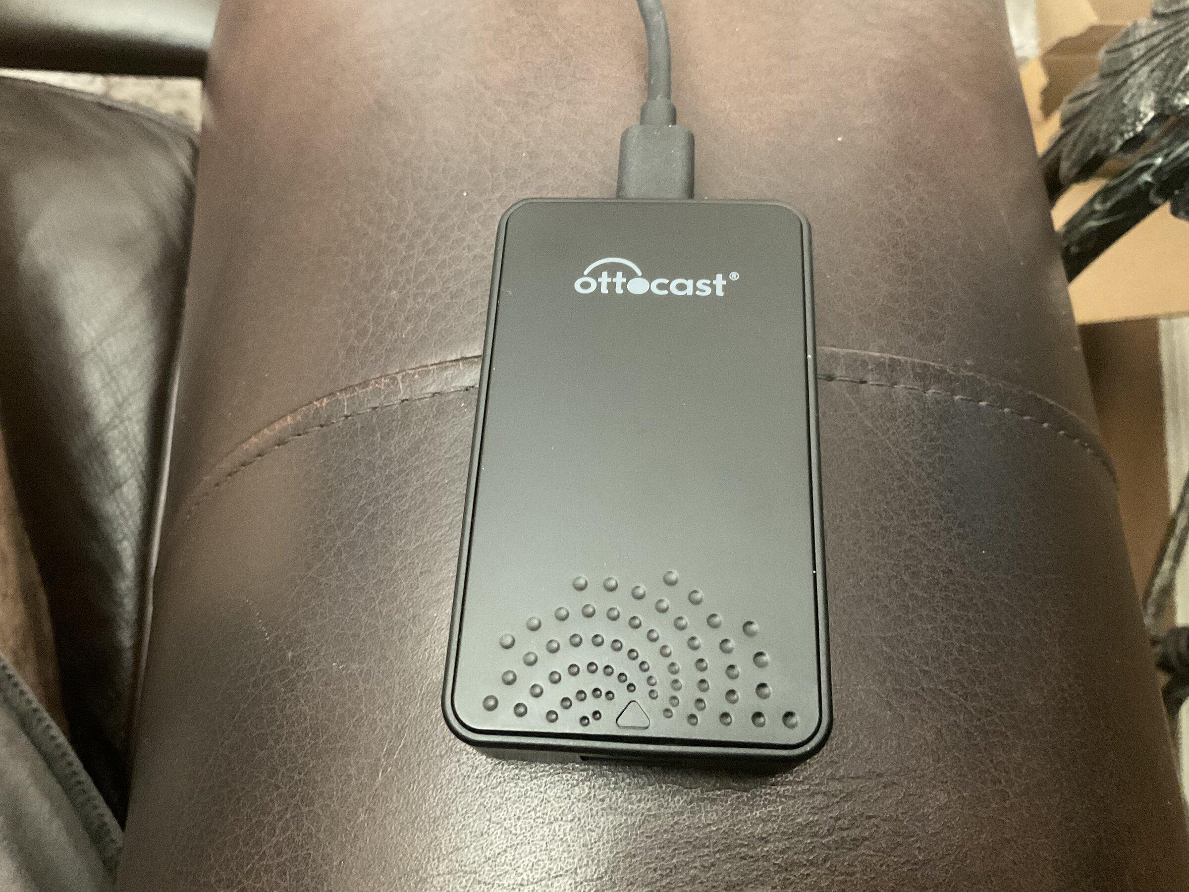

I got the cplay2air to work just fine on my xl but the Ottocast is a no go

Ottocast did not work on my maverick xl the unit work fantastic on everything other car I have it work with wifi so is Lightning fast but a no go on the maverick for now

Ottocast did not work on my maverick lx, the unit work fantastic on everything other car I have it work with wifi so is Lightning fast but a no go on the maverick for now
Wonder if it works on the Lariat Lux with sync 3? I’m not having a great experience with the carlinkit and willing to try other adapters.

The Ottocast has great reviews and I can tell you it works great on my other cars just not on the mav
That’s why I mentioned lariat lux. The sync 3 is a bit different than the head unit used on the xl and xlt. Others have mentioned the sync 3 in the lariat lux seems to be more compatible with these adapters.

I have an Ottocast coming. Will attempt on my Lariat Lux w/SYNC 3. Hope it works!
