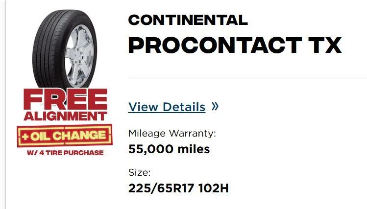

I have 33,000 miles on my 2022 Maverick XLT. The dealer told me I need tires. I checked with my tire gauge, and they are right. According to a tire website, they are warranted to 55,000. Considering I need new tires, wouldn't this void the warranty? Anyone else only get 33,000 miles or so from these tires?

Some members have suggested that the factory tires come with less tread depth than if you were to purchase the same tire aftermarket. I don't know if this is true but you are not the first person to replace factory tires with similar miles on them.
The chance of you getting them replaced under the warranty is not good. The dealer and Ford will just claim this is a standard wear and tear item and suggest you should drive less aggressively to preserve tread life.

They do come with 9/32 from the factory and a UTQG of 500, which is pretty low for a standard all-season tire.
Mileage warranties have always been a bit of a joke; to claim one you have to prove regular rotation with no alignment issues, and then you get a fractional discount on a new set unless it was an exceptional circumstance, in which case the tire shop that sold them is more more likely to help you out than the manufacturer.
Warranty is Pro Rata, also requires purchase of replacement comparable Continental / General tire brand. Tread requirement is 2/32 or less.

Look at the warranty information for any tire company
They DO NOT warranty ANY OEM tire options
That is just the way it is
These tires were utterly dogshit from day one, I only kept them on because I don't like wasting money.
After 30k KILOMETERS they were worn down beyond being able to sell, and from day one the hydroplaning and slipping on wet grass was horrendous.
Since got Firestone Destination AT2s and have not looked back.
Even the OEM KO3s that come on the Ranger Raptor are quite different from actual KO3s, and BFG is same deal, no tread warranty on OEM tires, and their architecture is so slightly different. Few vids on youtube about it.
As far as I know, this is all tires, all vehicles.
I have yet to read the fine print of ANY tread warranty that DOES NOT exclude OEM tires.
