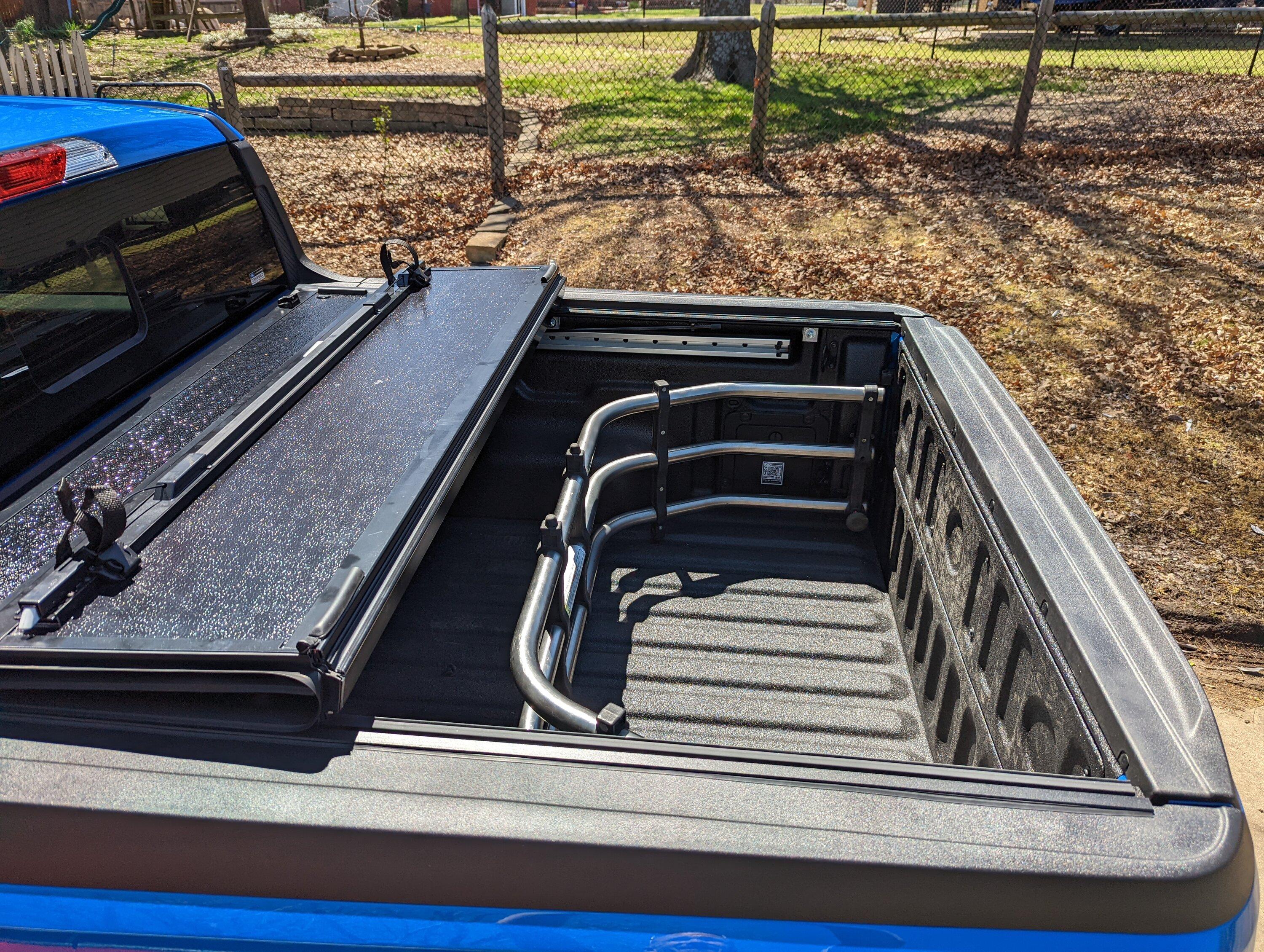

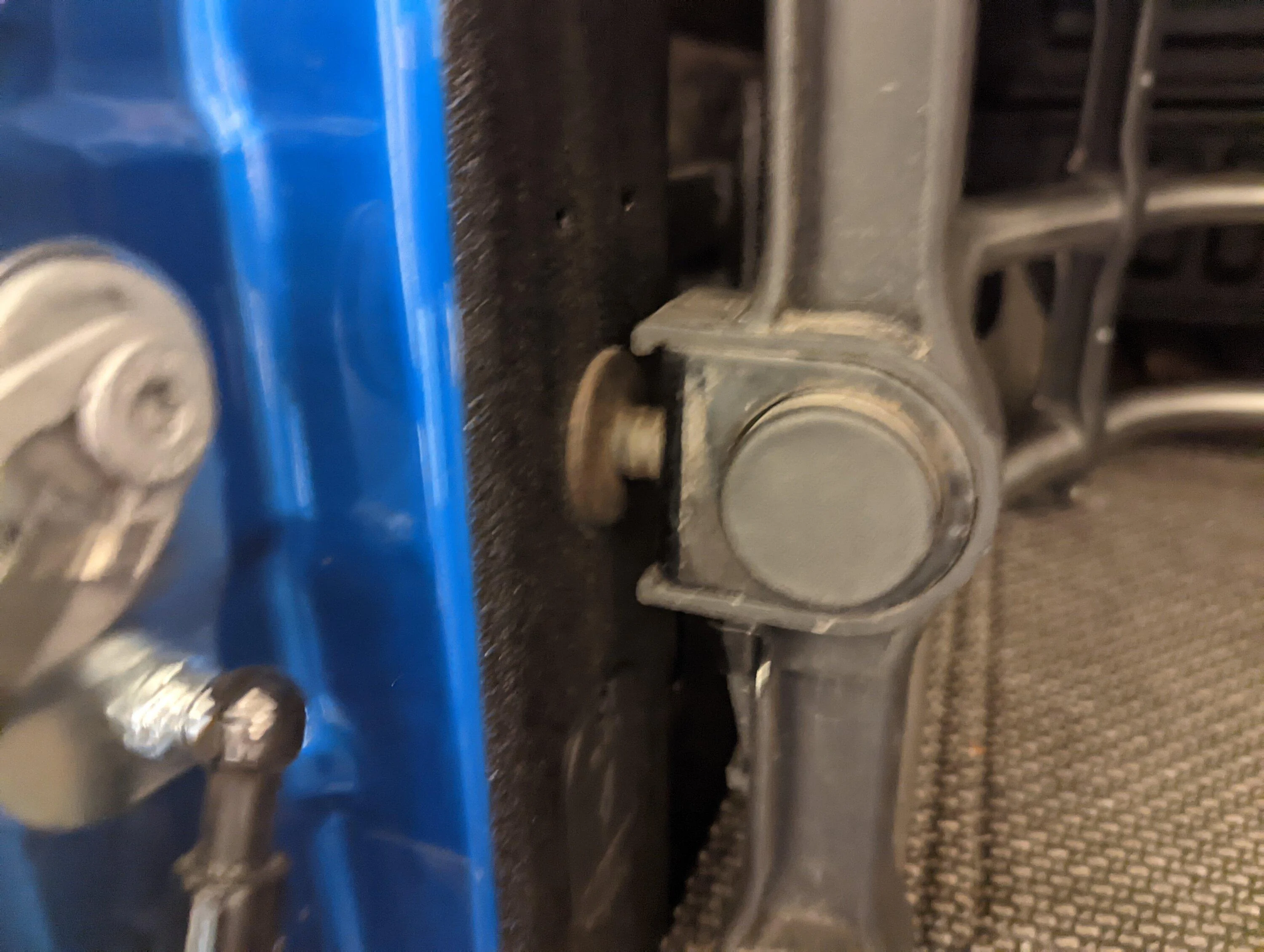

I found one recently for my 2005 Sport Trac at a salvage for $13.
It is 48" wide at the mounting clips, so it should fit the Maverick great. I will just have to tap holes for the striker bolts that it mounts to, or just put a washer/Lock nut on the other side.

The Ford bed extender bolts seem universal.
You'll have to tap a thread or put a nut on the other side as the hole(bottom one) on the Maverick is smaller.

Does anyone who if this bed extender (the one from the youtube video) would work with the hard roll up cover? One of the amazon reviews says it will not. Looking for confirmation.
