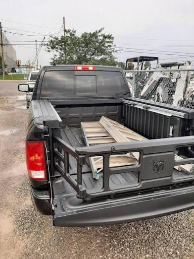

I've had my Maverick just a week now. I'm enjoying it, but I'm looking for a more versatile bed extender than the ford or amazon options. My biggest issue with them is when you need the whole bed, where does the extender go? It's big and oddly shaped.
I also have a Ram 3500 with the rambox option. The extender is ingenious in that its also able to be divider anywhere along the bed, due to the flat walls and no exposed wheel wells. That wouldn't work in the maverick, but the more important things are that is very rectangular, not missing much area on the tailgate, and it folds flat. If you find yourself needing the whole bed, like from a random purchase- I do that a lot- the extender folds flat and can store easily in the bed or in the back seat without taking a ton of space. I want to have the extender available in the truck all the time, but not in my way if I need the full bed.
Ford has a stowable F150 extender. That would work, but the design isn't easily adapted to the maverick. I've already determined a way to use the ram extender in the maverick, but it means mounting hardware that would intrude on the 48" width and prevent carrying sheet goods.
My latest thought is to install 3-4 rivnuts in each side of the bed . Then use knob screws to quickly attach and remove mounting plates for my ram extender.
Sorry for the long post, has anyone found a better bed extender that breaks down or folds for storage? Here are a couple pics of the ram extender

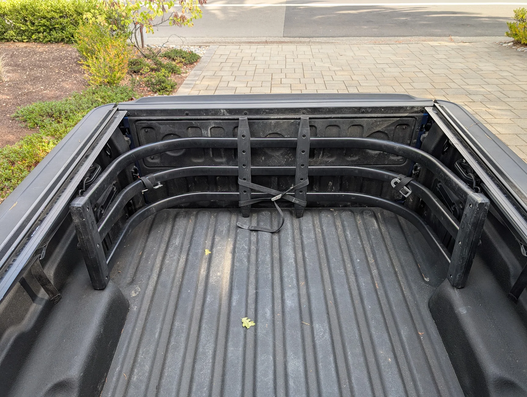

I bought this bed extender on Amazon: https://www.amazon.com/dp/B093GWYGH5?ref_=ppx_hzsearch_conn_dt_b_fed_asin_title_2
It is a little more squared-off than the OEM one. The one time that I needed to have the tailgate closed with the bed extender in the bed but not rotated to the middle, I just removed it from the side brackets and nestled it against the inside of the tailgate.
That one looks nice for that style, I'm just looking for one that stows away better. The f150 extender breaks down and folds up. The ram extender folds up flat

Straight from my dealer to my house and that oh so useless $350 came with my Maveruck bed extender went right in the basement.
It’s never moved.
I’ve got straps.
