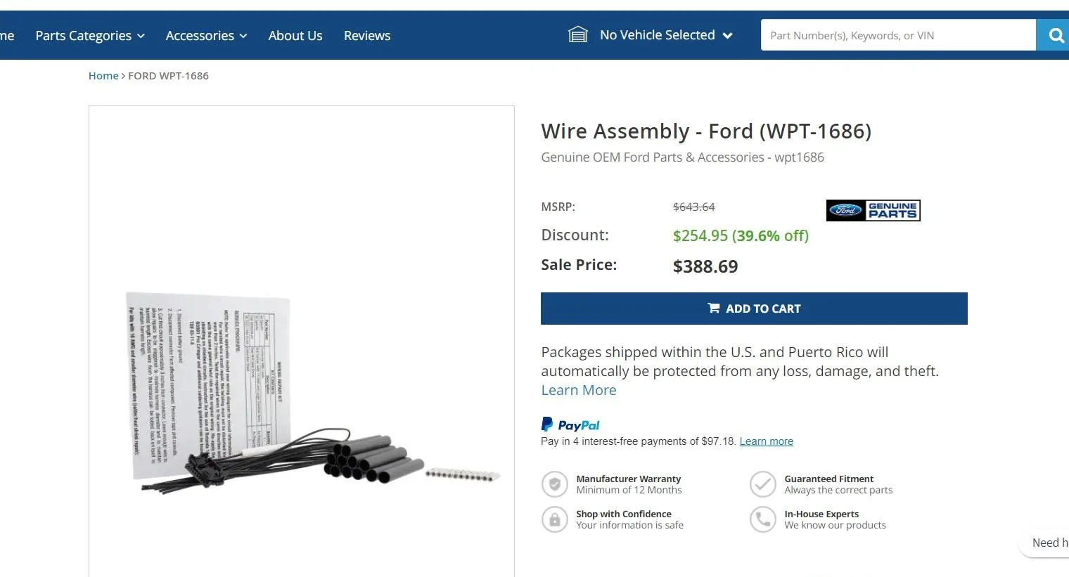

I just found the price for this wiring component from Ford. WPT-1686. It consists of the $.93 plug and 8 lengths of wire and some shrink-wrap. This end of the plug is pretty easy to make with a smallpair of needlenose pliers, a paperclip, thumbnails and a soldering pencil. It's the socket end that is a bit more difficult. Ford is worse than the drug manufacturers!

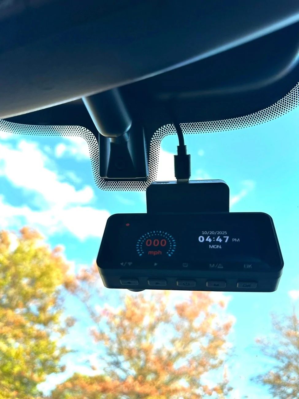

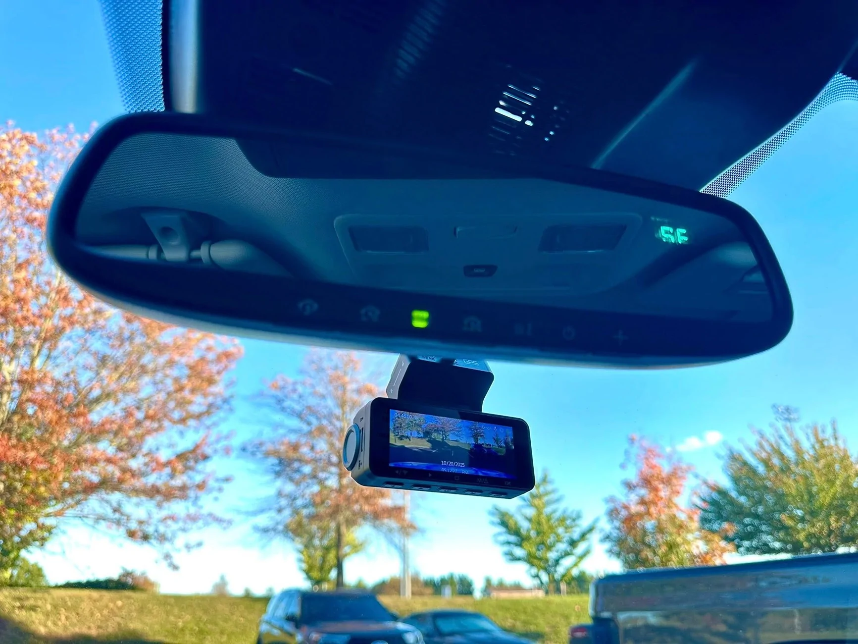

Done!
New Mirror from ebay. Did my circles in a parking lot to calibrate the compass. I'm sure the people that were in the parking lot with me were wondering what I was doing.
The mirror model is D9062-ADU00
Bought the harness from a seller on Etsy (YTBCUSTOMS). They also have a store on ebay. I think he is on this forum. I got the harness with USB-c connection for the dashcam. Harness is very well done. Great quality. Everything works perfectly
I used my dremel to cut two perfect half circles in the plastic cover for the two wires from the mirror and dashcam.
