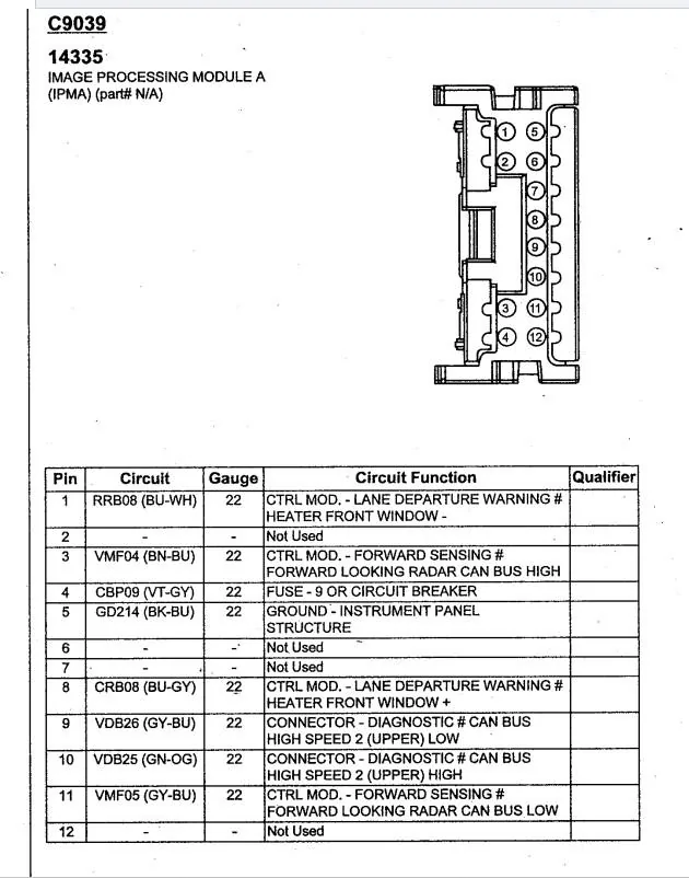

I've been using a patch cord in the Camera module. No problems for nearly a year now. Skyhawk made the original cord, and I'm going to do the same for my wife's 2024. Here is the connector pinout. Pins 4 and 5 run both a dashcam and the mirror. Parts are about $15 shipped from Mouser.
Ford Maverick Cheap auto-dimming, homelink mirror Camera connector P532

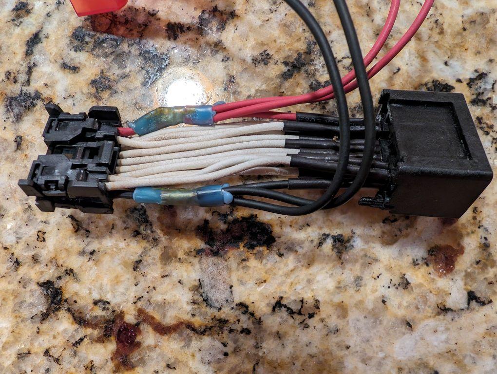

I decided to do the same with the harness that goes to the camera. Just finished making my own harness, going to add the connectors for the Gentex mirror and my dashcam and it will be ready to install. I did test it and it seems to work exactly as it should - on and off with accessory power, it does not stay on for 15 minutes or whatever after shutting down.

I should also add that @Mabcim gave me the inspiration with his write-up and helped getting mine finished. Credit where credit is due. I would also be happy to help anyone else with theirs if they want to try as well.
