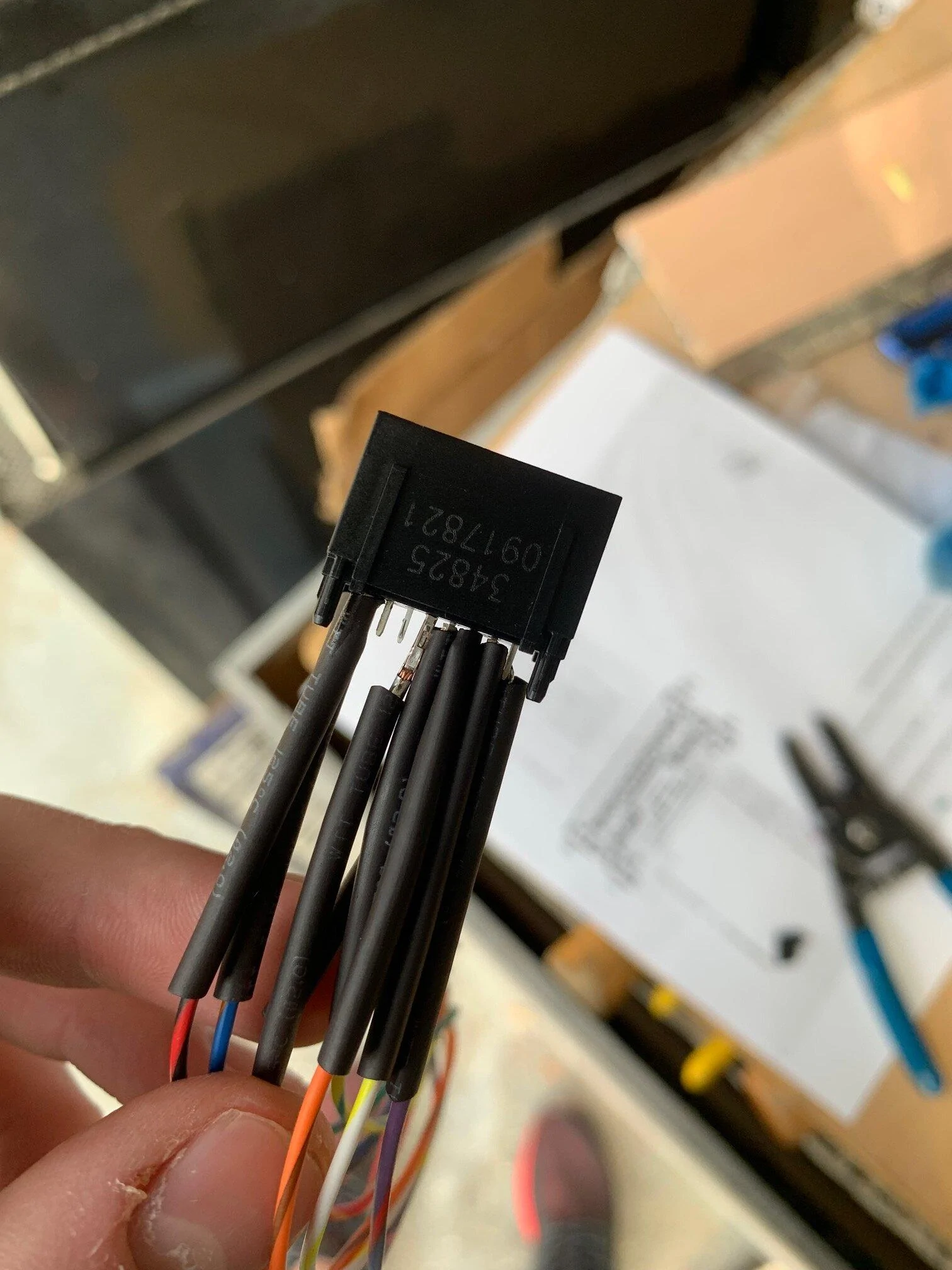

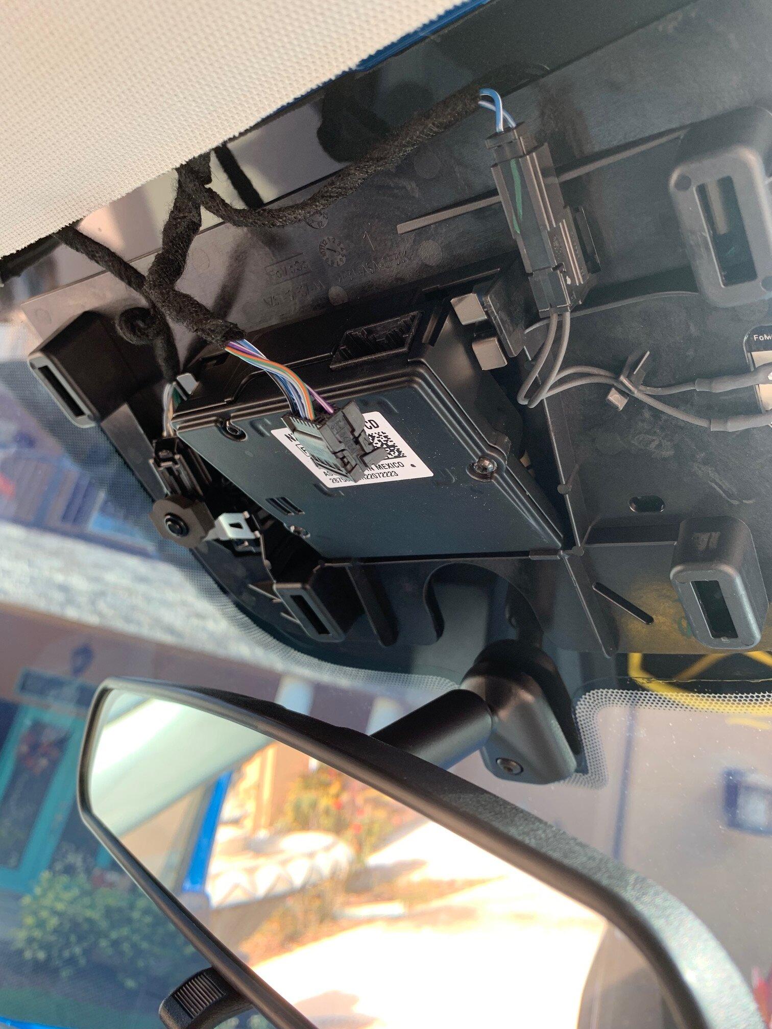

So I installed mine today using @Mabcim's method, and even though it took much longer and cost more, it is defenitlely the correct way to do this, working with sensitive electronics (the camera module). Huge thanks to him for finding the proper conncetors to make this happen. It took me about 3 hours as I went very slow and tested everything multiple times. The mirror cost me about $20 and the supporting connectors, pins (I got 20, but I recommend ordering 30 as you will mess up a few), and wires were about $30
Ford Maverick Cheap auto-dimming, homelink mirror IMG_9037
Only had to drop the black covering over the camera module, you don't need to drop the sunglasss holder
Ford Maverick Cheap auto-dimming, homelink mirror IMG_9038
Ford Maverick Cheap auto-dimming, homelink mirror IMG_9039

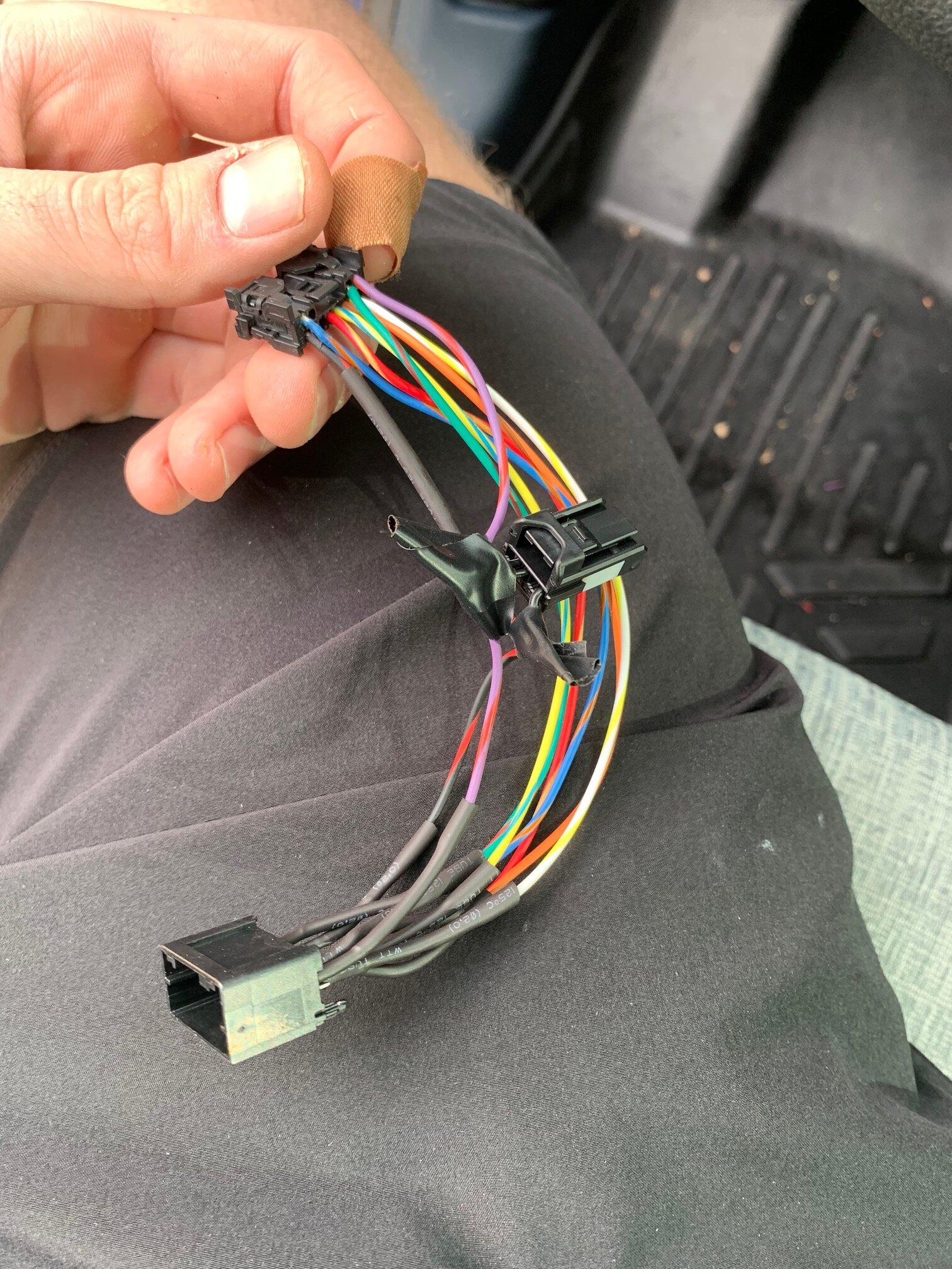

@Mabcim had soldered bare wire to the pins on the back of the female connector, they were incredible small so I instead attached pins to fit onto the pins, and they fit. Then covered with heatshrink
Ford Maverick Cheap auto-dimming, homelink mirror IMG_9040

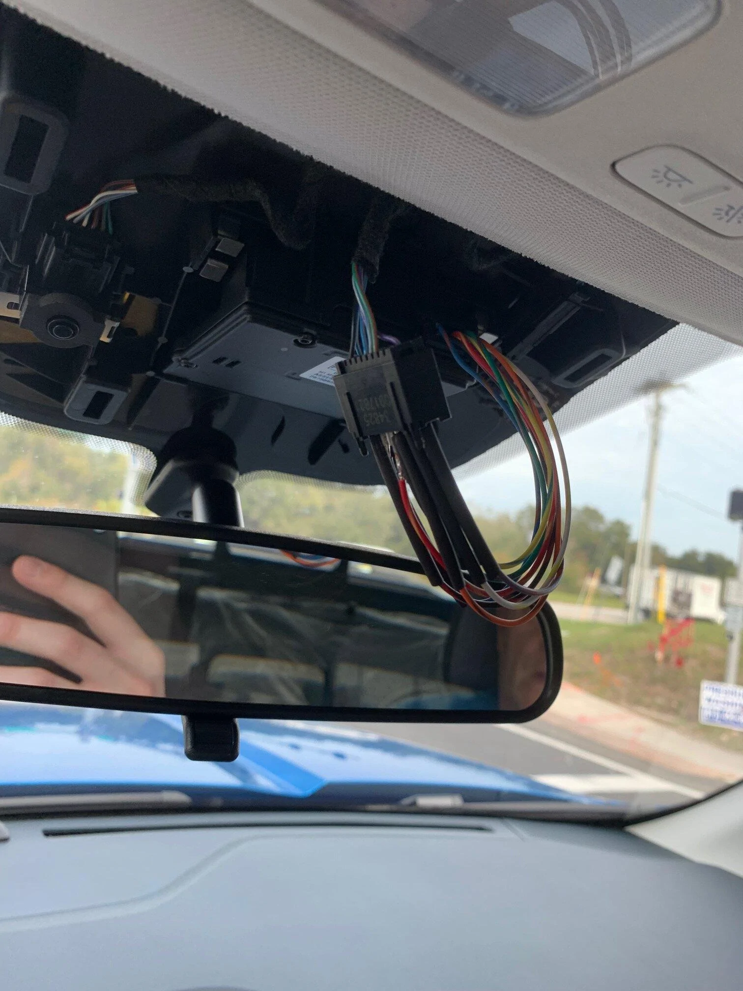

Mirror connector harness soldered to the ground and 12v acc on wire
Ford Maverick Cheap auto-dimming, homelink mirror IMG_9041
Tucked all the wiring up into the headliner

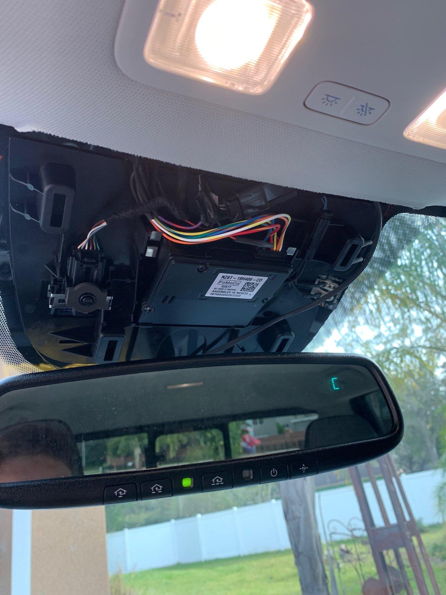

Got mine installed today. As my luck has it, nothing ever goes as planned. I decided to run the wires through the headliner and side pillar to the fuse box under the passenger footwell. That was the easy part, just use a trim removal tool and pull back on the headliner and stuff the wires.
Of course the wires on my mirror were about 8 inches too short to reach the fuse box, so I had to go buy some wire. Then I realized that I had the wrong fuse taps. We need "Micro 2" fuse taps.
Got everything wired up and tapped into fuse 3, which is what everyone recommends. I turn on the truck and get an error message regarding the front camera fault and collision assist is disabled.
I took out the fuse tap and stuck the regular fuse back in, and the error went away. I then tapped into fuse 6, which is also recommended on here, and it works, the only issue is the fuse tap is too bulky so It kind of has to be jammed in there. Oh well, it works.
Drove it around to calibrate the compass and then I programmed the garage door with no issues.
All in all, not too bad, just more troubleshooting than I planned, took about 3 hours to do everything
