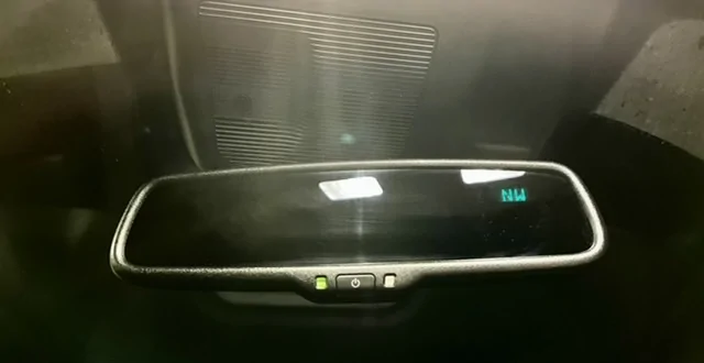

Got mine installed just now. I'm using the Gentex 1124. Gentex black wire to Maverick dome light black wire, Gentex green wire (Homelink) to Maverick dome light yellow/green wire, and Gentex pink/gray wire (compass/auto dim) to Maverick sunroof purple wire. Homelink works with the ignition off as I wanted, and the compass shuts off before the dome lights do after getting out of the truck and closing the door. I'm happy I went this route instead of using the purple wire on the dome light plug.

Got mine installed. I tapped the yellow constant wire and ground wire. As noted by several above, tapping the purple wire is not a good choice and can cause issues as it is not a 12V constant.
My truck cuts power to the mirror relatively quickly after shut down. I know some were thinking 90 minutes or so, but it’s no where close to that. Maybe 10-15? My only theory on that is that the same way the truck can detect you’ve left a map light on and shut it off, it can also detect the mirror draw and shut it off.
Happy with this mirror. No use for homelink and prefer this cleaner design.
