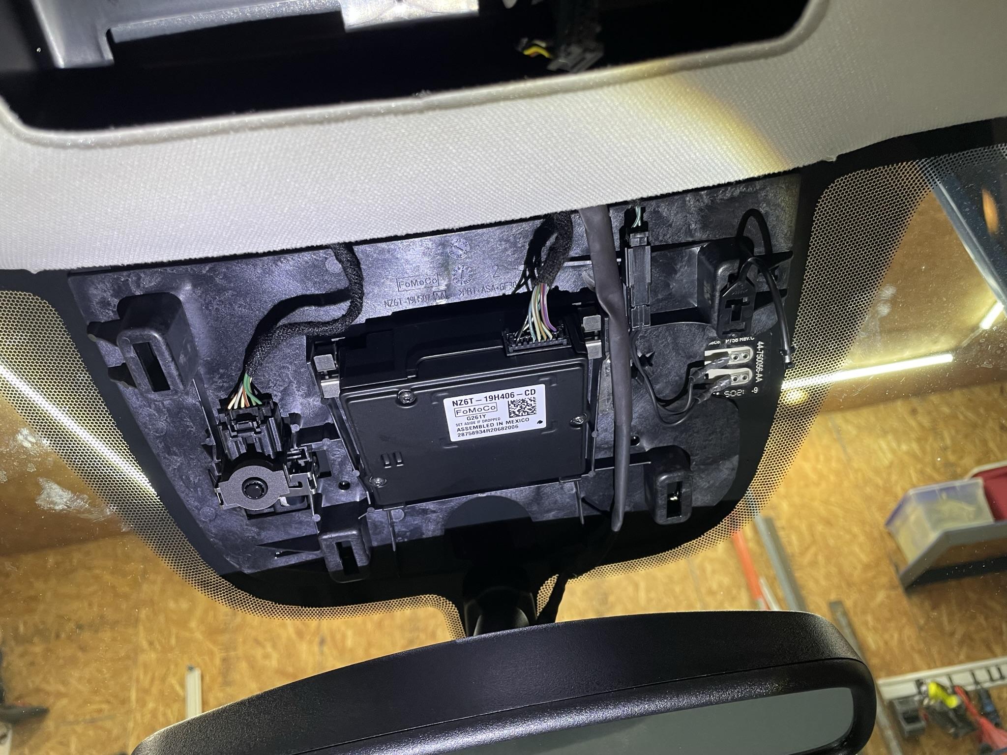

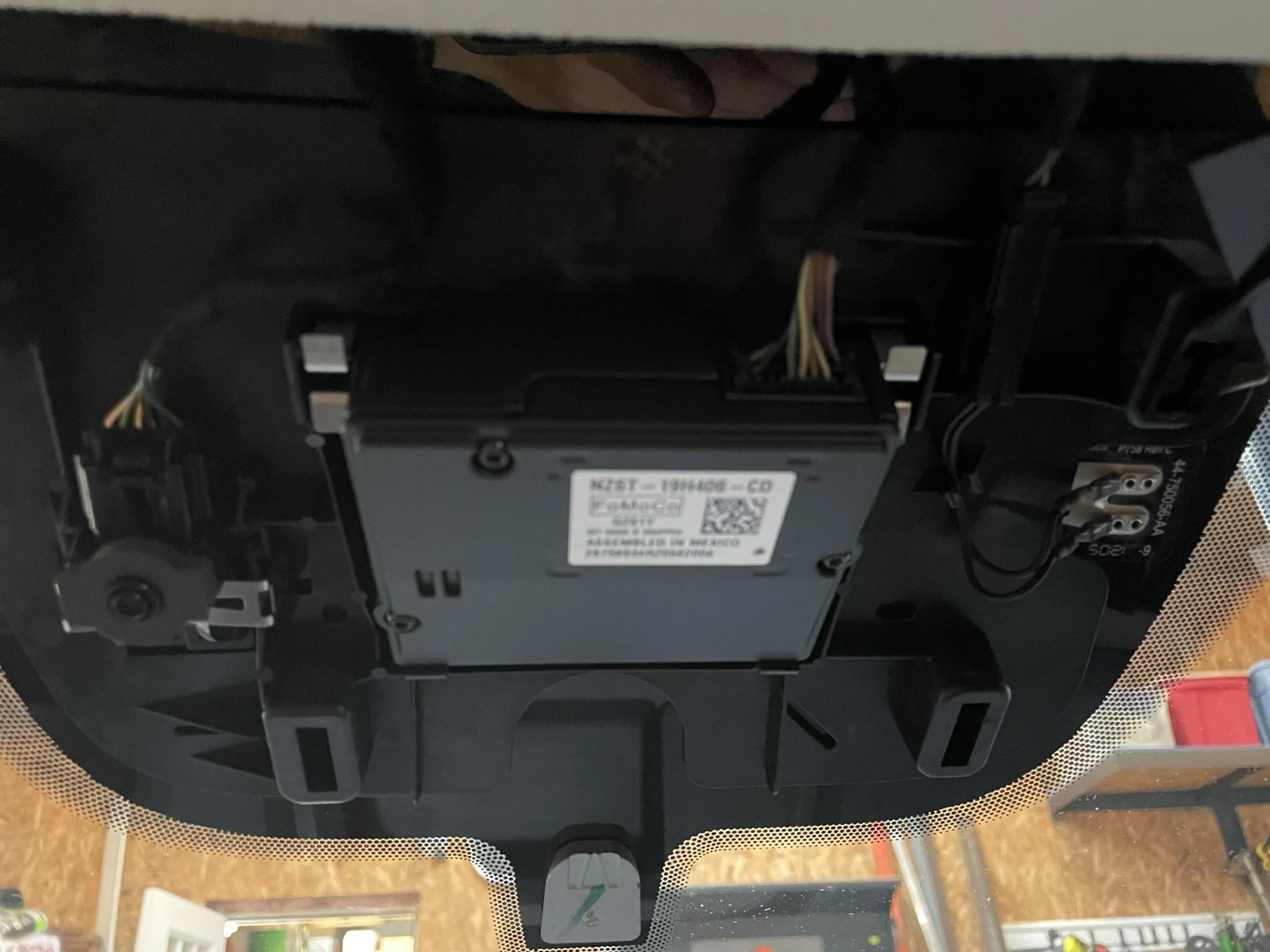

Most likely, my error in not keeping up with the thread. I'm curious about your mirror 'tests'. You mention testing auto cruise, lane assist and lane centering. I'm not sure how these features are related to installing a new mirror.
I created a ‘jumper’ cable/wire. I unplugged connector from camera and plug that into my cable. Then plug the other end of my cable into the camera. I then came off my wire with what is needed for the mirror. Thus no splicing or tapping the factory wiring. So I needed to make sure all the camera stuff worked after inserting my cable.

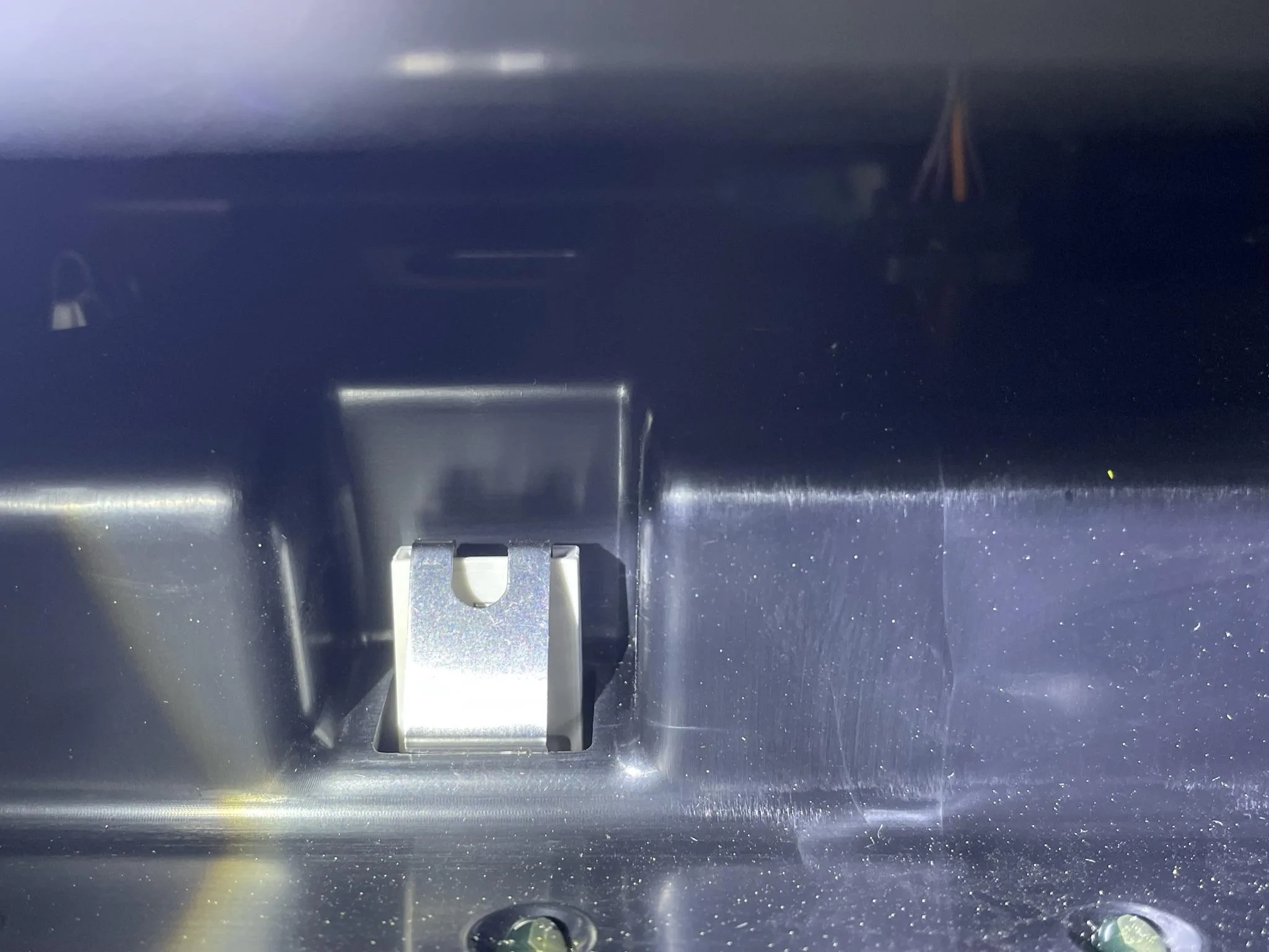

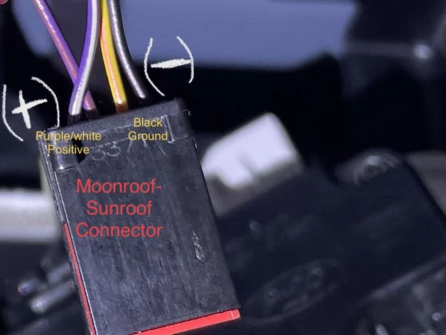

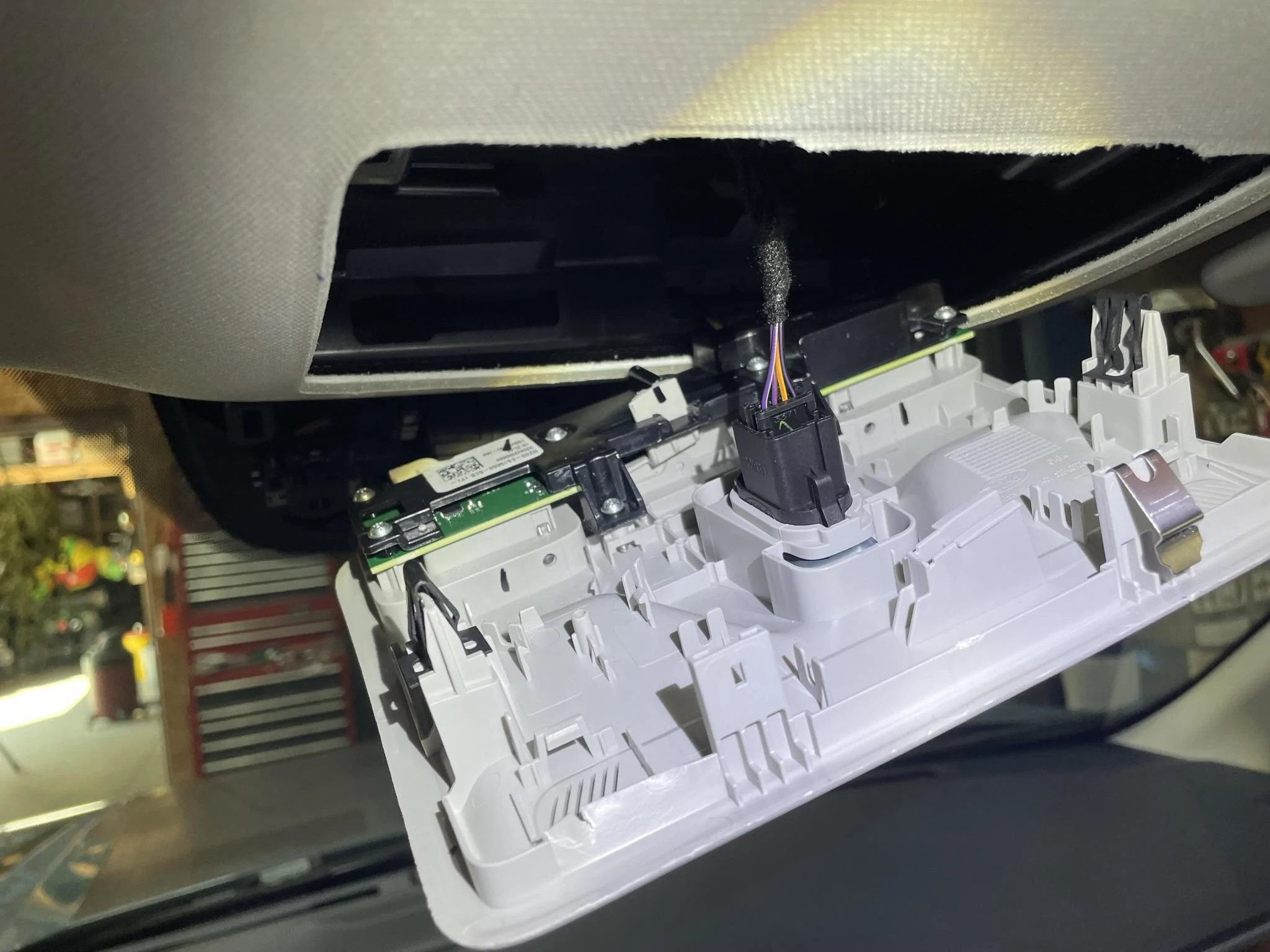

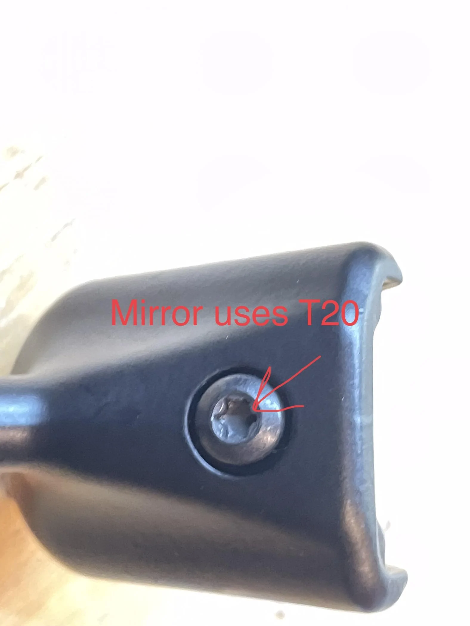

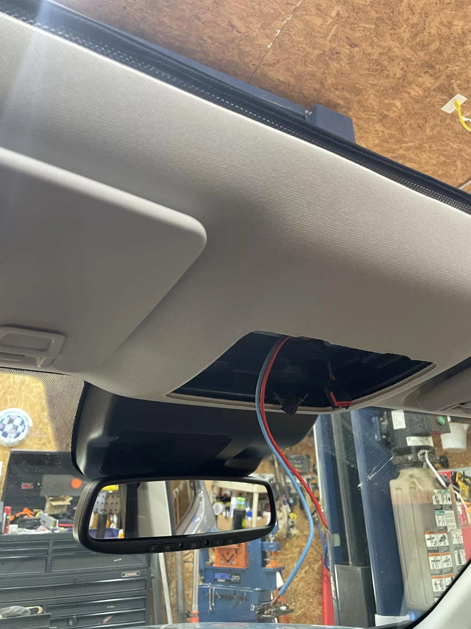

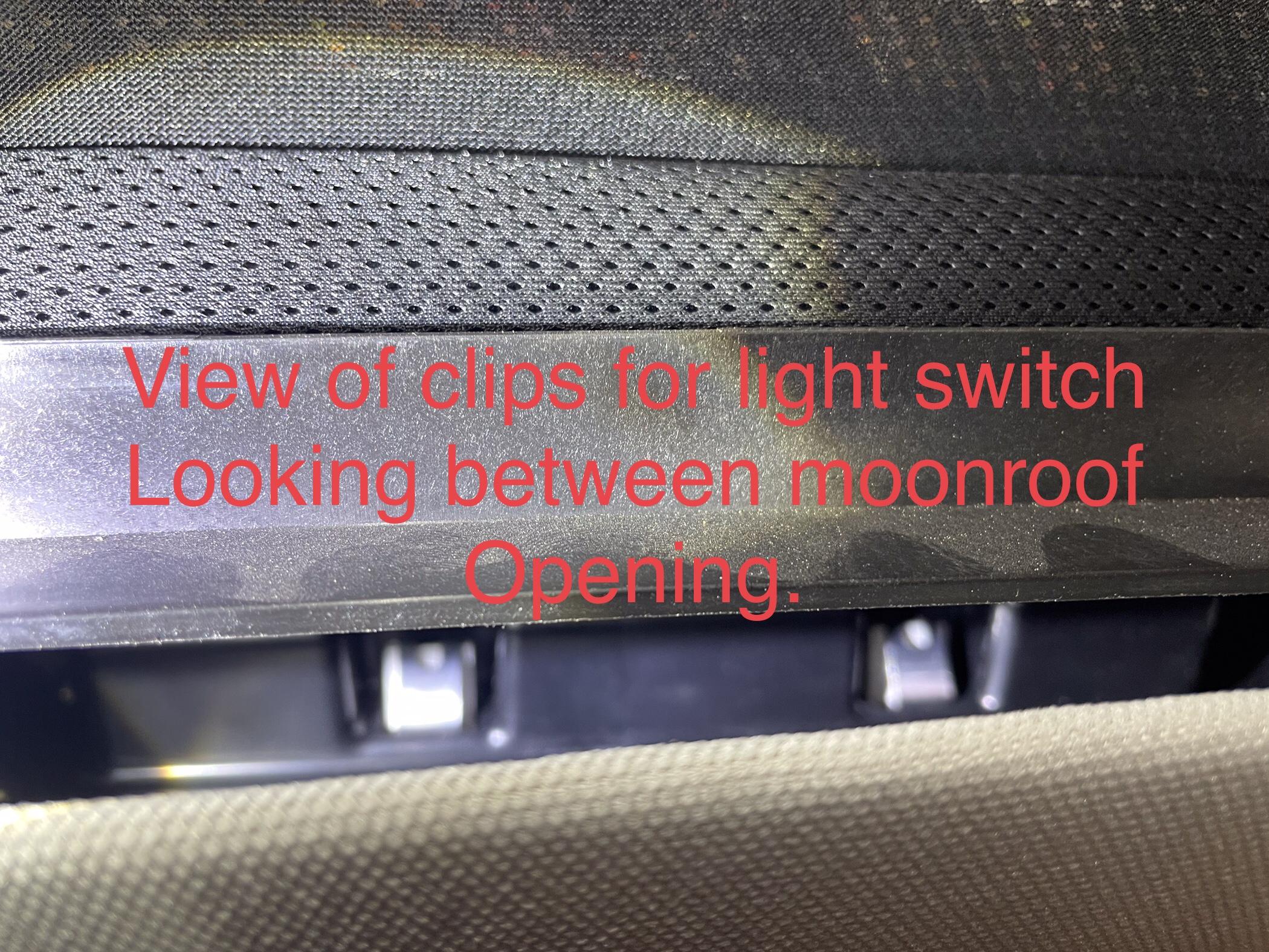

Good or bad. I‘ll add some things I did with my rear view mirro on this thread. I’m hopeful it’ll help someone down the road. I installed a used 453 Gentex no compass, homelink, auto dimming. I got from eBay
https://www.ebay.com/str/a2zmirrors...suid=torLCzY3Rpu&widget_ver=artemis&media=SMS
Power is not constant
This looks like a great alternative to using the overhead cab lighting harness. I may redo my mirror connections. Thank you for the detailed pics.
I had a fun time doing it. Now I have to look for other mods to do.
That is good to add. I do not have a moonroof, so my solution is for that. It is good see it is easier if one has the moonroof.
Someone could follow my template, and make a cable/harness to use that Moonroof plug.
All good stuff.
