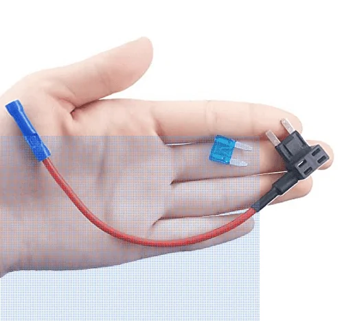

Installed mine also over the weekend, really like the upgrade. I wired it to the fuse panel and used fuse 3 and 20 for the power wire using fuse taps. Used fuse #3 for the switch power. Used fuse #20 for constant power. Grounded to one of the fuse box bolts.

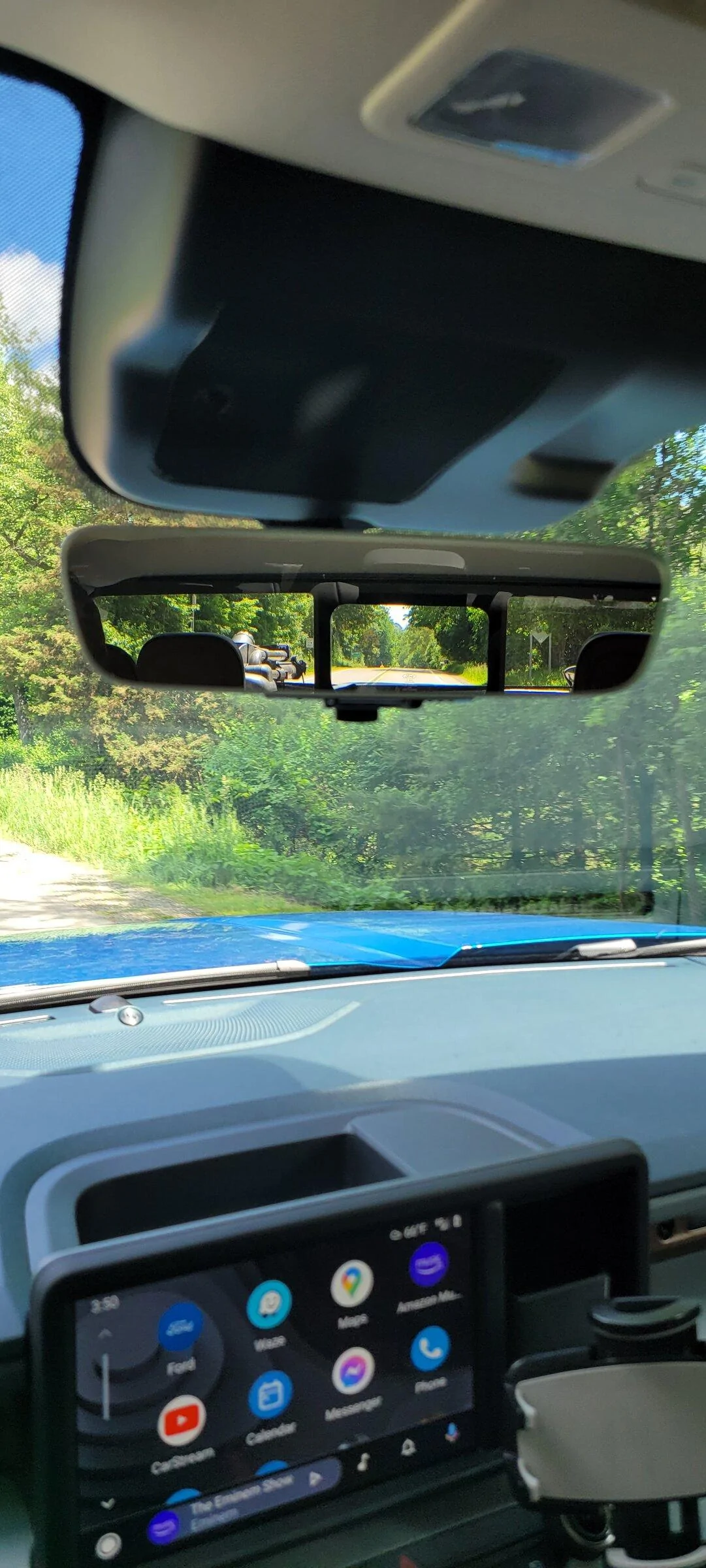

Snapped a pic of what it looks like in the mav
Ford Maverick Cheap auto-dimming, homelink mirror 20220607_155020

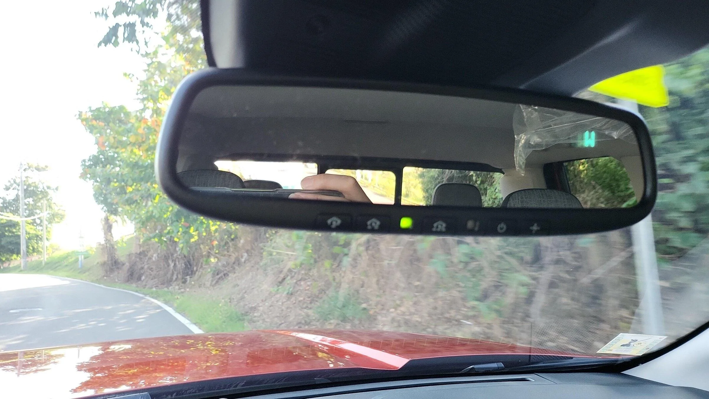

Is everyone getting home link 4 VHL4 mirrors? If someone got VHL3, please share link, to avoid. Thank you.
