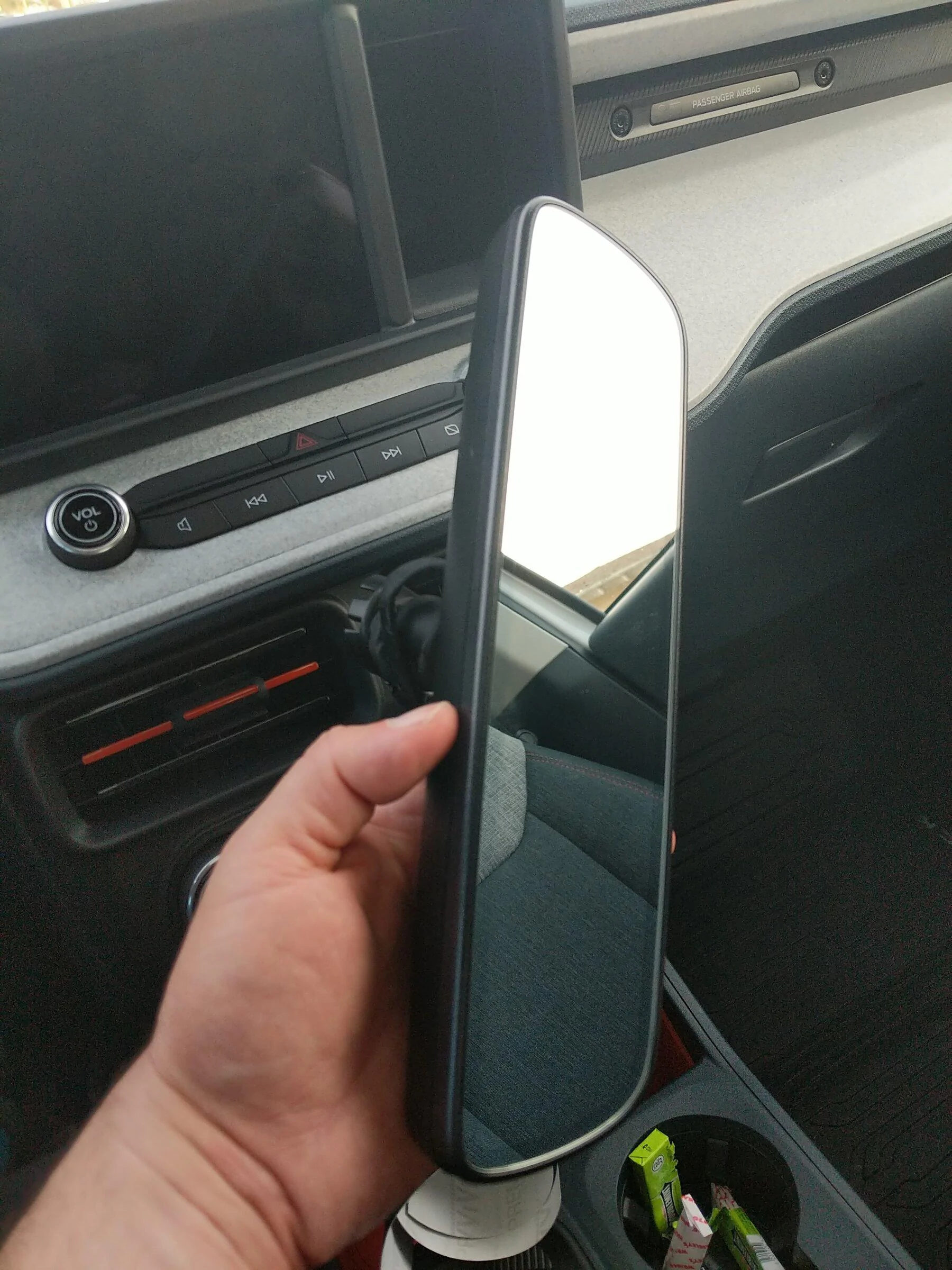

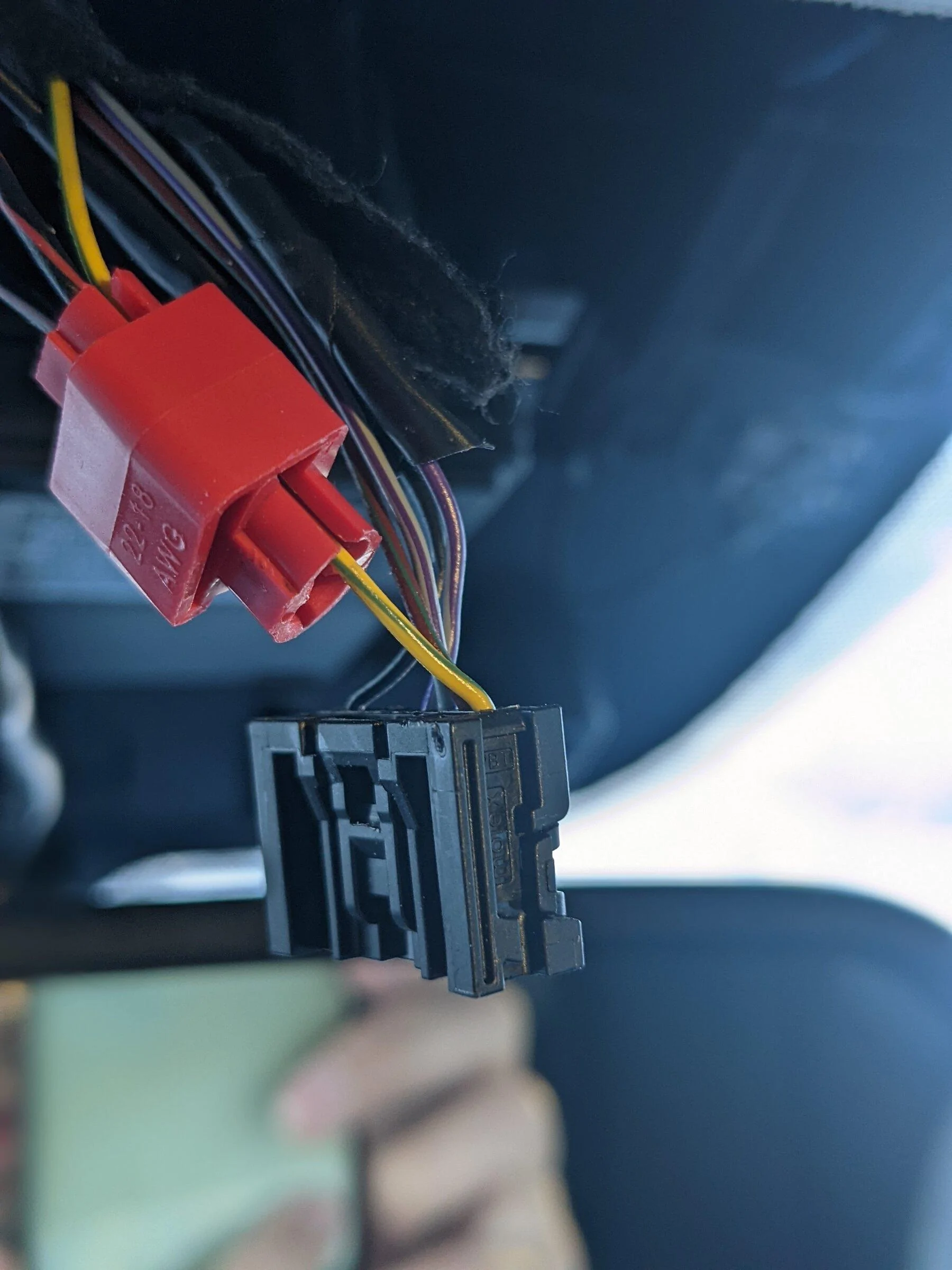

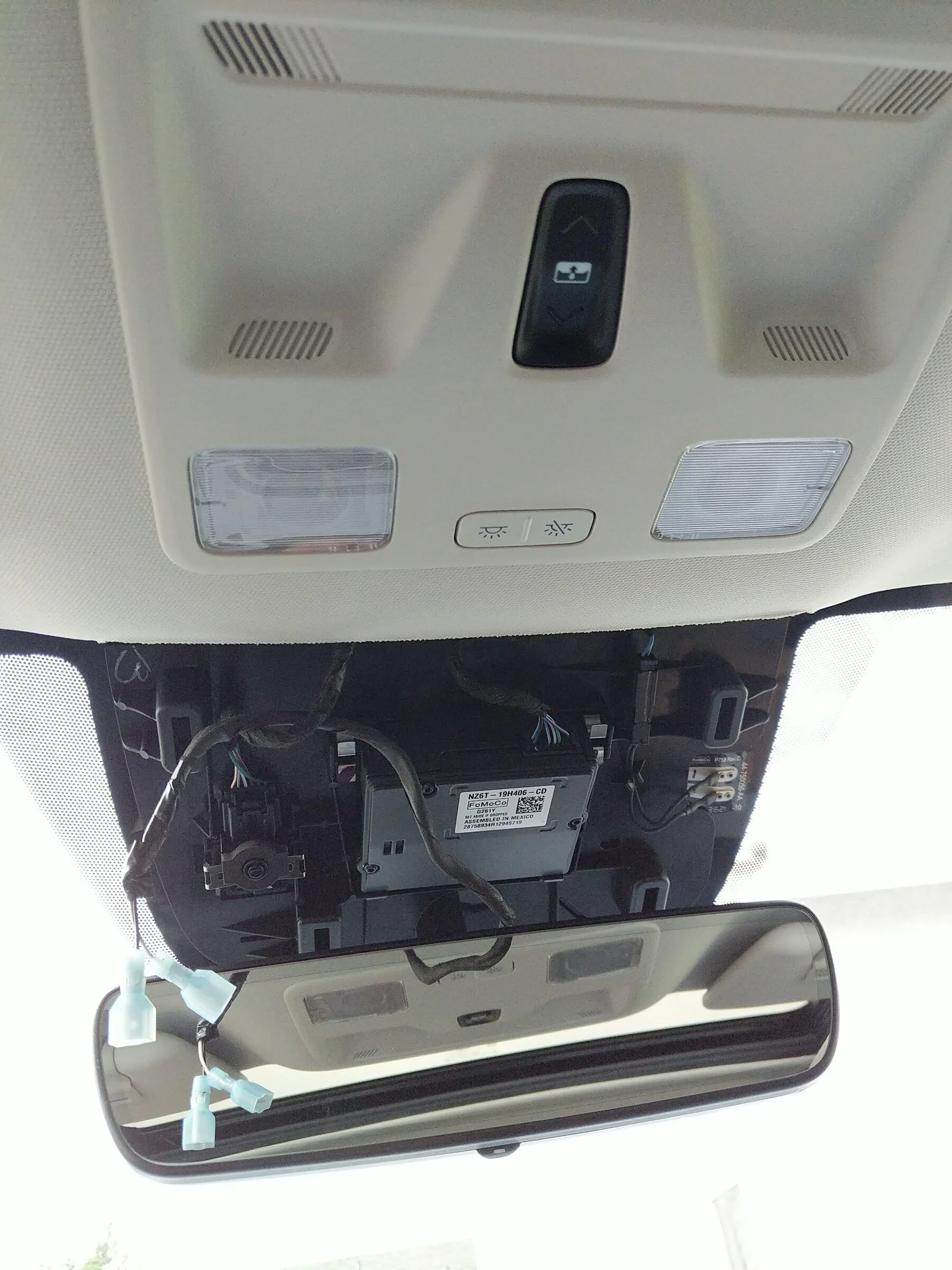

Hi all,
New to the forums. I actually have had an old homelink auto-dimming rearview mirror from a Nissan/Honda installed on my XLT since November.
I just connected the homelink mirror power and accessory wire together with the power from the ceiling light console power. When you turn off the vehicle the power will still be there for a bit but will eventually shut off by itself.
Ford Maverick Cheap auto-dimming, homelink mirror PXL_20220120_214601107.PORTRAIT
Ford Maverick Cheap auto-dimming, homelink mirror PXL_20220120_214759197

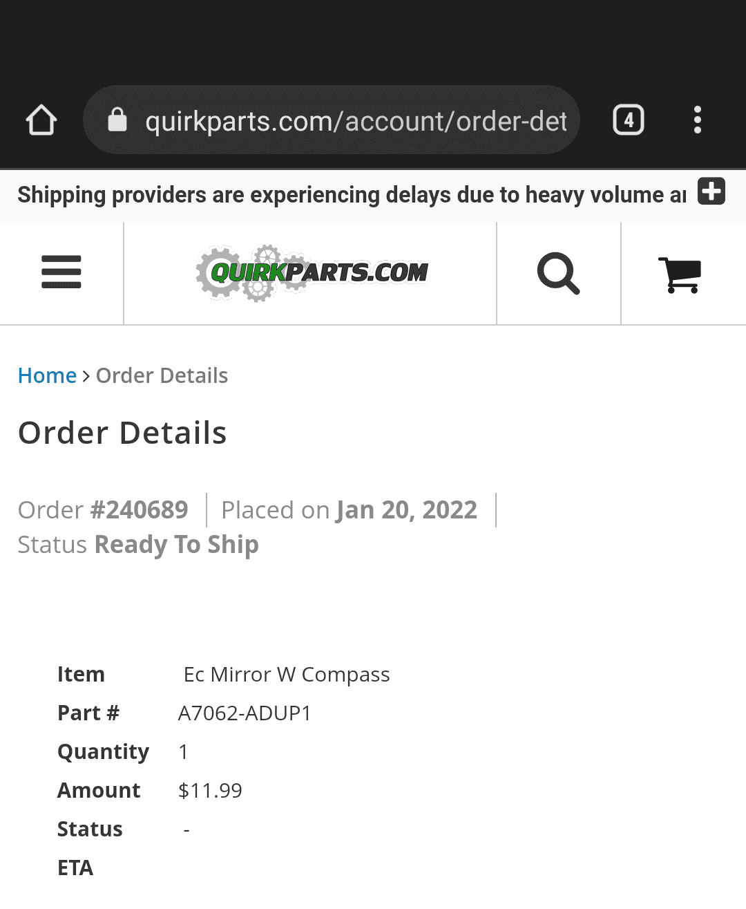

I ordered A7062-ADUP1 from Quirk Parts, looks exactly the same as the others. When checking status, it says "ready to ship"
https://www.quirkparts.com/oem-parts/kia-ec-mirror-w-compass-a7062adup1
I ordered two of the A7062-ADUP1 "Auto Dimming Mirror with digital compass and HomeLink" from:

Do you have better pictures?

Can you provide more details in how you wired it up.
What are the RED and BLACK connectors shown?
Where are the wires for the Auto Dimming Mirror in the pictures?

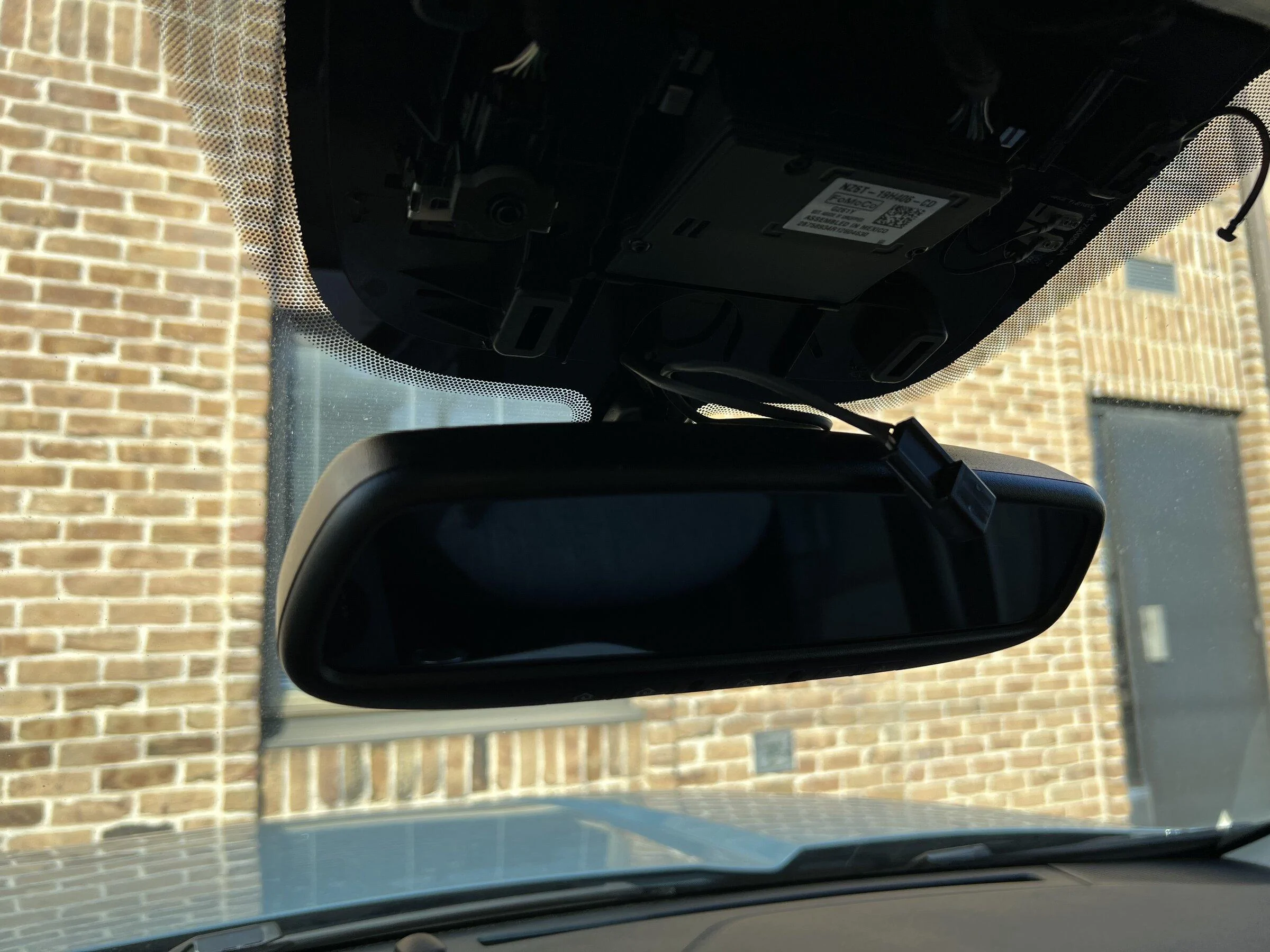

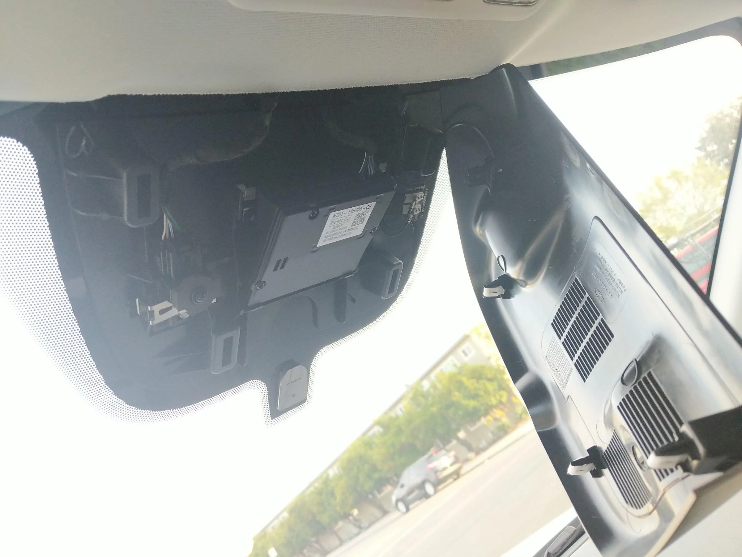

This thread reminded me I have a auto dim mirror in my garage I kept from my last car (its a frameless version with hidden compass). Heres some pictures of what under the panel, I ran out of time but will try to find power wire soon. I looked at it again, does anyone know how to get the dome light assembly off? , I think I will wire it to the light circuit but I pull on it and it wont come out, I will look for more info when I have time.
Check this thread:
Auto dim rear view mirror Install tip to remove center console

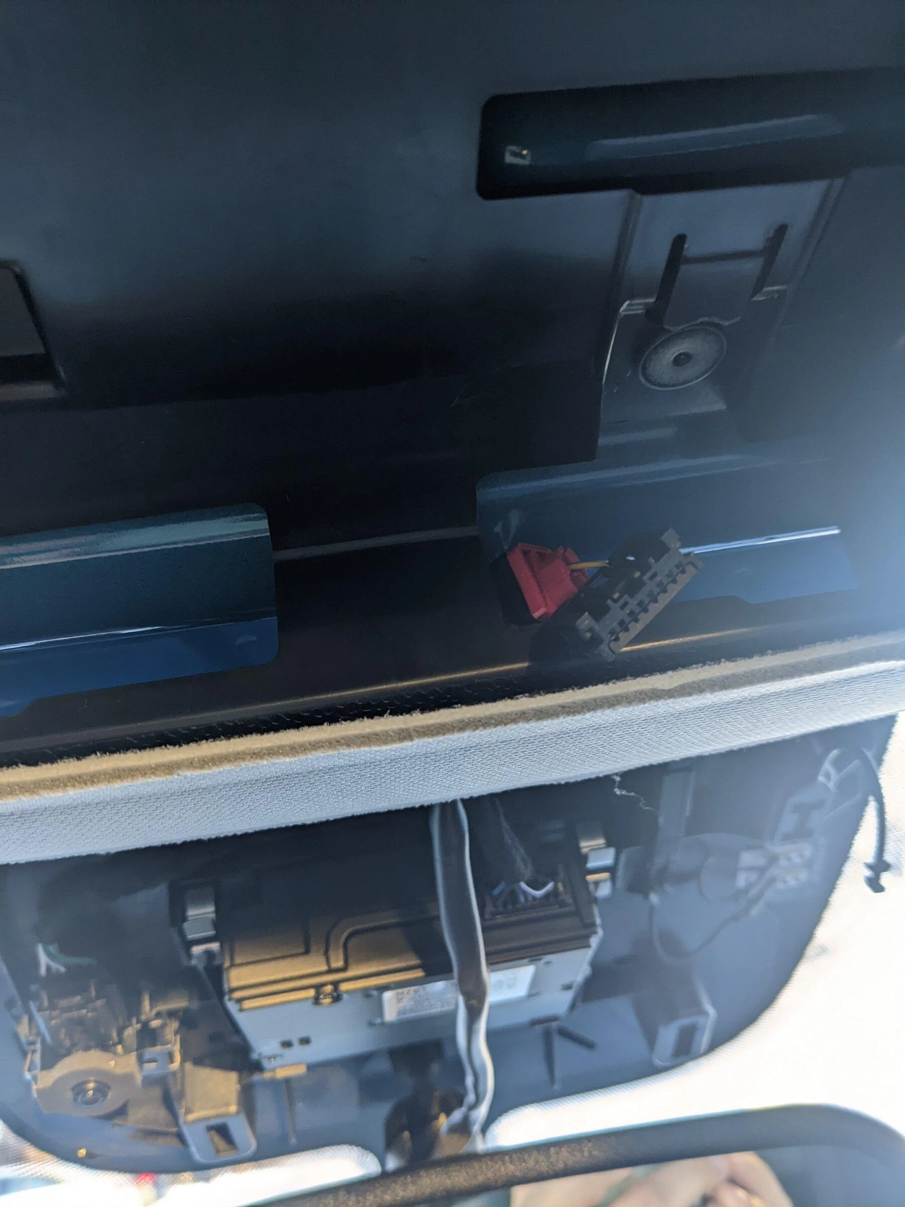

I have the KIA Auto Dimming Mirror and would like to wire it up without running wires all the way to the fuse box.
Is there any wires in the black box behind the mirror to get +12 volts and Ground.
I only care that the power is ON when the Hybrid is ready.
Pictures in order:
#1 - Black box
#2 - Black box opened
#3 - Taps and Wiring Harness for the Kia Mirror
#4 - Instructions for tapping wires
Ford Maverick Cheap auto-dimming, homelink mirror Mirror and Front Assembly
Ford Maverick Cheap auto-dimming, homelink mirror IMG_2665
Ford Maverick Cheap auto-dimming, homelink mirror Taps and Harness
Ford Maverick Cheap auto-dimming, homelink mirror T-Tap Instructions
