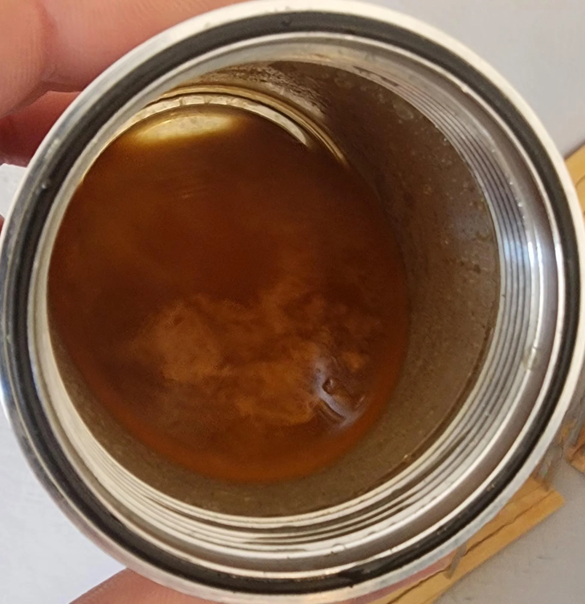

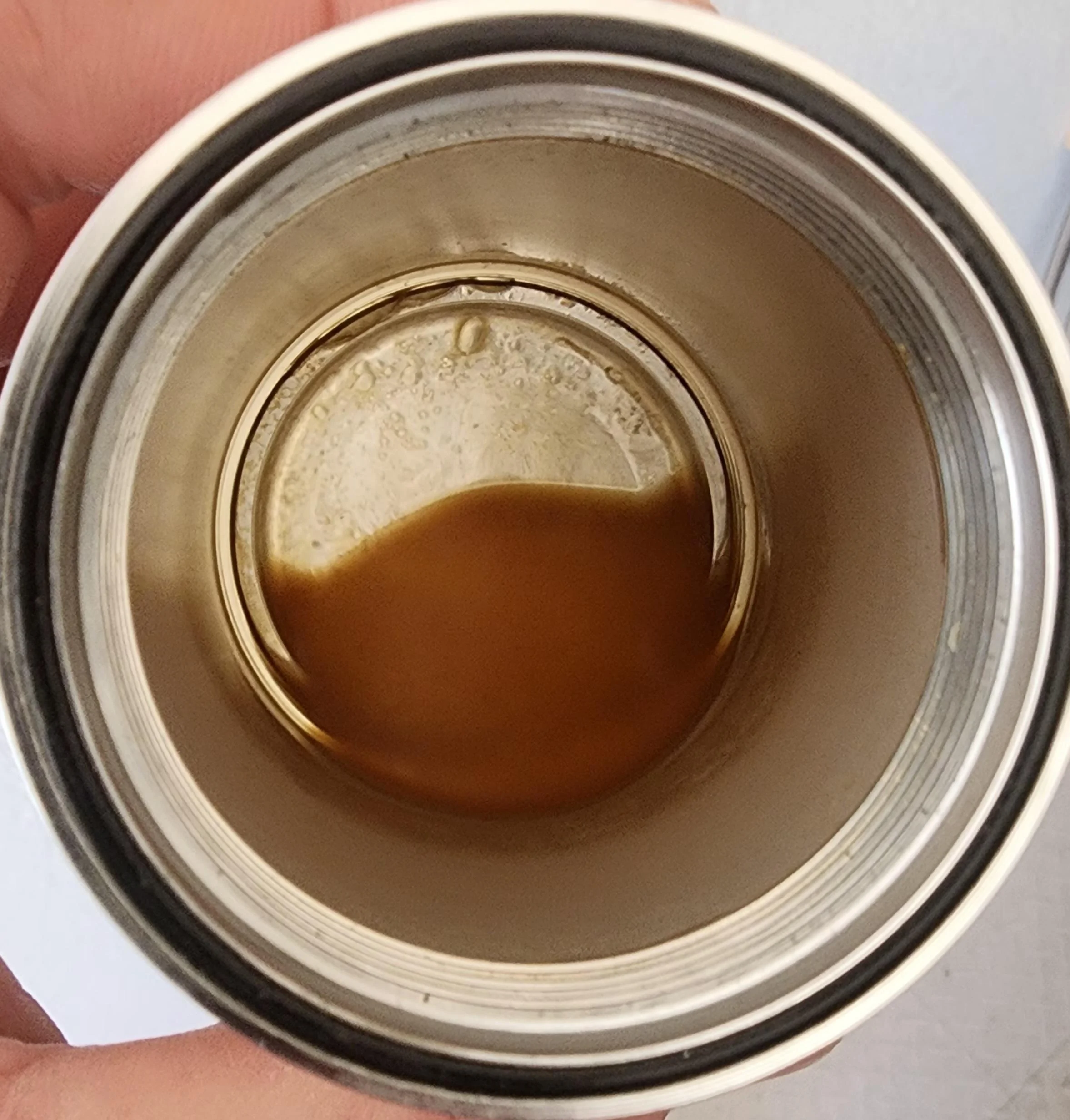

We are about to get hit pretty hard by this arctic blast down in TX. UPR recommends checking catch cans in anticipation of freezing weather, in order to protect the system.
I was doubtful I'd find anything in my cans, as I just dumped them at 7,447 miles. Current odometer reading is just 7,788 miles, but figured I'd stay on the safe side and look what I found... quite a bit in there already, as the photos show.
Friendly reminder to check your stuff if you expect to be impacted by the weather, and this also illustrates the importance of catch cans for this type of motor. I'll be checking mine more regularly than I thought, even when temps improve!
By the way and FYI for those who don't know, my Ecoboost is Burger Tuned and I've been running on map2 with 93. Everyone's cans will capture blow-by uniquely, depending on different variables (mods, driving style, environmental conditions and so forth).

That much blow by in just over 300 miles! Rings must be shot.

Ok, I'm not impressed. Its got an aggressive mapping kit on it that is essentially a race-only setup created for European-only fuel. You're running higher boost at higher revs than factory, having to run high-test fuel to compensate for the abnormal advance and cam curves, running waay off the pollution curves, and probably redlining it long before the oil is up to operating temperature. Good luck making it last for even the warranty period. This tells the normal owner nothing about how much blow-by oil is in the catch-can on an unmodified engine. Other owners report almost nothing in the can, so I'd bet you broke a ring or something to get that much.

The cans are performing as designed - capturing a combination of vapors (water, fuel, & oil). I didn't volumetrically measure contents this time, but they're catching indeed.

99.9% of what those stupid things 'catch' is water. A lot more condenses when it's cold.

Hey, Iconic Silver, I appreciate the post and well intended warning about the potential freezing of our catch cans. C'mon fellers, no need to attack the guy or second guess what he does with HIS truck. Sheesh. Water is going to expand 1/11 when it freezes no matter whose can it's in. I think I better keep my Maverick in Baja for the winter.... ;-)

Makes sense , always more condensation in everything throughout weather with moisture changes .
