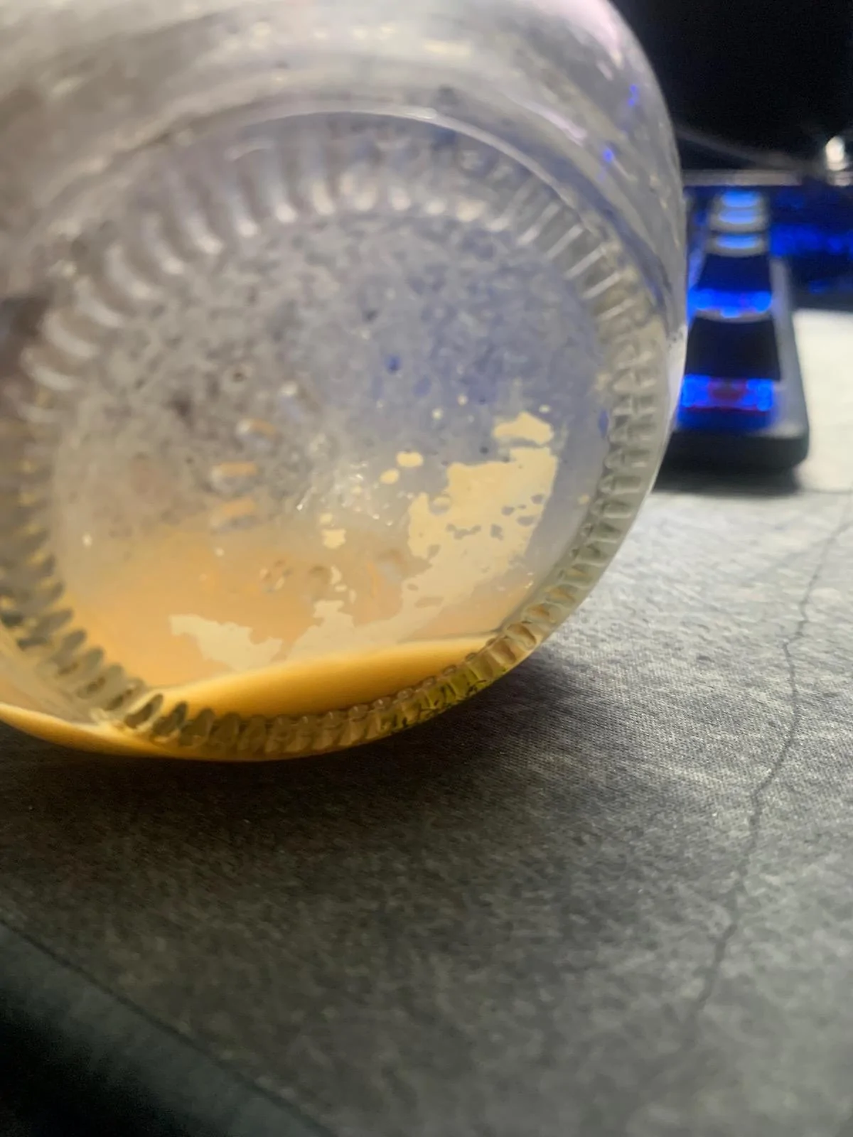

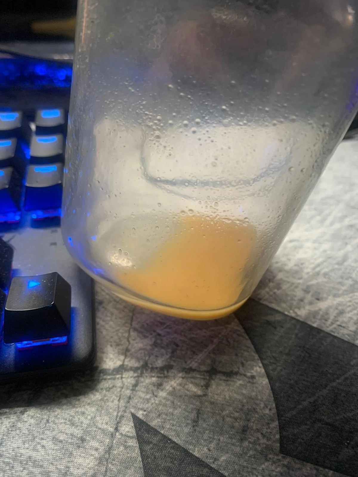

I run the truck pretty hard (towed ~3,300 lbs for ~2,000 miles) and my previous older cars that had cans produced a decent amount of liquid with much less stress. Both my cans have little to no liquid and just a little build up. Even the upper, low pressure can that's harder to mess doesn't seem to have any liquids. The cans do smell like something is going through them, and I added some steel wool to help the vapor stay in the can. I change my oil every 5,000 miles or less, used Prolong Engine treatment once @~1,500 miles, but don't think that would this great of an impact.
Because of the lack of fluid, I'm worried I did something wrong, or the vented vapors aren't making it or the can, or something else.

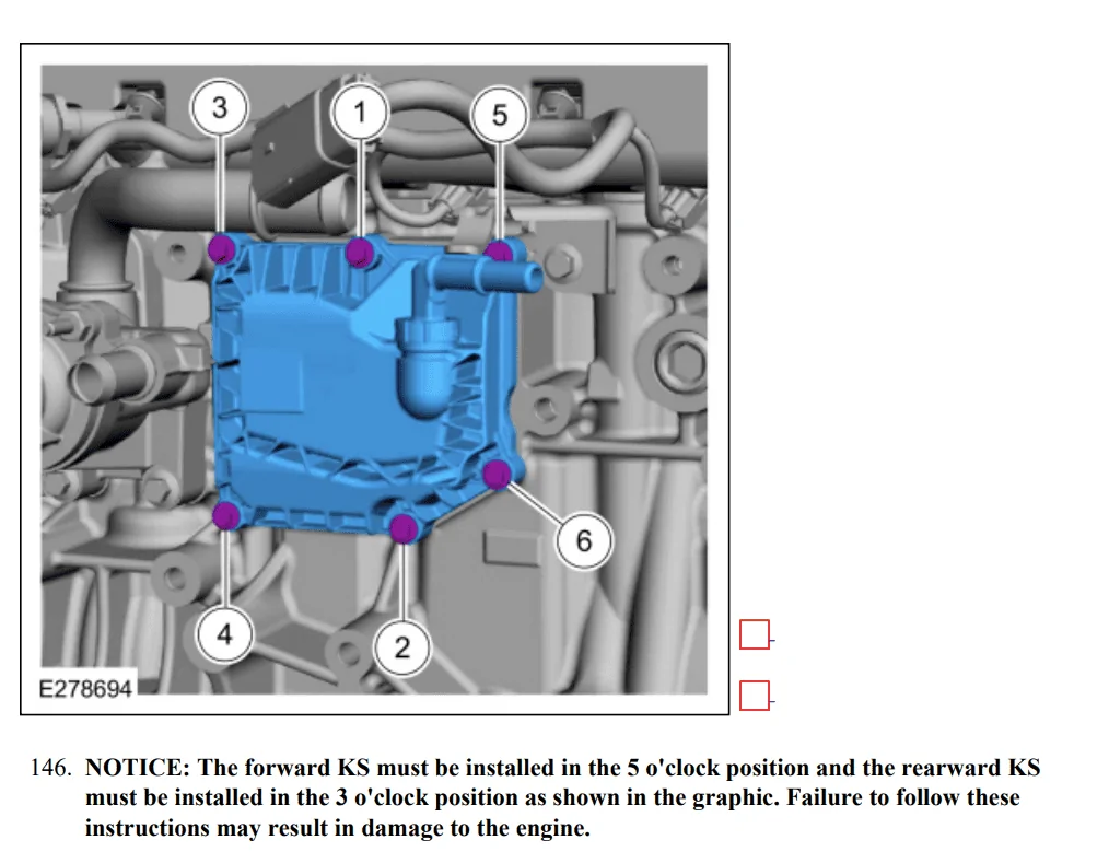

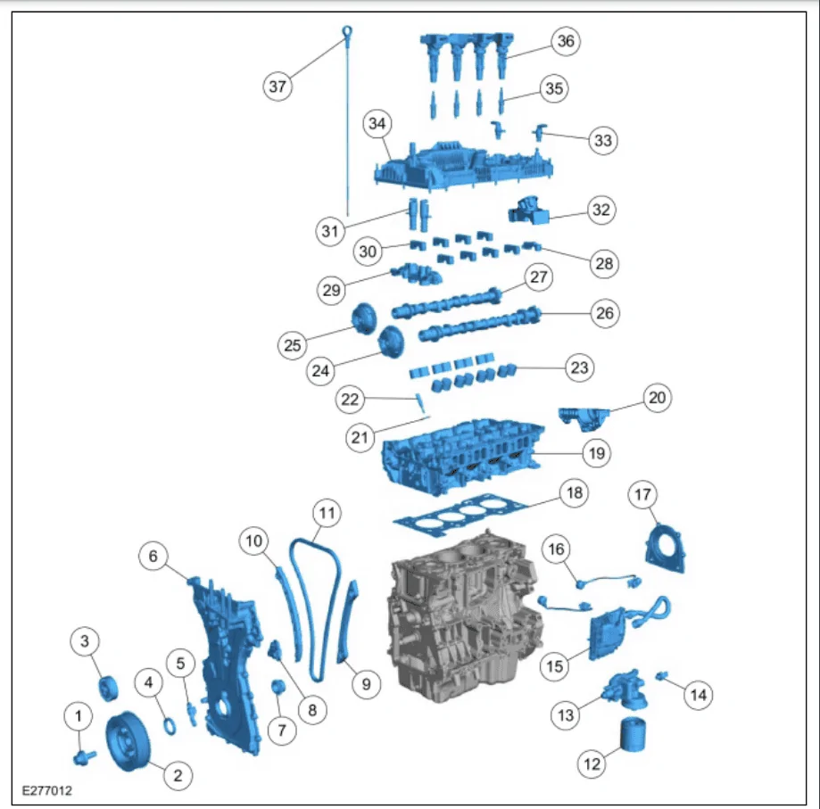

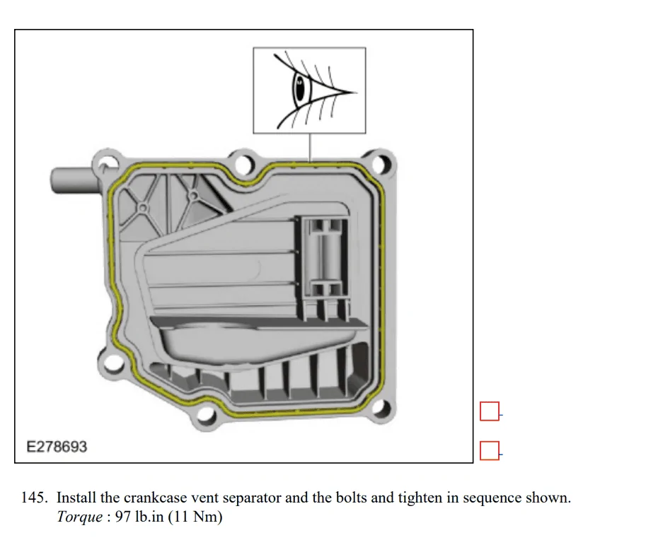

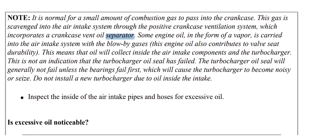

Also the hybrid 2.5 engine isn't GDI, which would allow oil blow-by to cause problems on the intake valves, that a catch-can is normally setup to help prevent.
That's great to know the 2.0 EB has it built-in. Appears to release what's caught so no emptying needed. Wondering how many prior GDI EB's already have it too, or was this recent addition to address the valve issues?
I wonder if it just holds a bit until a low vacuum moment and then anything there runs out.
ETA: already answered.
https://www.mavericktruckclub.com/f...-for-the-2-0l-and-2-5l-ecoboost-engines.8477/

Damn, that's cool that they now have a can built it!
I definitely did not know they had already updated the engine with a fix.
For what it's worth, I don't really think these cans can cause an issue (assuming it's installed correctly), and the replacement hose is only ~$15.
Meaning, there is a chance these will help keep some sludge out of the intake (why Ford now puts 1 in stock), and easy to undo if I need warranty service.
