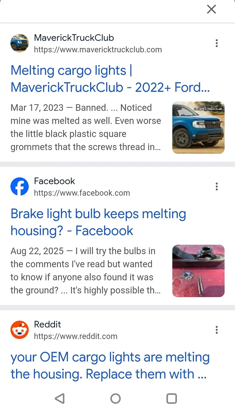

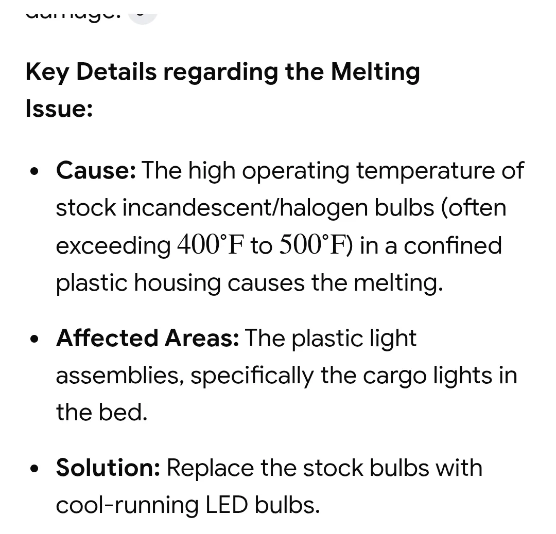

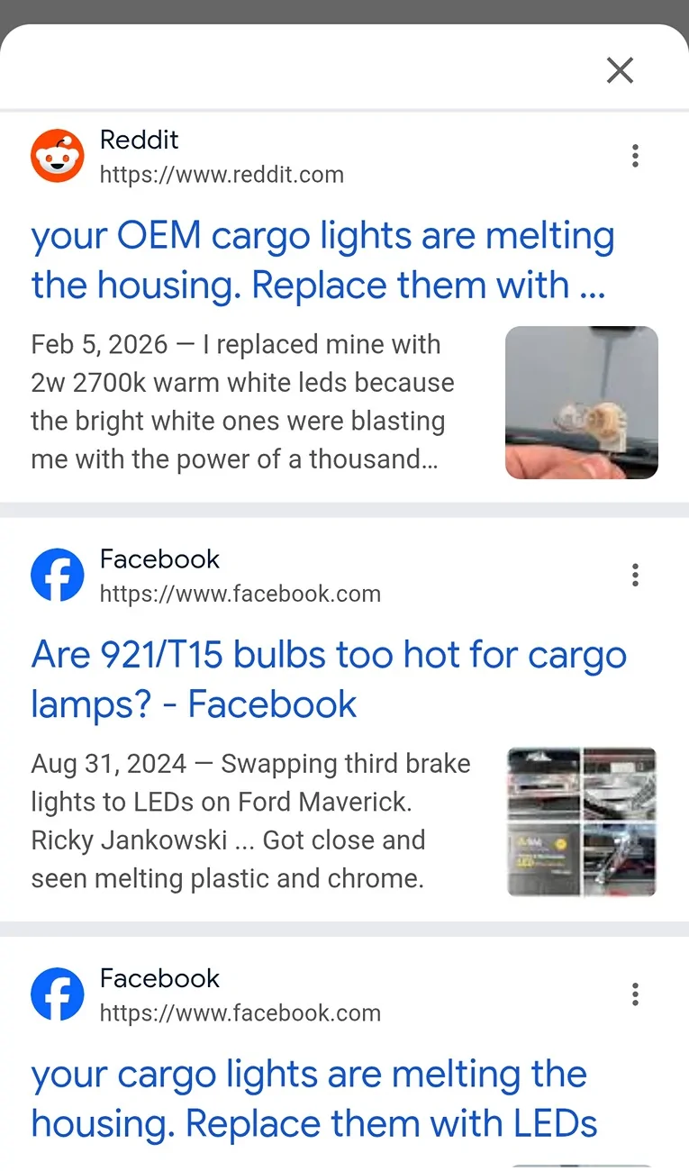

This is a common and known problem covered on many different sites from as far back at least to 2023. The bulb can reach 400°+
Ford Maverick Cargo light internal housing is melting/cracking IMG_20260217_155108
Ford Maverick Cargo light internal housing is melting/cracking Screenshot_2026-02-17-15-43-29-84_40deb401b9ffe8e1df2f1cc5ba480b12
Ford Maverick Cargo light internal housing is melting/cracking IMG_20260217_154400
