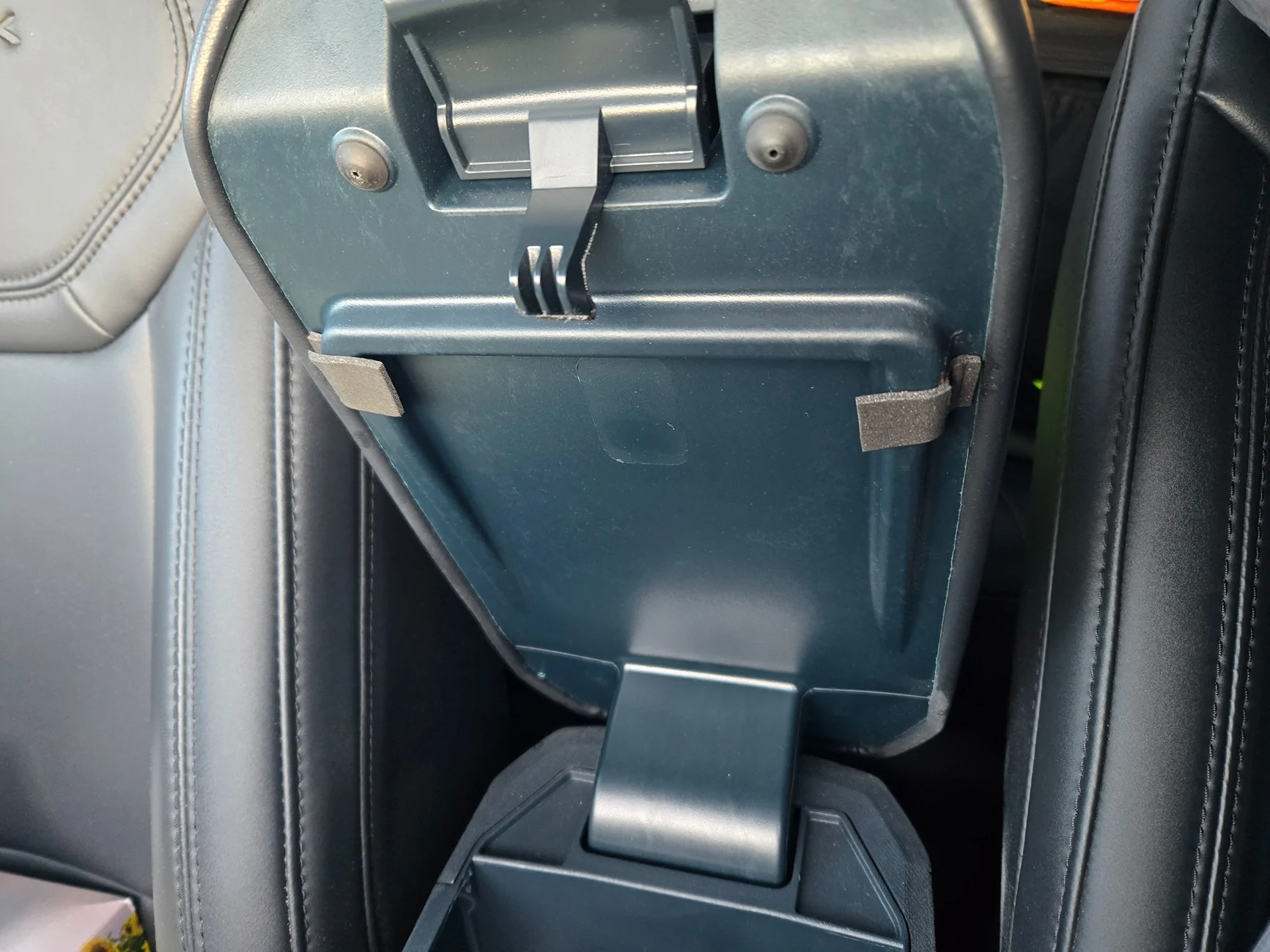

My 25 Lariat was doing it since I took delivery last year. However, on my most recent visit for servicing and an oil change, they looked into the issue with a bit more detective-like urgency and compared it to a MY26 that was sitting in their showroom. Note they didn't have any 25's left. They noticed that my vehicle was missing 4 foam-style spacers on the inside of the armrest/lid for the center console. Mine used to creek like hell and would even sound like it would lock in place everytime I placed any sort of weight on it. Since last week, the problem has been resolved. Ryan and the team @ Brown Bros Ford in Vancouver BC Canada figured it out.

Oh this might be the cure! Could you post pictures of the foam spacers, I'll check if mine are also missing
Thanks for the info

Here are two pictures, one of my work order and the other of the foam stoppers.
Thanks for the info
Attached are two pics, one of my work order and the other of the foam stoppers.
