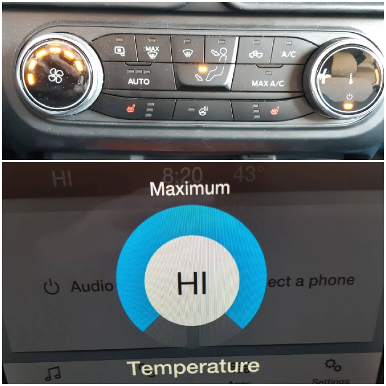

This was the configuration I had.
When the scent of melting plastic was present.

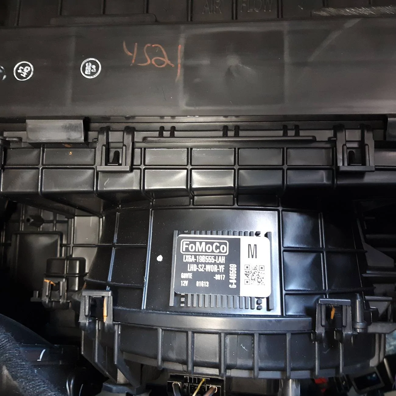

In between the two occurrences. I changed the filter. Well I had the area part I took the opportunity to take some pictures that I had posted.

Ford Maverick Melting Plastic Smell When Using MAX Heat 20241123_094425
