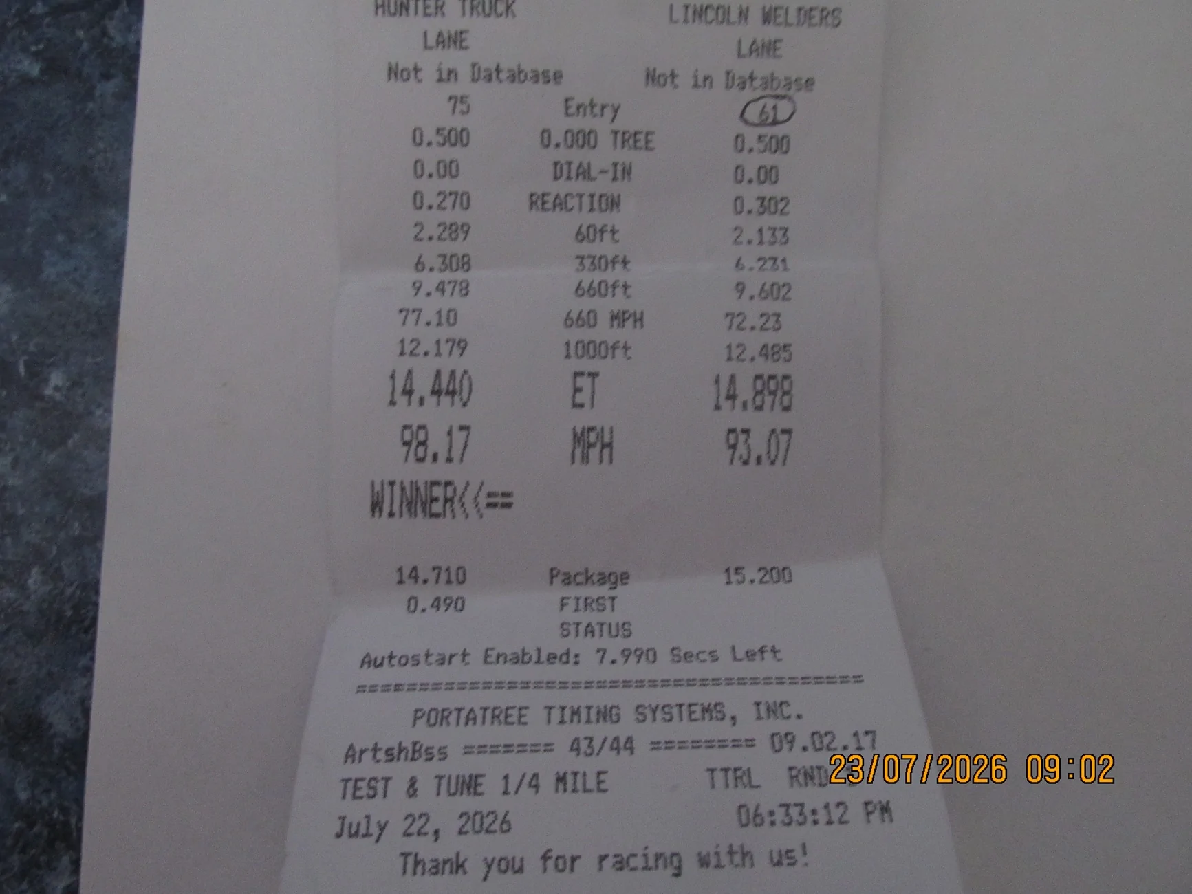

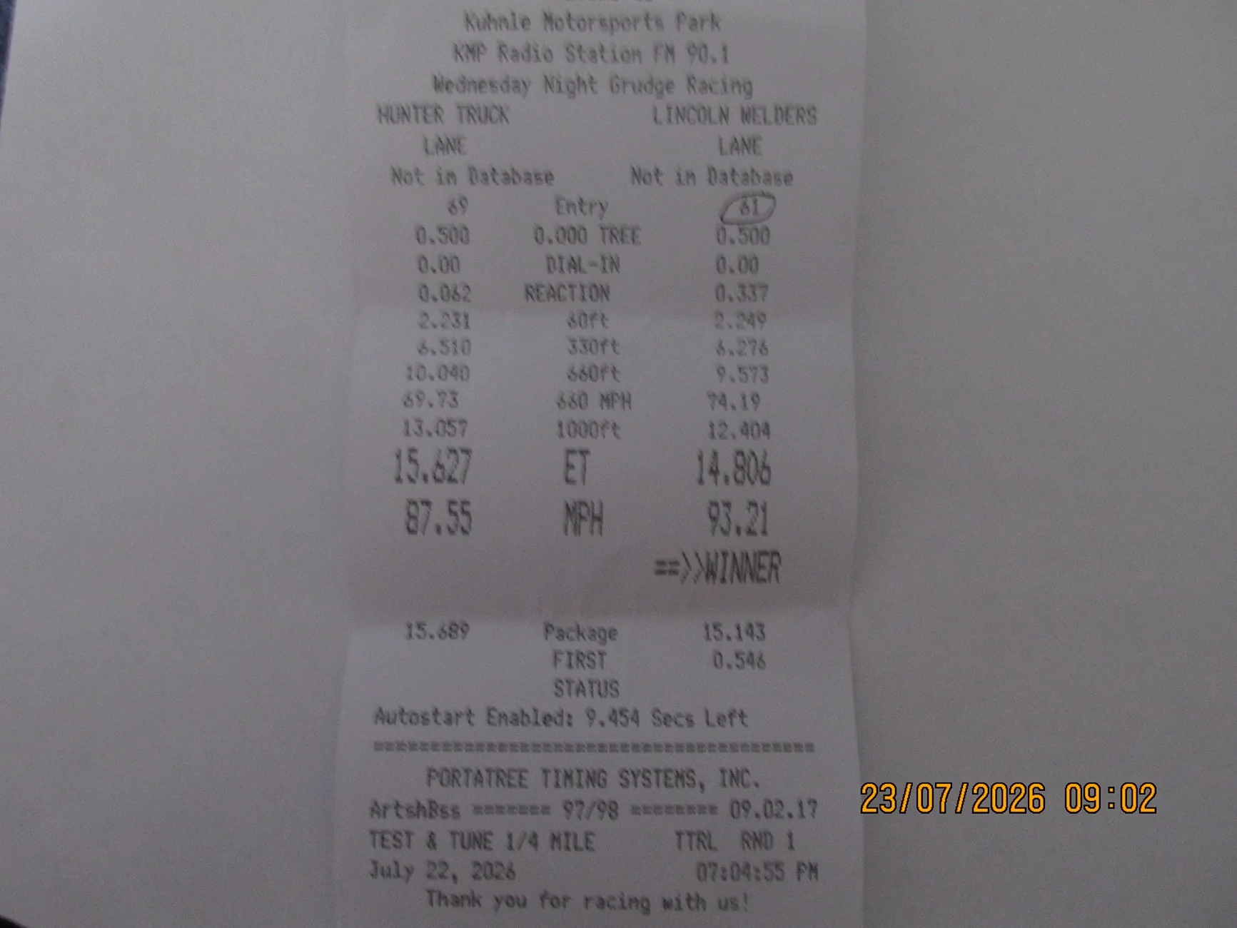

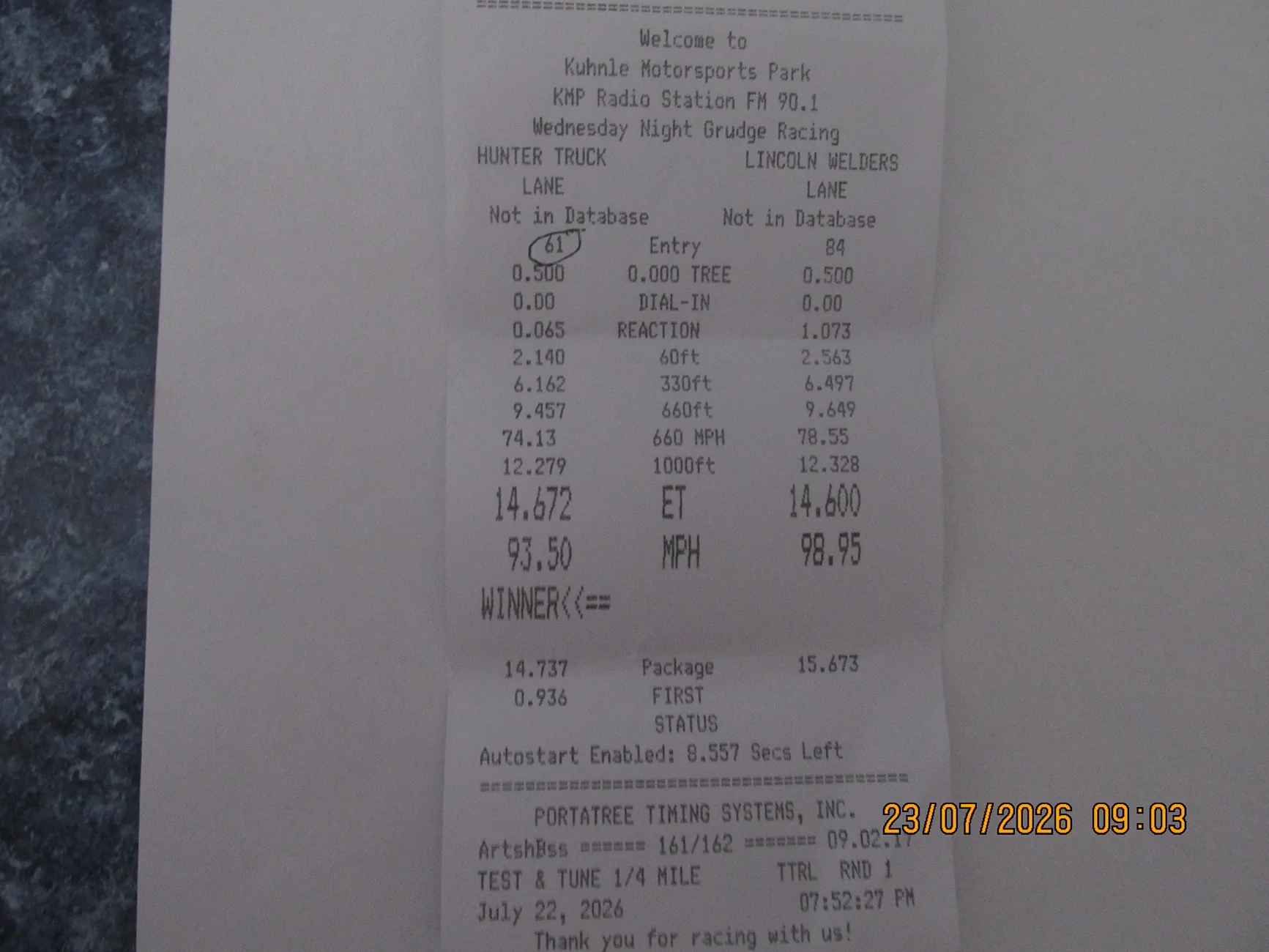

I gave mine a good Italian tune up 3 times back in July!! :)
Ford Maverick Carbon Build-Up? IMG_2108
Ford Maverick Carbon Build-Up? IMG_2109
Ford Maverick Carbon Build-Up? IMG_2110

I bet it runs strong.
