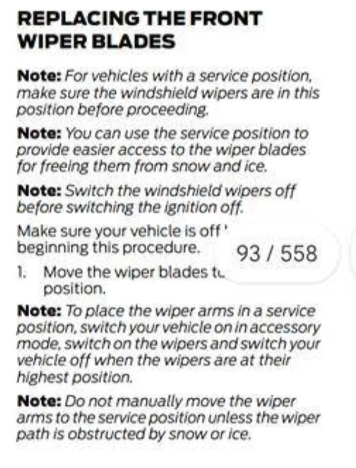

2024 Maverick XLT (owned for 3 weeks) ….. tried to raise the windshield wipers for snow removal…
they don’t raise, the hood overlaps the space. What!? Now what? Didn’t try raising the hood… would hope I wouldn’t have to do that. And how would you change the blades?
The user manual tells you the procedure. Paper or .pdf version.

Ok.....so the manual says don't pull them into service position on your own (by literally using your hand to pull the wiper arm across your windshield until it clears the hood).
But I have seen videos of dealers doing exactly that. There are some dealerships who use a "raised wiper arm" as an indication that a vehicle is ready for some next step like being detailed, taking photos, being done with those steps and ready to be put on the lot for sale, etc....
So do it at your own discretion. But It IS possible to just move the wiper arm manually to the service position without turning on the truck. It doesn't seem to break anything.....at least not immediately.
I've done it many, many times. It won't hurt a thing.

We live in michigan,like to leave the wipers "up" when it snows so they don't get iced in.apparently you can't do this with the maverick,but the area they park in is heated at least. Also don't try and lift them up with the hood down since you will scratch the paint on the edge of the hood!
It is a pain, but you can turn the truck off with wipers in mid sweep. Allowing you to raise them for the night's snowfall.
Same procedure that is used when you are changing the windshield wipers.

Easier to just turn them on once until they vertical and turn the truck off, I do this on any vehicle not just the Mav

in any case it's always a good idea to place a towel, cardboard, etc. under the wiper being changed so an accidental slip won't crack the windshield
