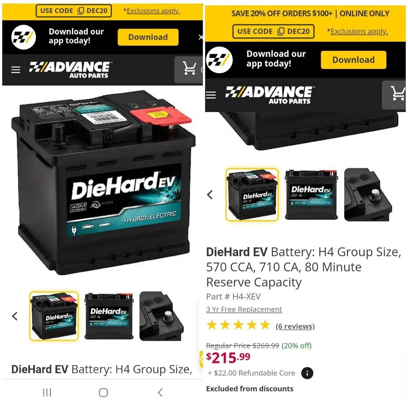

If you have an Advanced Auto Parts near you they sell this Perfect Fit DieHard EV Hybrid / Electric AGM Battery.
(Better Labeling) than previously, a bit more specific.

Since the battery does not crank the engine CCA is not something to be concerned about. The spec you want to concentrate on is reserve capacity or AH, the higher value of that you can fit into the space provided the better. A deep cycle, marine grade, or RV battery would be more appropriate for the Hybrid with what it does in the truck I would think.
Just looked at the Battery that is recommended the most for replacement in the Hybrid and it is kind of funny. In the description it states 120 RC and the sticker on the battery says 80RC. Wonder which is correct...
This is from the description on Amazon:
UPLUS BCI Group 140R Car Battery, AGM-L50-UP Maintenance Free 12V 50Ah Premium AGM Batteries H4 LN1 Automotive Battery, 570CCA, 120RC
