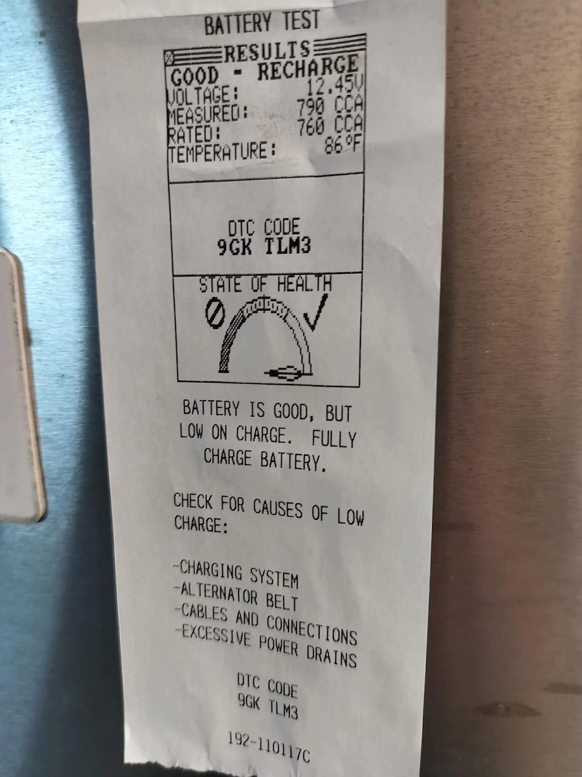

Had oil change at dealer at ,943 miles. They left this on dash. At 2100 miles now. Zero issues. Battery seems fine. 2.0, only elec. Addon is dashcam which stays on 5 or 10 minutes after shutdown.
Ford Maverick Ecoboost random dead battery IMG20240411065436
