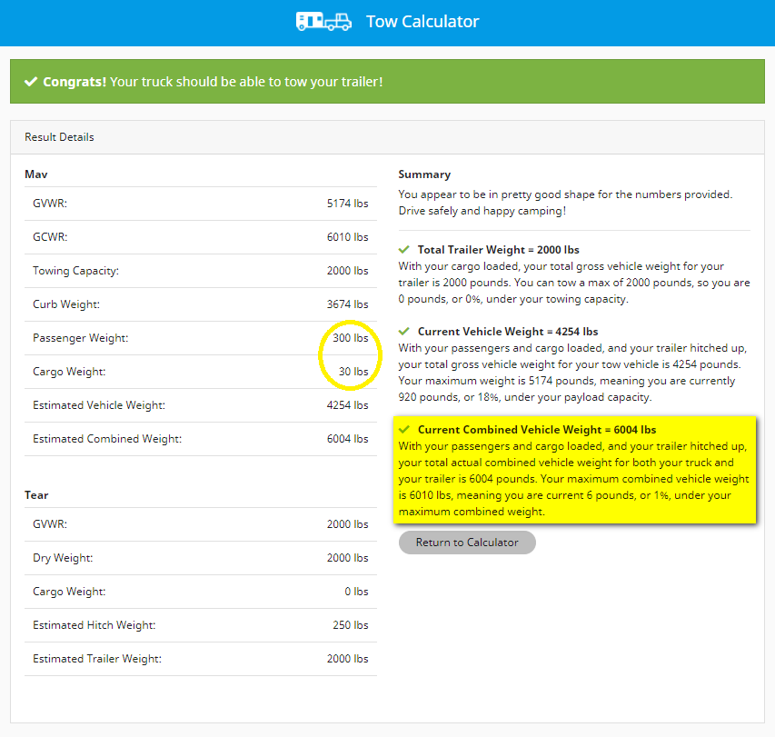

Do a quick and dirty check using the camper trailer specs you're thinking of getting, plug into a simple towing calculator like this TowCalculator.com and see what it spits out. Bear in mind for the tow vehicle (i.e. your Maverick) the curb weight, actual truck-specific payload capacity, GVWR are numbers we think we know, not what they actually are - you'll need to see your door jamb stickers for actual payload and GVWR and GAWR's.
What we "think" we know about the Maverick as a tow vehicle from various Ford sources:
  • Base Curb Weight (2.5l FWD Hybrid) = 3674#, Base Curb Weight (2.0l FWD) = 3563#, Base Curb Weight (2.0l AWD) = 3731#.
  • Maximum Payload Capacity = 1500#s (a general number from Ford in various media items for all trims and configurations) – or - maybe 1564#s for a base XL Hybrid (from eSource Book). Regards actual payload ratings, we all won’t know for sure until we can see those yellow stickers. eSource book says “Customers can load Maverick up to its maximum payload rating(2) of 1,564#s. with the 2.5L Hybrid, which is enough capacity to haul 39 bags of mulch at 40#s. each or a small recreational ATV.” Footnote (2) says “Maximum payload capability is for properly equipped base vehicles with required equipment and a 150#. driver, and varies based on cargo, vehicle configuration, accessories and number of passengers. See label on doorjamb for carrying capacity of a specific vehicle. Payload and towing are independent attributes and may not be achieved simultaneously.”
  • GCWR = from prelim. Tow Guide. 6010# (Hybrid), 5900# (2.0l FWD), 6345# (2.0l AWD), 7900# (2.0l FWD w/4K Tow), 8145# (2.0l AWD w/4K Tow).
  • GVWR (rough calc not actual, need to see the white door sticker) = Base Curb Weight + Payload Capacity. If you assume a ~1500 # payload capacity rating for trims/configurations, then GVWR = 5174 # (Hybrid), 5063 # (2.0l FWD), 5231 # (2.0l AWD).
  • TTW = 400# max (2.0l FWD or AWD w/4K Tow). For the Hybrid, not sure yet but I think it might be 200#.
Hopefully Ford will bring back their own Towing Calculator. It was great while it lasted.....which wasn't very long at all. Ford put it up/made it live in late March 2021, it was there through mid-April.........aaaaaand then it disappeared. Still not there. Don't know why Ford took it down so soon. Conventional wisdom is their legal dept. had issues but who know? It was here... ford-digital-fleet-hub-fe .....then it wasn't. Ford said at the time it disappeared: "Thank you for your interest in the Ford Fleet Live Towing Calculators. This functionality is currently unavailable while we undergo maintenance and improvements. Thank you for your understanding. -Ford Fleet Team"
