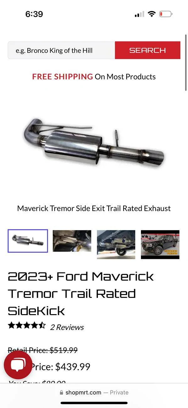

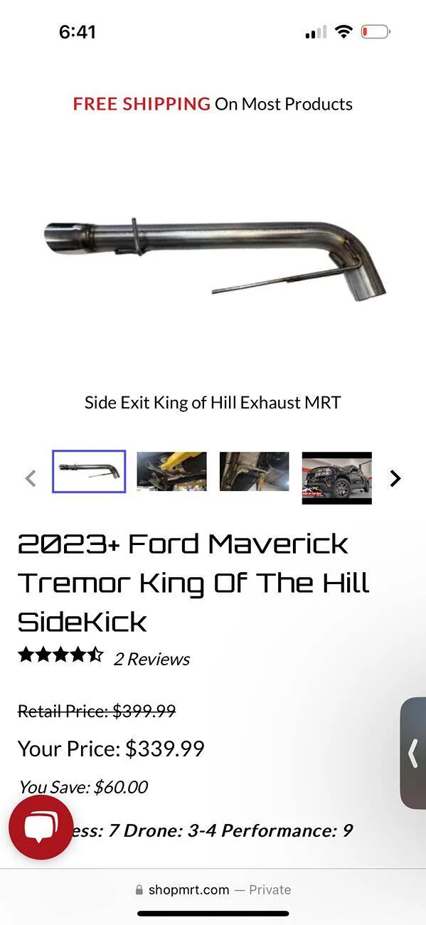

And here is a picture of the two different options. The trail rated sidekick with a muffler and the king of the hill sidekick without the muffler

Do you have the one with a muffler or with no muffler?? I have the one with the muffler and it’s really not much louder than stock. My girlfriend rode in the car and didn’t complain or even notice I changed the exhaust LOL
I imagine you are talking about the straight pipe option with no muffler.. if you DO have the one with the muffler I’d check the exhaust clamp to see if you have a leak where this mates to the factory exhaust.
I have the one with muffler. I have no leaks. I actually had to pay another $80 to have mine welded. I also have lots of sound deadening and a subwoofer under the back passenger seat. The muffler and exit is too close to the cabin, so the noise resonates at even the mildest acceleration. There's a constant drone on the highway as well. I cannot hear any engine nor road noise -- only exhaust. My family hates it. I'm not a fan either. I hope to switch to Magnaflow or Thermal full exhaust at some point.
