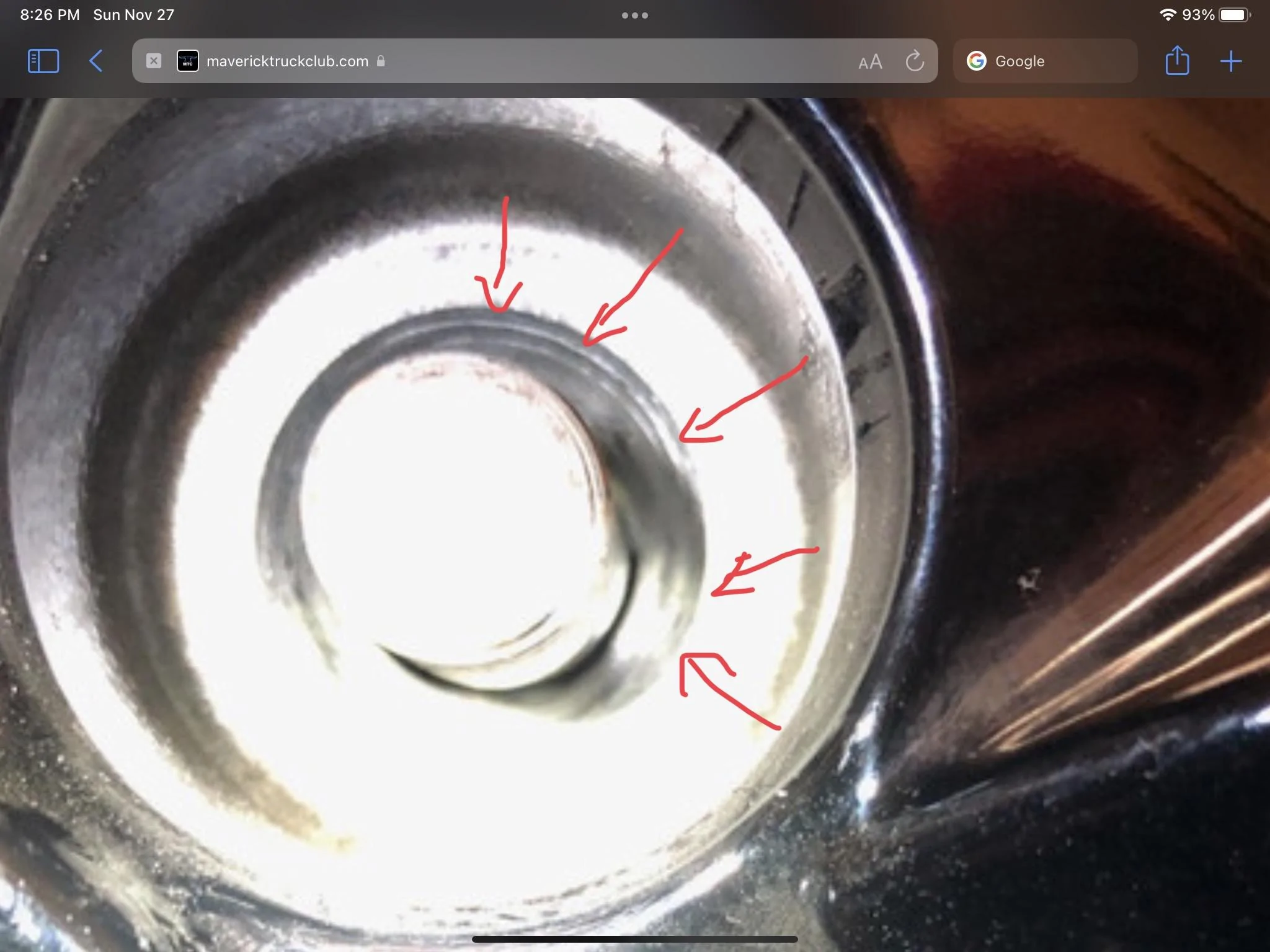

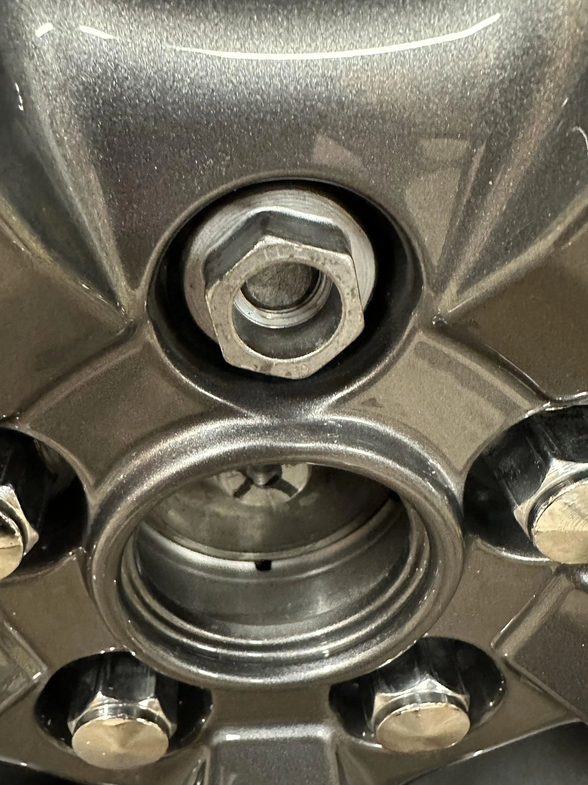

Maybe it’s just the angle of this pic or the lighting/flash but it appeared like oblong damage to me. Looking again you are probably right. I’m sure you can see what I was thinking, it isn’t exactly the best pic

I have already returned the chrome oem Maverick lugs. Only used the oem steel wheel lugs for a comparison pic. That was probably confusing.
I also don’t think Bronco sport wheels are inherently dangerous. Just that some lug nuts don’t fit them very well on the Maverick.

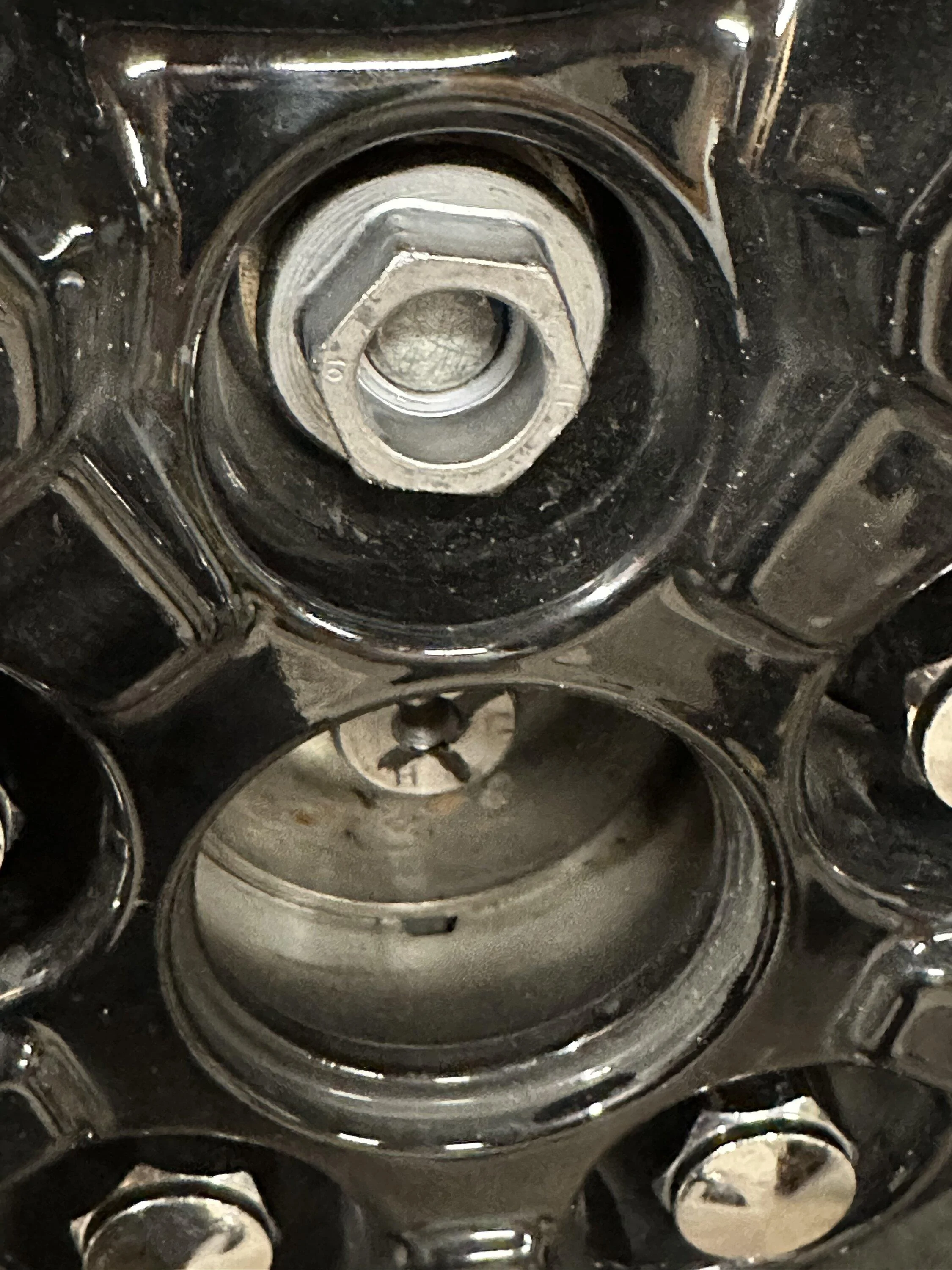

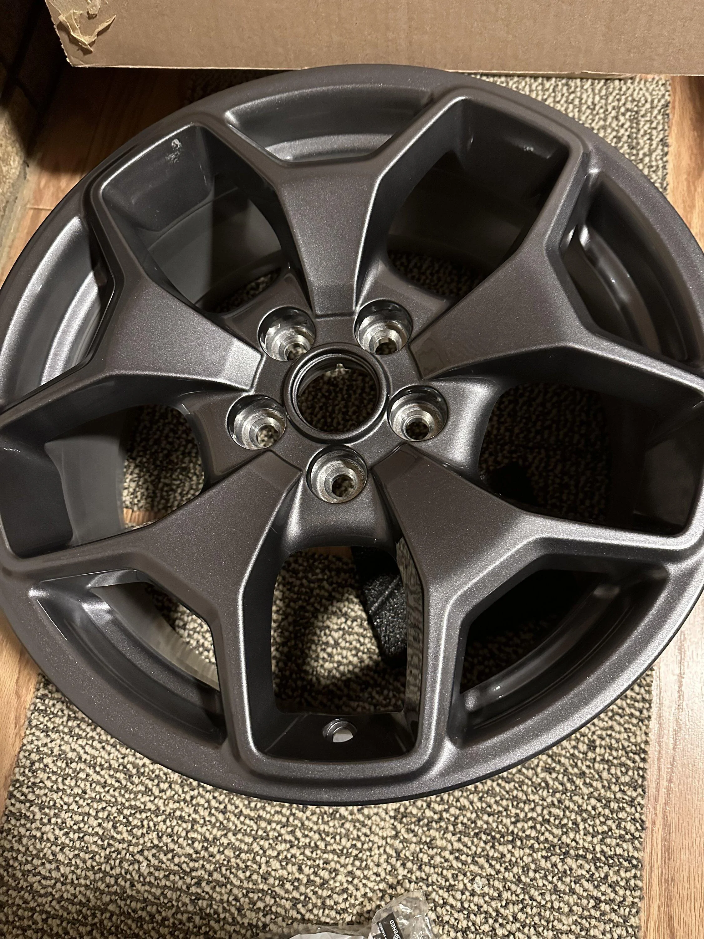

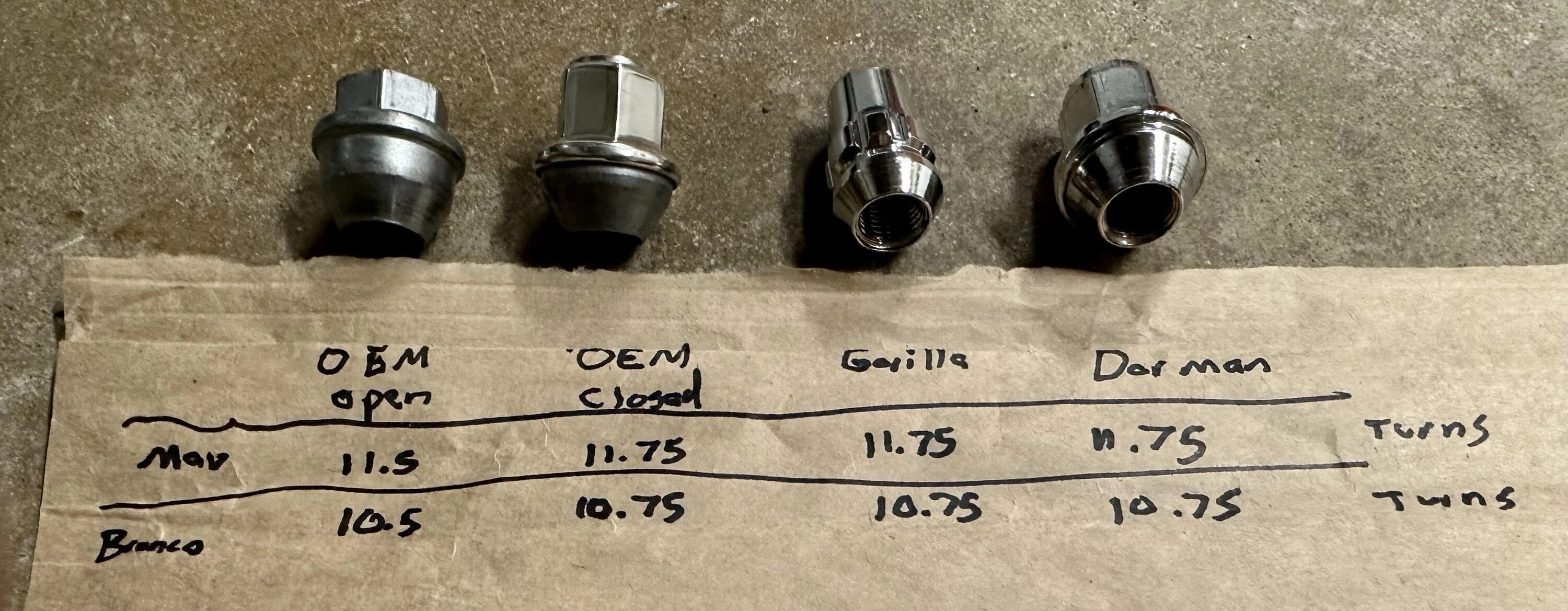

Adding my .02 cents worth. I tried about every lug in this thread and others. Only 4 would seat well in the bronco sport rim. The others would go from side to side not seating firmly and felling snug. The one’s using those lugs I’ve no doubt they hold the rims on, just saying when off the truck they just don’t seat well.
This test was all hand tightening for number of turns. The starting point was my dad taught me how to never strip a nut. Turn counter clockwise and push until the thread clicks into place. Lug nuts used were open OEM so I could see engaged threads, OEM, Gorilla and Dorman
Ford Maverick BRONCO SPORT LUG NUTS ? 668FA1A6-9B35-4D3D-8EDE-8255076082C7
Ford Maverick BRONCO SPORT LUG NUTS ? CC4F6BF4-1DF7-4862-B434-6E45C1153747
next is how many turns the lugs turned, hand tight on the black lariat rims and bronco sport badlands carbon gray.
from the inside the rims, all thread were visibly flush with the hole to engage the nuts.
The OEM open lug was marginally less engaged by 1/4 turn, the rest were exactly the same. One turn less on the sport rim. Didn’t matter the gorilla had a smaller taper.
Ford Maverick BRONCO SPORT LUG NUTS ? B2481E0F-7F42-45C1-AC0B-F8E72037430D
this is how the open nut looked on each rim. Again, hand tight. Running to 148lbs tight, one thread exposed on maverick rim, 2 threads exposed on Bronco sport rim. Probably due to the smaller opening?? They were all well engaged and seated seated just fine.
Ford Maverick BRONCO SPORT LUG NUTS ? 14BEB8AC-2669-4154-BD1F-B2CBFA66AC7A
Ford Maverick BRONCO SPORT LUG NUTS ? 6F7C6C4D-5654-4540-A98D-1C5194C19452
I’m keeping the oem covered for my daily use I think they look better and if an impact never is used they will last. I will put on the dormans if discount tire or ford ever lay their hands on them!
Here’s the rims I used
Ford Maverick BRONCO SPORT LUG NUTS ? E4C88ECA-EFB0-4B86-AF8A-340B5CA6B4AD
