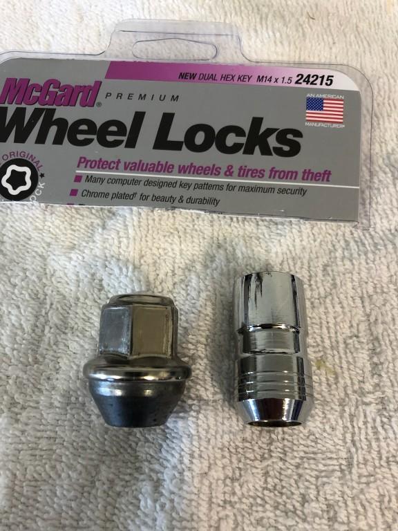

Johnkn
Jan 19, 2022
73
2,311
3,492
MD
Here is the pic of a stock Maverick lug nut beside the correct McGard 24215 that they recommend. The McGards are 1 piece, the inside appears to be a different color because the inside is plugged during the chroming process. .

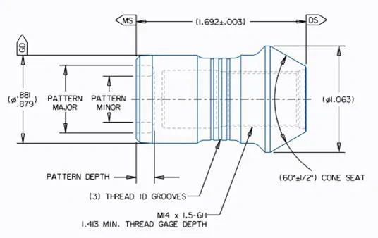

I was concerned that the lug nut seat, while the correct taper, was much smaller than OEM. They confirmed that it's correct but also offered that they also manufacture Ford's OEM lucking lug nut, which has the same wide seat as the regular lug nuts. Here is the drawing McGard provided and their response:
(From McGard) Kit# 24215 is the recommended aftermarket kit for this vehicle and will work as intended. However, if you would prefer a slightly bigger seating surface, the only other option will be the OE set that must be purchased directly through Ford with part number: GR3Z-1A043-A.
Line Art Drawing of OE Ford Wheel Lock:
Ford Maverick Question about Lug nuts with Bronco Sport tires pSE6GT
I still have the unused McGard set if anyone needs them, and ended up purchasing the Ford OEM set that McGard manufactures. While I do have Gorilla splined nuts on my new TRX I have no first hand knowledge about their Maverick offering.
good luck

Johnk, thx for posting, this is exactly what i was talking Bout. The conical seat overal area is huge compared to what they want to sell you. I was trying to caution people, discount tire tried selling me those small seat jobs.
Someone brought up steelies vs. Cast and its quite important to use the large seats on cast wheels. What is the seat area of the small vs. large seats by 3x?

Anyone know if the OEMs on the fx4 wheels are two peice? I really rather not deal with swelling lug nuts that ive dealt with before on fords.
Johnkn
Jan 19, 2022
73
2,311
3,492
MD
The OEM nuts are 2-piece and are on the left in my pic above..
