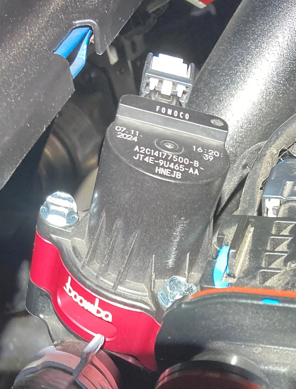

I did shop around a little bit. I did not know what a BOV was & never heard of Boomba before joining the MTC forum.
I looked at Boomba ($100) and also the less expensive “knockoffs” on Amazon ($30).
The Illinois made CNC & Anodized BOV was manufactured 20 mins from my childhood home - although I did not know that at the time. Just knew I was paying a premium for a lower 48 product.
So I picked the simple Boomba over the simple knockoffs. I imagine the knockoffs would work fine.
I know there are more complex types of BOV - diverting some of the blow off back into the intake? Why do that? Adds more complexity? I did not research the reasons.
Now that I’ve been driving for a bit - the BOV does not “blow off” very often. Don’t want to waste any boost. But if I’m accelerating & have to lift off the throttle completely for some reason - I do get a “whoosh” that is kind of fun:)
Easy to install on the new Gen EB. Three screws to remove the Bypass Valve. Insert the longer screws & BOV - and put back on. The Bypass Valve is easily accessible on rear top of engine bay. I say pull the trigger!
