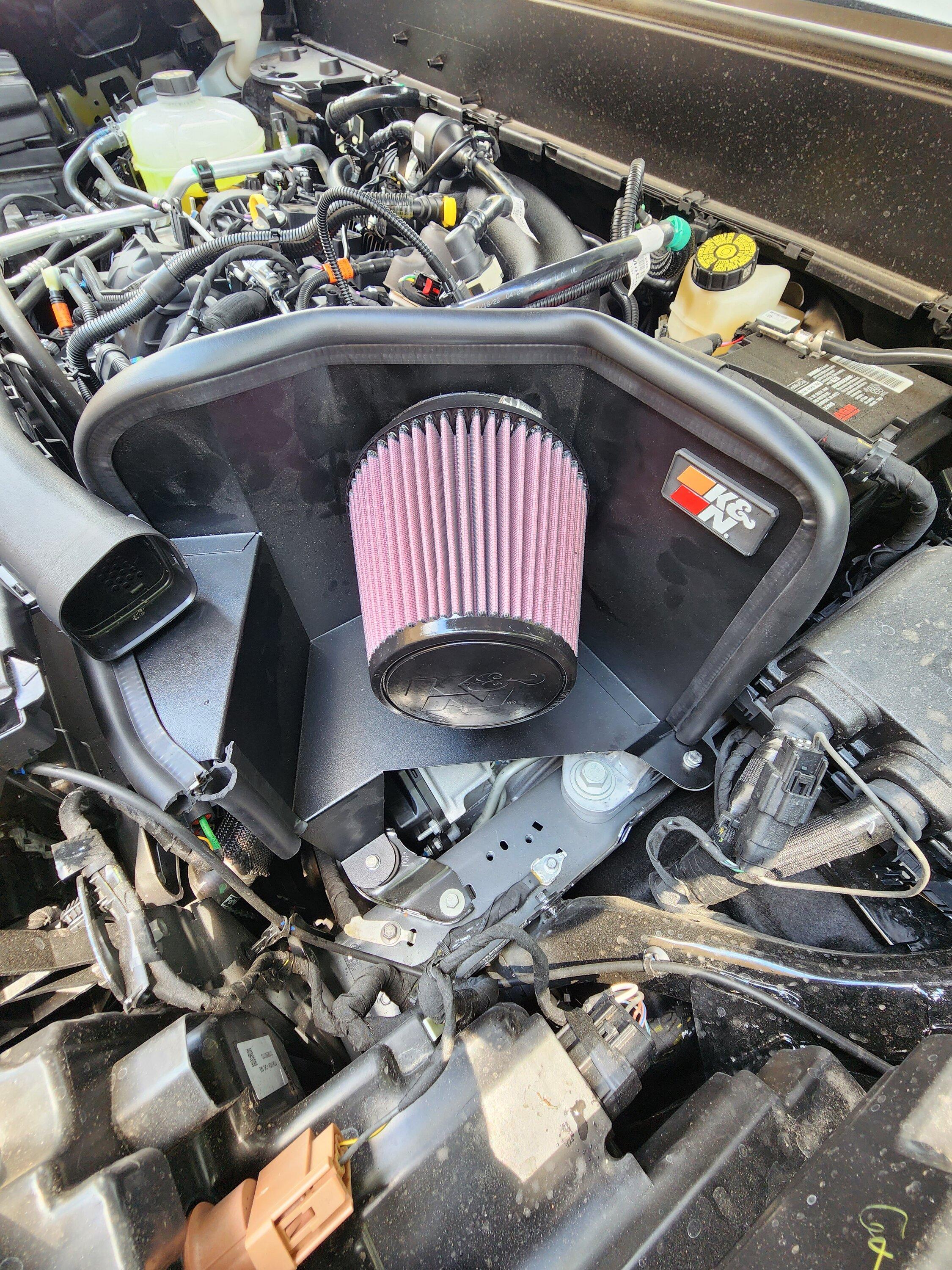

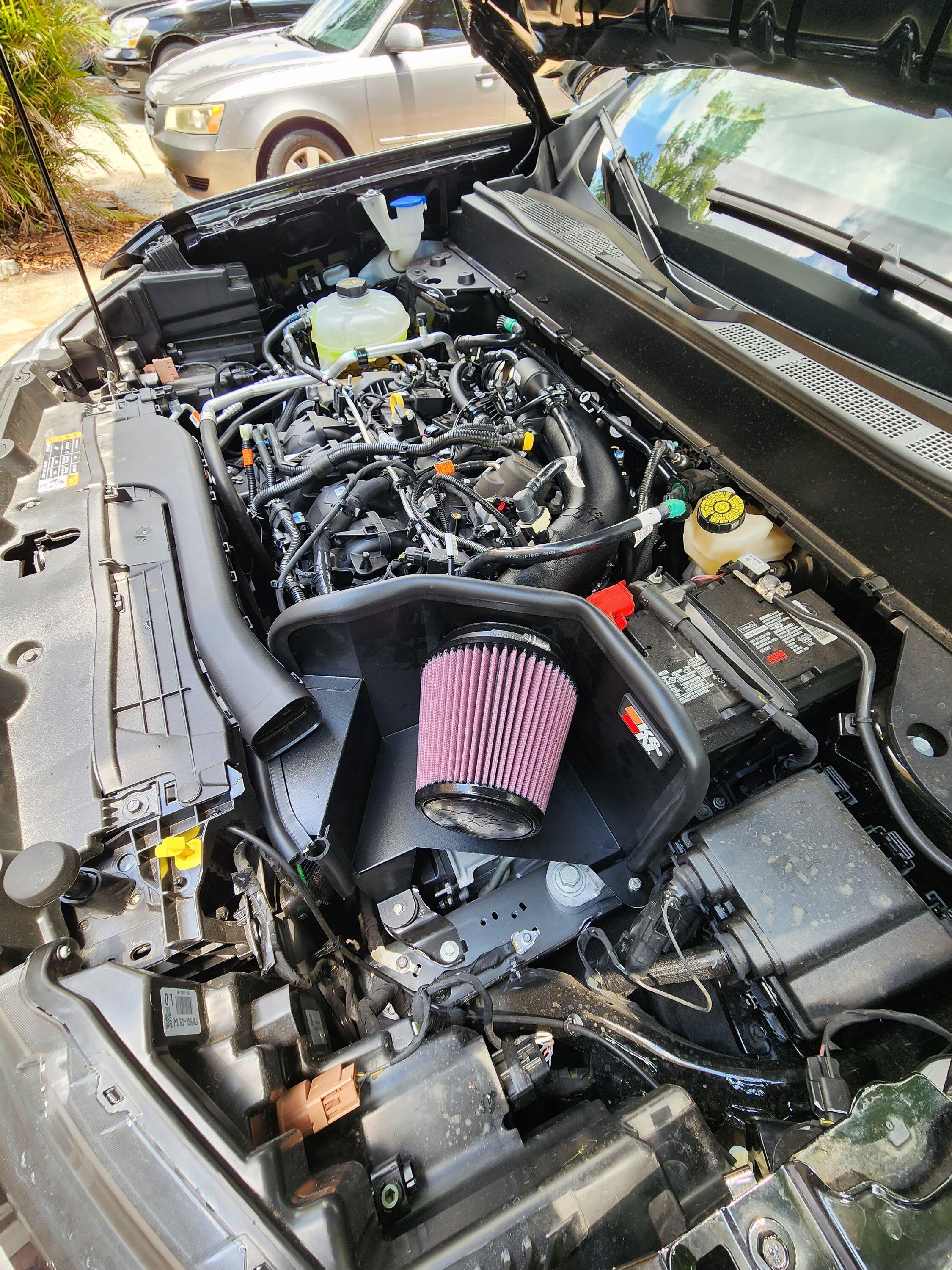

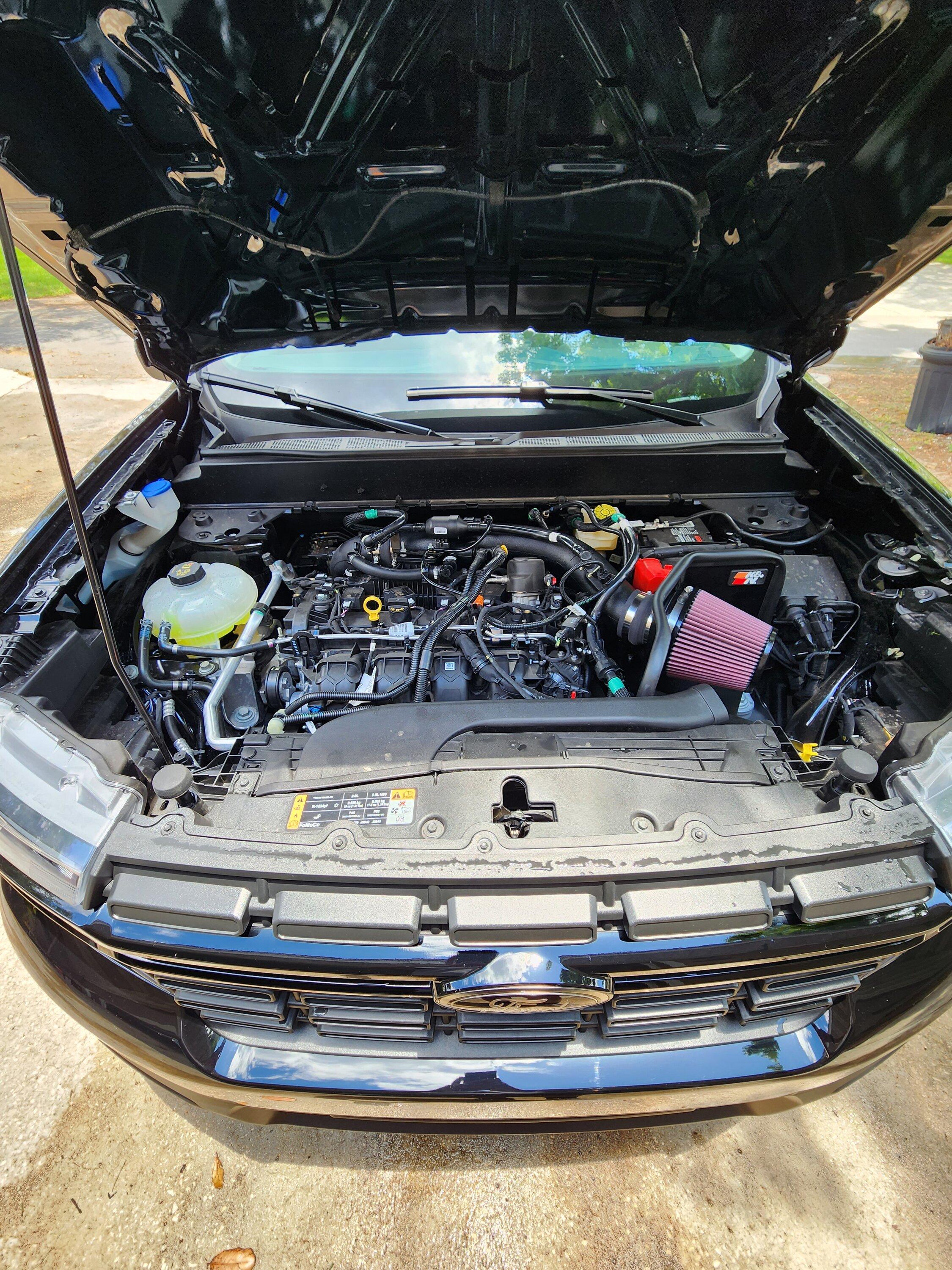

Over the weekend I installed the K&N air intake & Boomba BoV on the Mav.
Prior to install I managed about 200-250 miles on stock.
Post install I felt a bit more "pep" around 2.5 - 4k range (could be mental) my wife says it feels the same as it did when it was stock.
I guess the most noticable changes are the air noises and BoV sounds now. I will say compared to my Bronco the Boomba BoV is pretty timid. Sounds best when you let off around 2-3k under load. Short of that its kind of lack luster.
BoV install was a breeze once the factory intake was out. And the CAI install was equally easy, with the hardest part being the removal of the factory "unservicable" connectors. Sbort of that the whole thing took less than 1 hour to take apart and put together.
Either way, mod looks pretty neat in the engine bay, and butt dyno seems to feel like it was worth spend.

Somethings to consider: it is not clear (AFAIK) of much positive benefit of intake on a forced (turbo) intake engine (there might be some, but minimal); open intakes more likely increase temperature of air into system due to engine compartment heat (I know that it has some "seal" against the hood, but there is still plenty of open area elsewhere); careful with oiled intakes and MAF sensor fouling-use the minimum oil on filter (I prefer dry filters like AFE, etc).
There can be increased intake sounds which is worth 100hp if you're into such. Just the early morning musings over coffee. Enjoy your maverick.
Thanks for your feedback, to your point I do recall reading similar things when doing my research prior to installing.
Mav has a MAP not MAF not too worried in that arena. But I understand oil vs paper, and all the liabilities involved.

I'm glad you didn't get offended (never know in faceless forums). Nothing exciting, just Kureg fake cappuccino. Yeah, MAF term is generic to me but not accurate for all vehicles.

Frankly, I like the look of the K&N. Of all the intakes, I think it looks very at home in the engine baby. Simple and clean. As far as performance goes, S&B's intake will likely be one of the best. New, larger ducting to the filter, enclosed air box, and (to my knowledge) it's the only one to replace the inlet piece before the turbo.
For applications like the Ecoboost though, which intake to go with is really something that I feel most folk don't have to worry their heads too much over.
The stock intake actually supports the 2.0L pretty well. To yield the most of most any aftermarket intake on the Maverick, a decent amount of supporting mods would be in the picture as well (tune, FMIC, DP, upgraded turbo, etc).
With just an intake, folk will likely only experience a mild bump in performance that they may or may not really notice. Not that I'm against the modification. Even if someone is swapping for just a tiny bit more oomph or fun induction noises, if it's improving their driving experience, awesome!
