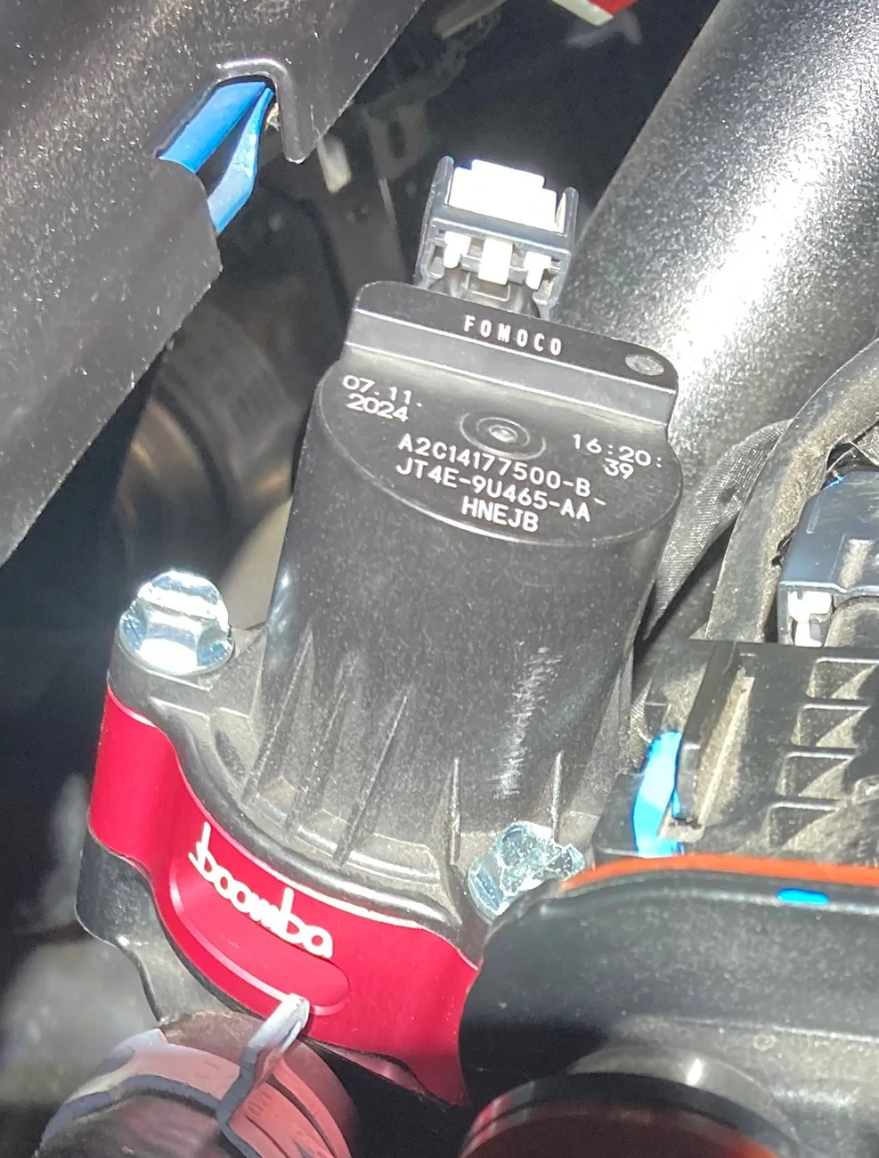

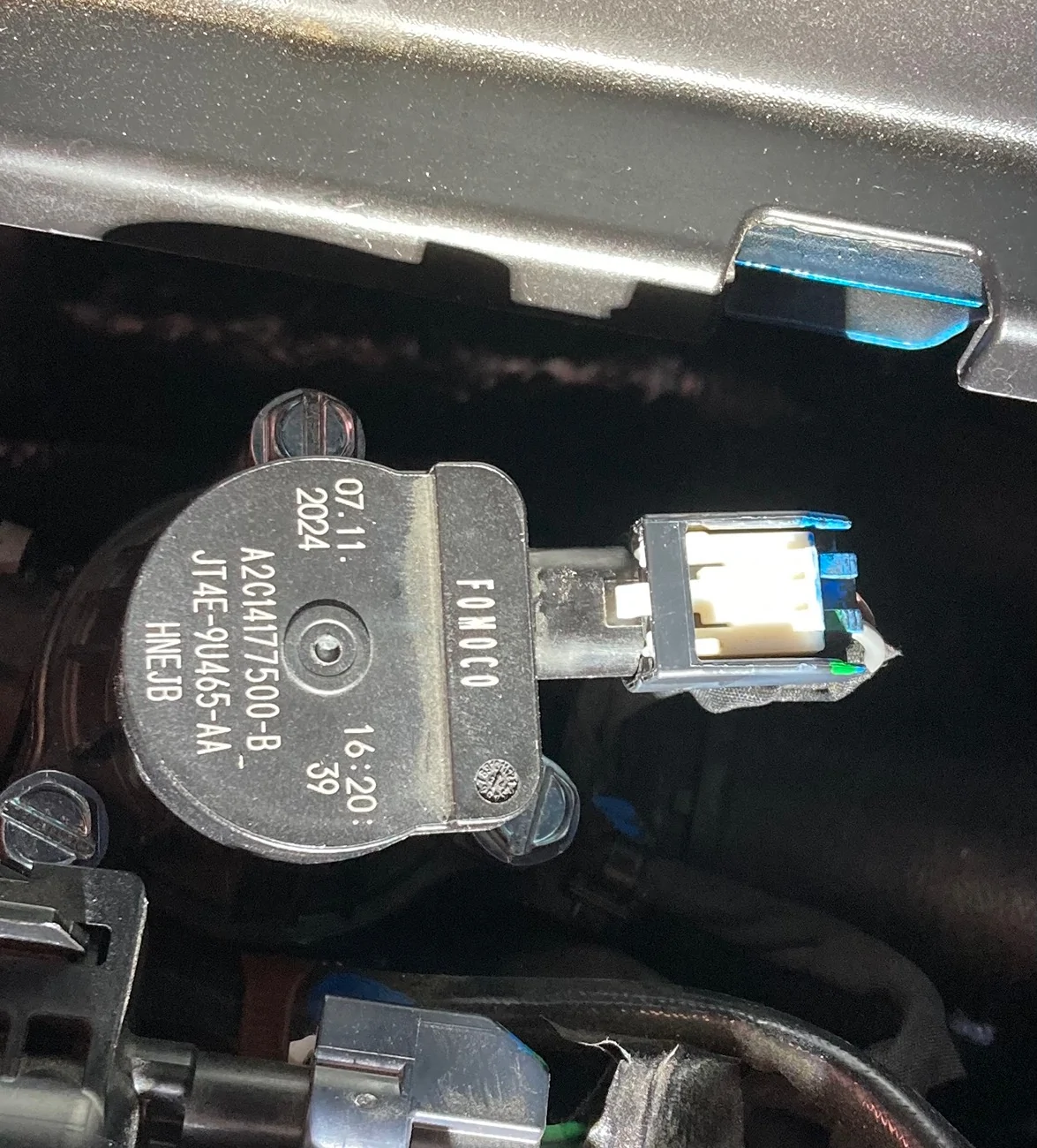

Below are pictures of the Boomba Blow Off Valve (BOV) I installed today on my 2025 EB engine. The BOV is mounted under the OEM bypass control valve.
When you lift off the throttle - pent up air pressure pushes the bypass valve open and will divert the pressurized air back to the intake tube pre turbo via a plastic tube underneath (not visible in pic). This prevents the pressurized air from going backwards into turbo - not good,
With the BOV in place, much of that excess are will “whoosh” out when the bypass valve opens. I’m imagine some air will continue on through the normal tubing too - just not as much.
The OEM harness attached the the bypass valve is there to “throw codes” if the bypass valve solenoid malfunctions.
Not going to test drive until tomorrow. Extreme Heat Warning in effect here & garage is already at 110!

The Bypass Valve on the new EB is top center near the firewall. The previous Gen has the Bypass Valve lower on driver side. Just fyi…

Test rode it today. Sounded great - even with windows up. A subtle whoosh sometimes. A louder whoosh if beans were applied and then foot off the gas!
Sound needs to be induced by crappy mpg driving however. I am not prone to giving her the beans and suddenly lifting off the throttle. My mpg’s will suffer for a bit until the novelty wears off.
Luckily no “codes were thrown” and no turbo flutter either yay!
