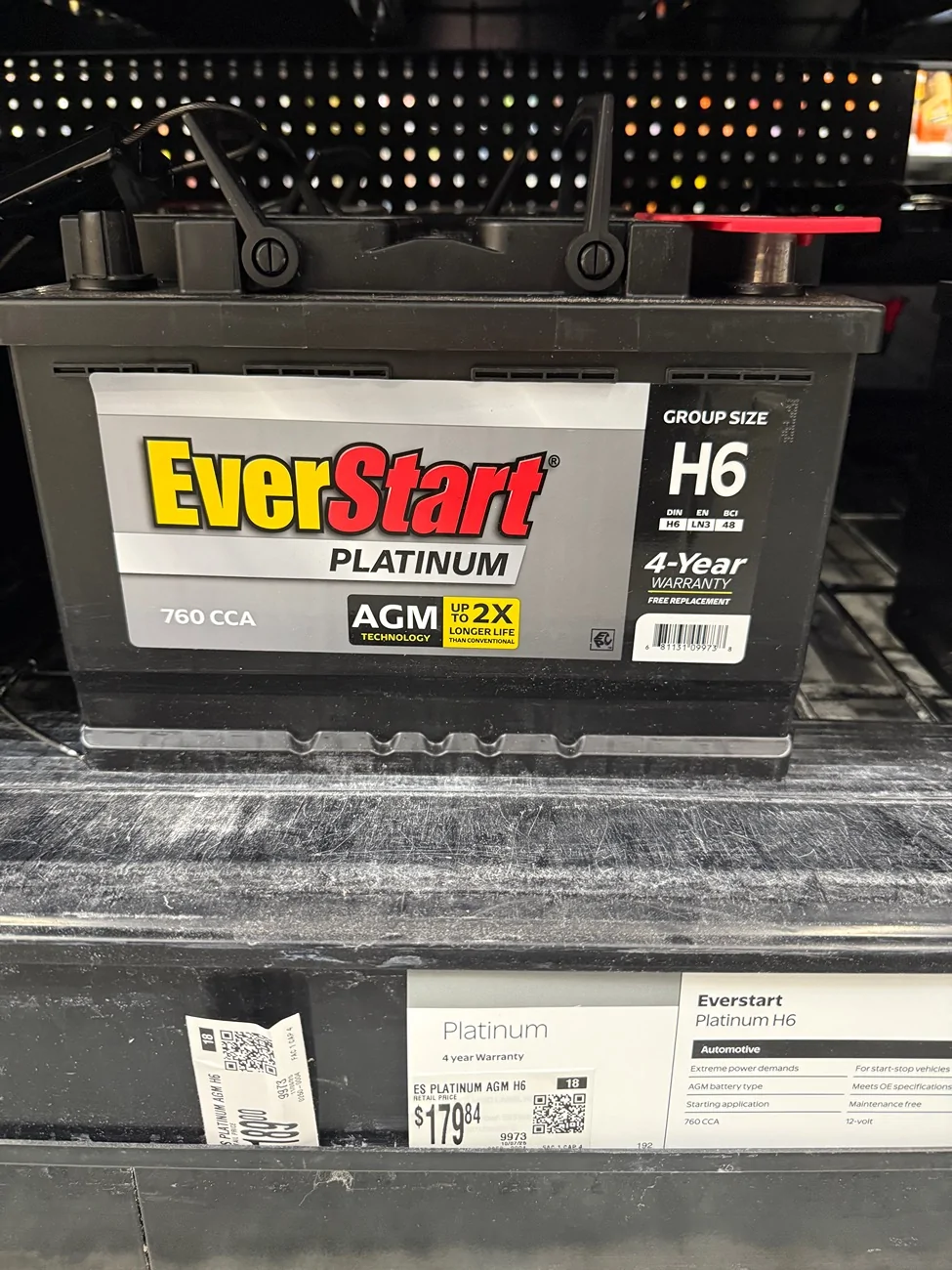

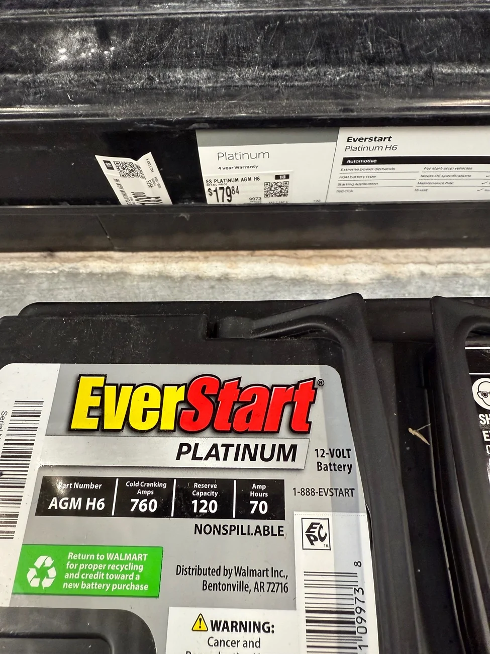

The thing I like about this battery is that it is very inexpensive and it shows that it is made for the Maverick! I have an AGM H5 battery for now. Sometime in 2026 I will buy this one along with the Noco maintenance and.............forgettaboutit!
HeyBales
May 3, 2024
5,989
5,828
KC Metro area
Well - that was the model for the underhood EB Maverick.
H4 is the size of the underseat hybrid Maverick - unless you do some mod's to metal and maybe plastic.
Trying to recall - did you have to trim plastic?
The factory battery on both the ecoboost and the hybrid is a t4. An h4 is the same size except a bit taller. Anything bigger requires mods. A t5 needs a modified baseplate, for example.
