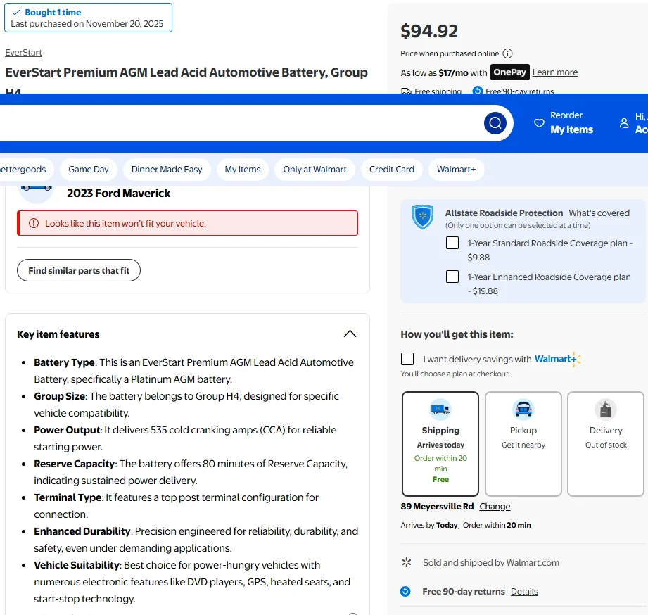

I was considering one of the off-brand AGMs from Amazon, but came across an ONLINE-ONLY AGM replacement from Walmart that struck me as perhaps being an unbeatable deal for only $94.92. Everstart Premium Platinum AGM, (huge) FOUR-YEAR free replacement warranty, free shipping, etc.
The Walmart online listing states free installation, so that's probably available for any who need it.

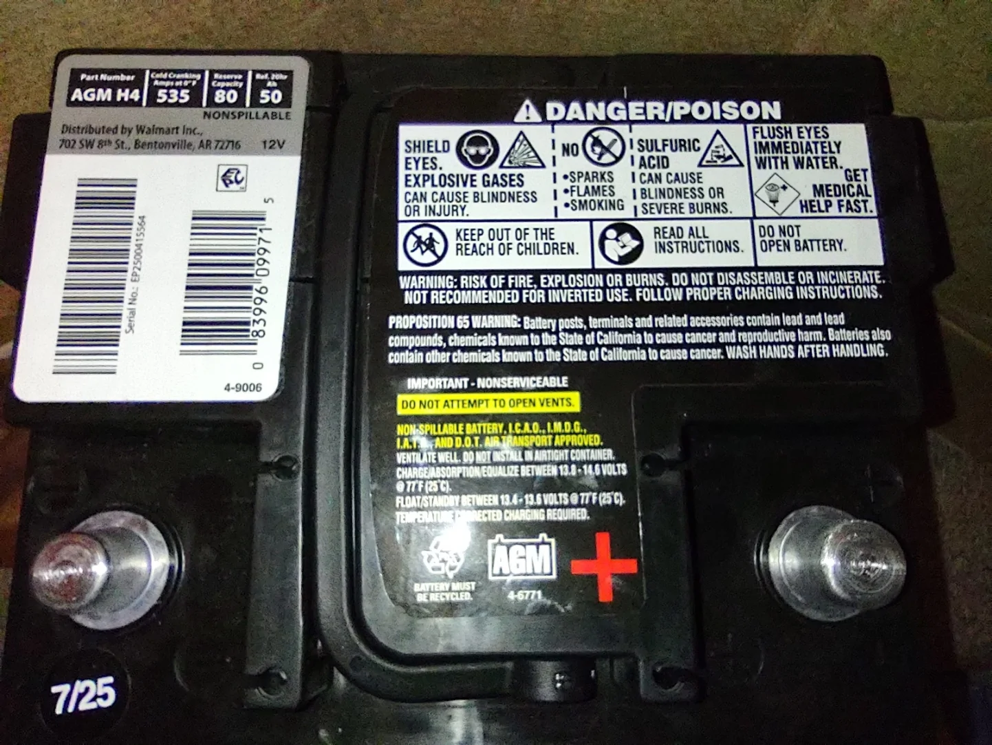

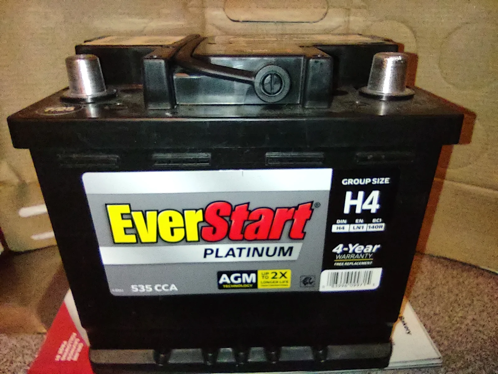

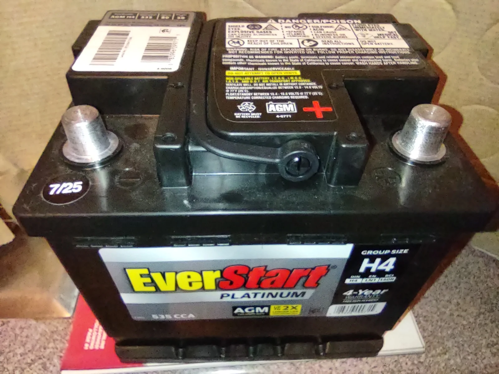

For some reason there is no photo on Walmart's online listing, so here are photos of exactly what I received.
There were some minor typos/discrepancies in Walmart's online listing, so I wasn't 100% sure it would be exactly as hoped, but happily it was. As I encountered elsewhere, online INCORRECTLY indicates that this battery will not fit my '23 XLT Hybrid. I've run into this issue elsewhere and my guess is that there are sites that fail to accurately differentiate between Maverick Hybrid vs non-Hybrid. This AGM in fact turned out to be a perfect fit for my Hybrid.
Concerning this AGM's 535 Cold Cranking Amps rating, that's considerably more than the OEM flooded cell battery. I did see that some other AGMs (like the off-brands on Amazon) claim more than 535CCAs, but I wonder how accurate these "as much as" CCA ratings are and considering the battery isn't used for starting the Hybrid I'm totally satisfied with the 535CCA rating and didn't fixate on that difference.
More importantly, I saw perhaps no others with the 4-year Free Replacement warranty, and if there is a problem, I viewed the ease of potentially dealing with my local Walmart to be a huge plus.
If interested, search for this current Walmart online listing and see my photos (again, disregard the "Looks like this item won't fit your vehicle" shown in this Walmart image and any of the other typos/discrepancies I noticed in the listing).
Free Shipping! EverStart Premium AGM Lead Acid Automotive Battery Group H4, 535 Cold Cranking Amps, 80 Minutes Reserve Capacity - Walmart.com
I view it as a real bargain.

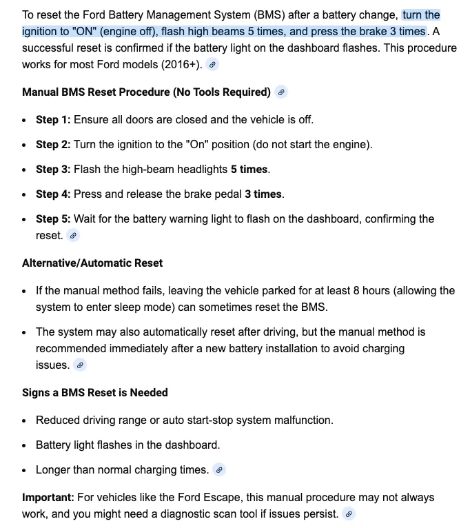

Try this - Charge your battery overnight, then do a BMS reset. This solved my deep sleep and no lights inside problems. It's been very cold here and I've had no problems for the last few weeks after doing this.
