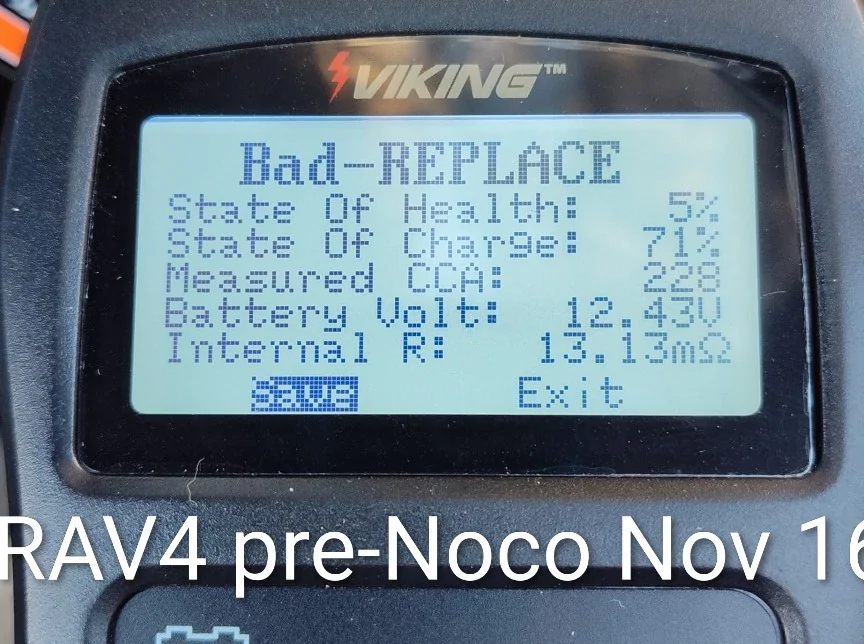

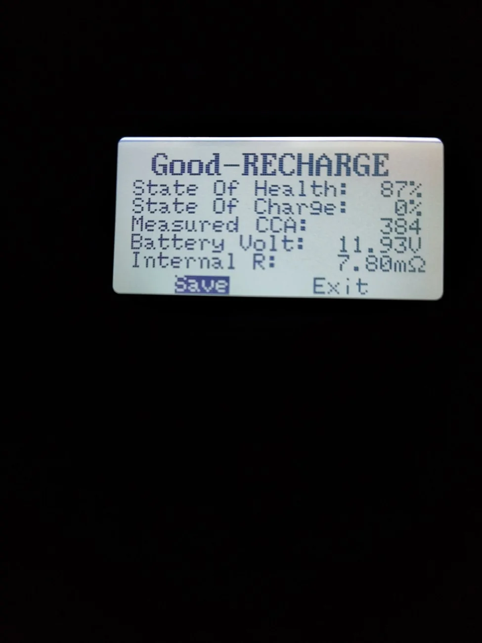

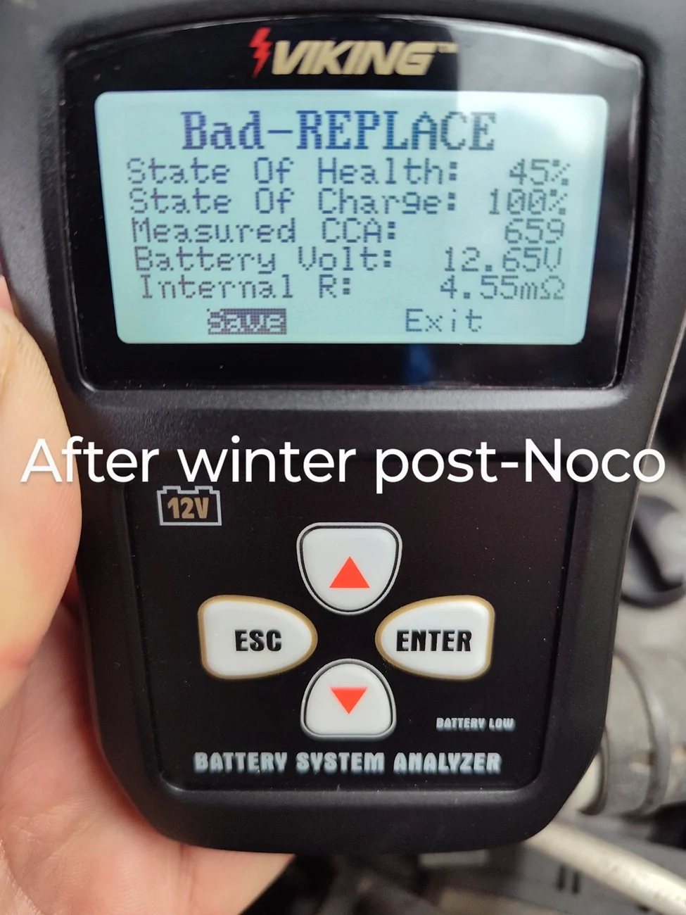

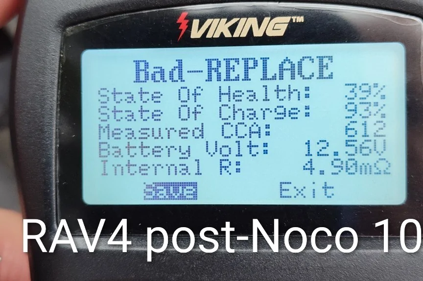

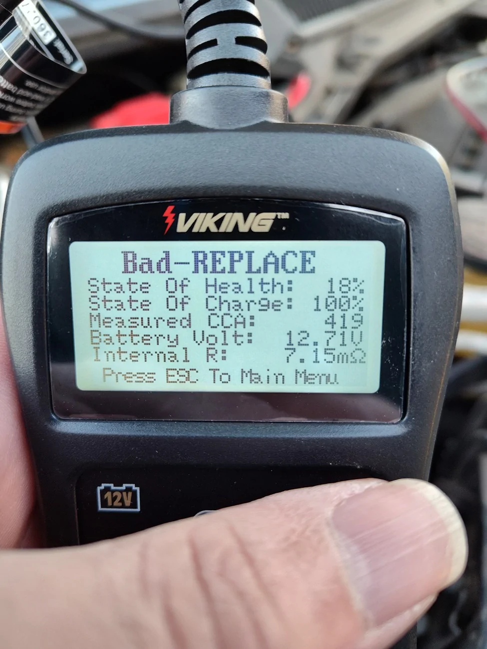

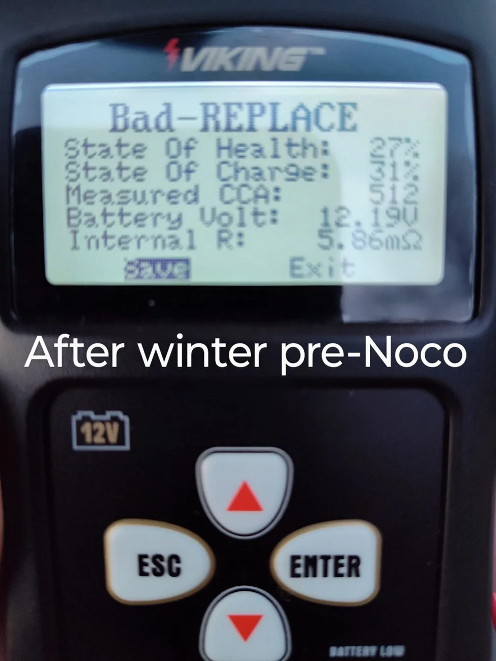

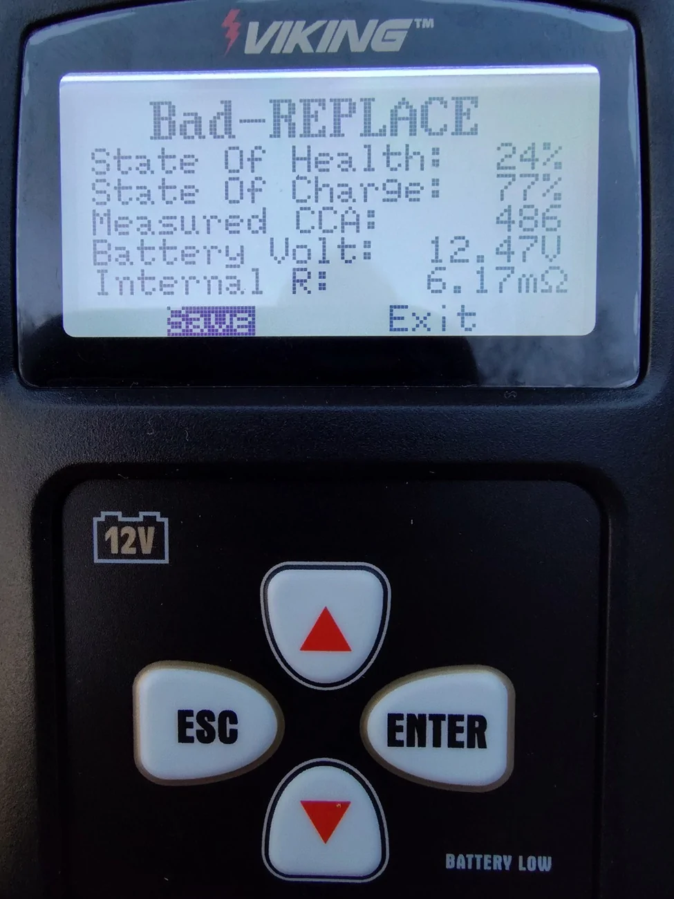

Can you tell if an AGM needs desulphating and how often should this procedure be done? Thanks.
As to the how - you'd have had to get a baseline resistance reading off a not cheapest battery tester, when the battery was almost new.
And on monthly testing discover if resistance heading the wrong direction.
Here's my Rav4 battery test results over the last year. Long periods of non-driving/charging, until this summer at least driven few times weekly.
The fact the resistance increases so easily after a repair mode - I know it's unlikely to make it thru winter, it is old, because the abuse of unused/uncharged for far too long.
Last Dec, before/after after multi-days charging/repair mode with Schumache, but sat for a few days before testing.
After winter and some driving at least, try repair again - Noco this time.
This Nov, 10 days on Noco.
Son said power point V reading was 12.3 before taking off for trip. So 2 weeks later not holding.
For comparison - Maverick original small FLA in Jan, prior full recharge Sep. Made it till Jul.
