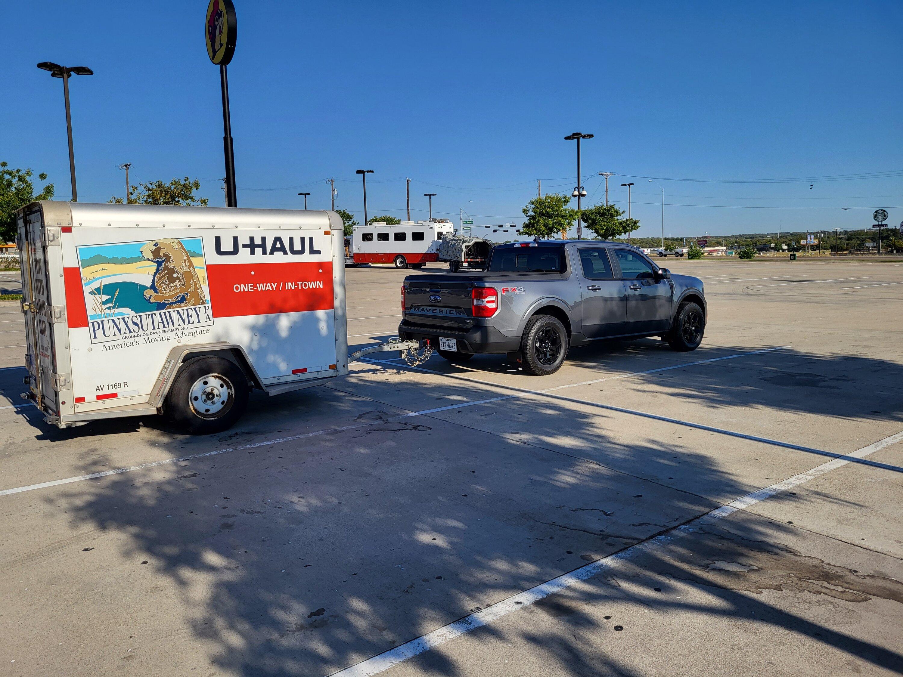

With a 3" drop you can comfortably lower the tailgate with a trailer hitched up.

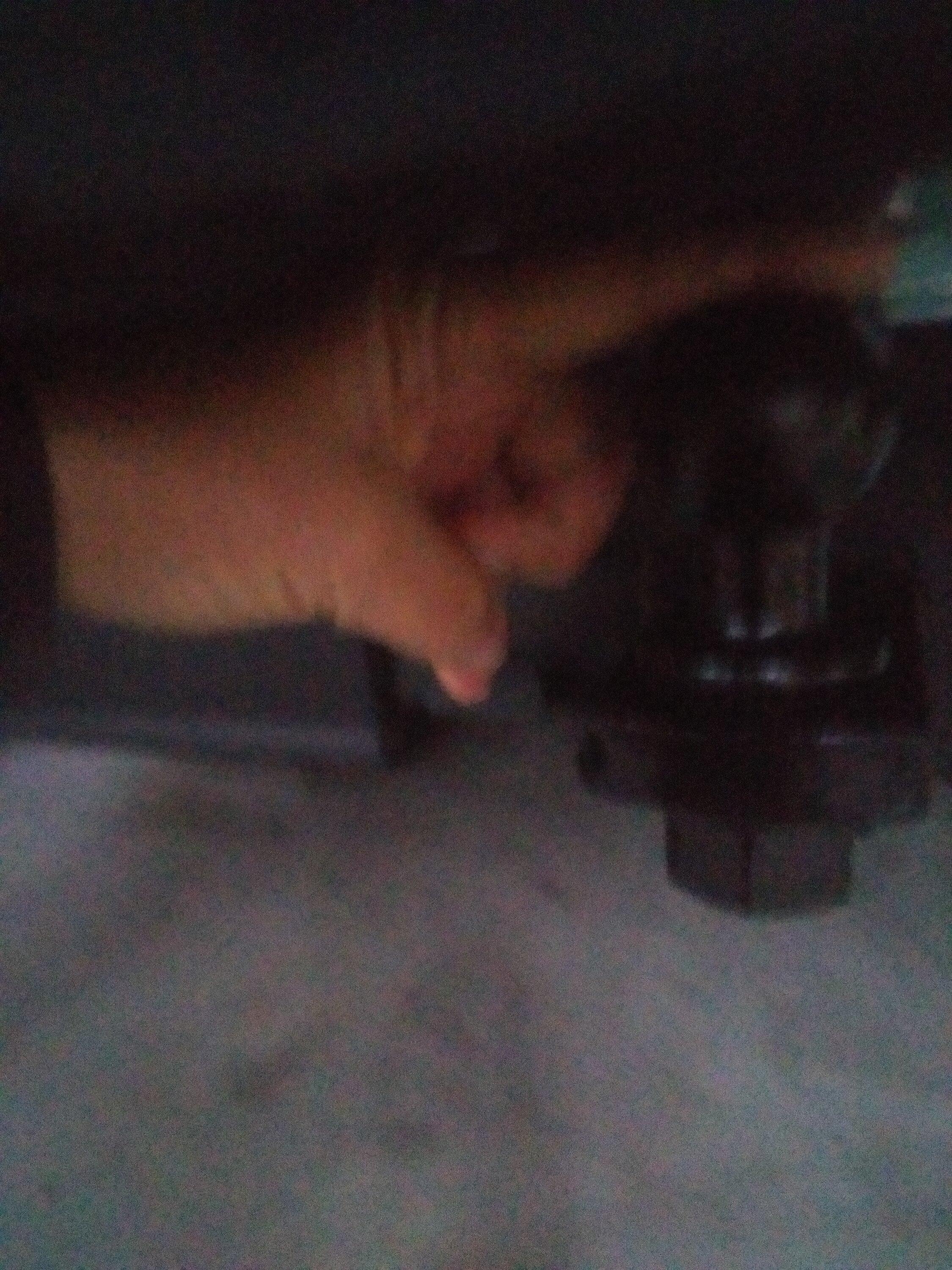

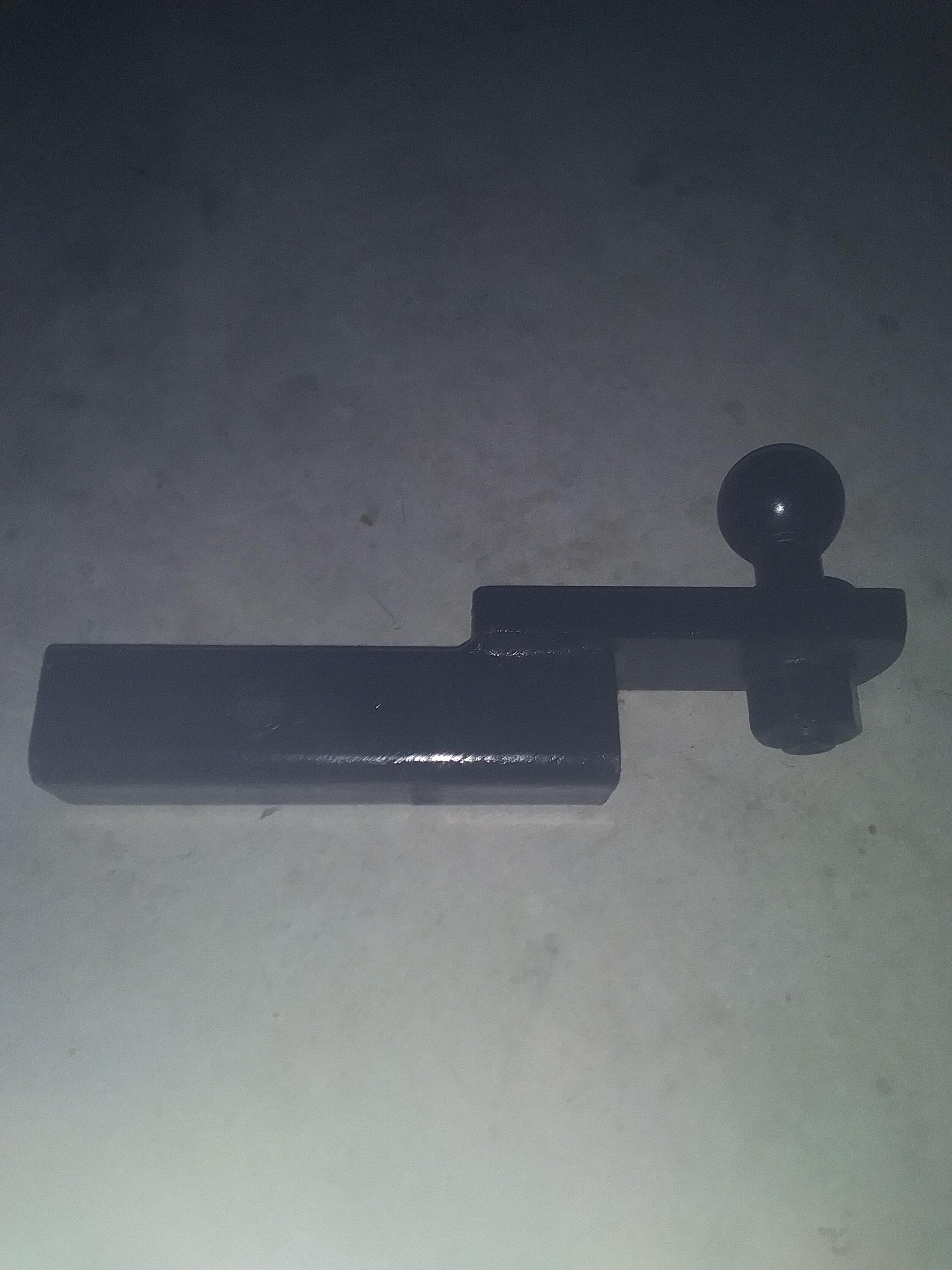

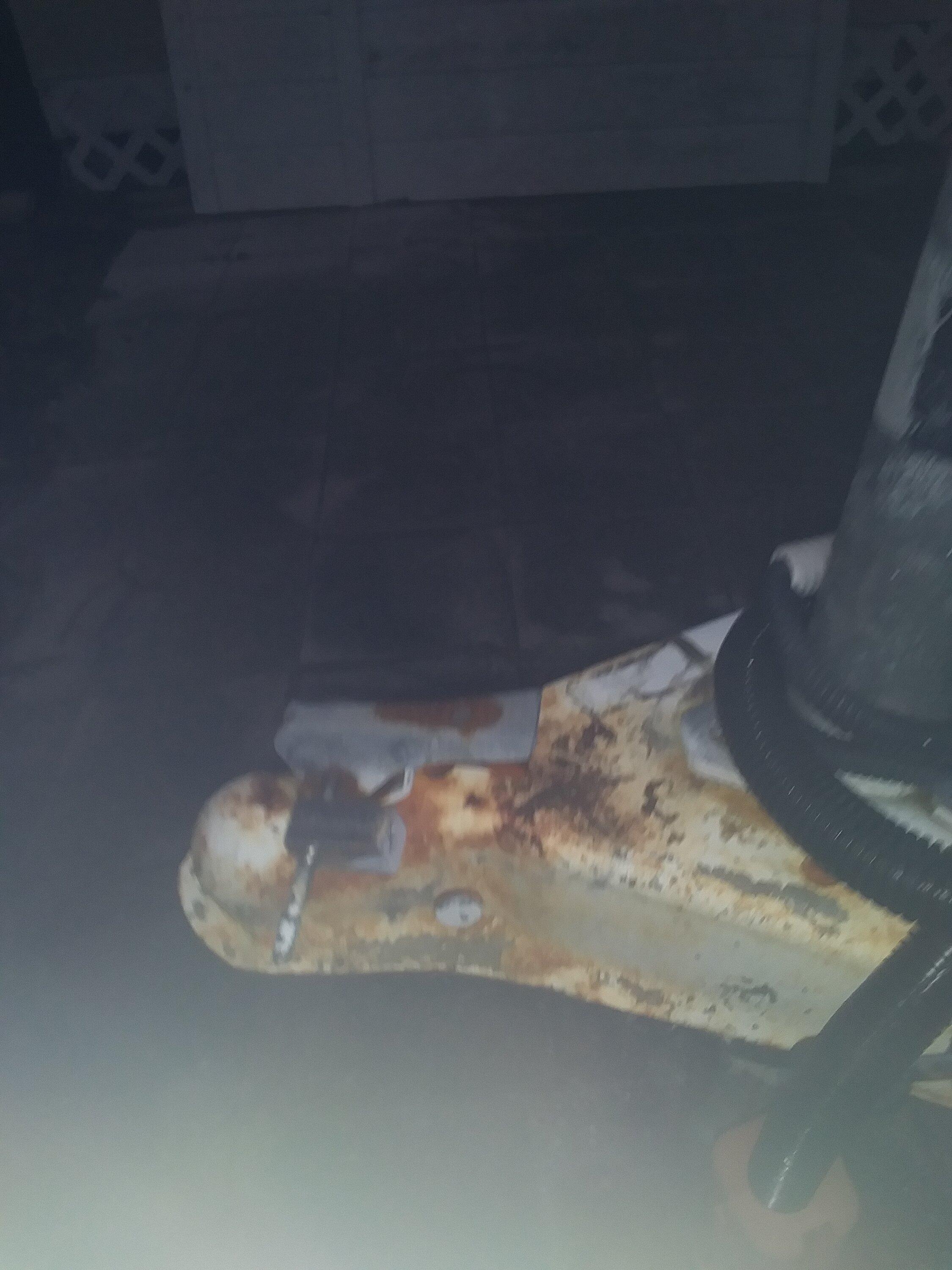

I have fx4 . I have numerous hitch bars . I checked 2 inch bar with 3/4 inch risers with 2 inch ball on it (pics) . tail gate misses ball by about 1/2 inch . trailer tongue safety latch ( pic) would hit . haven't trailered with it yet and don't know which would run level . I suspect that a couple inch drop would be needed if hitched up would be needed so tailgate doesn't hit . it also depends on the trailer tongue setup . I had a f150 and towed a rpod 16 ft travel trailer but could not open the tailgate with trailer hooked up . trailer tongue was to short . there are hitch bar extenders but I just made due .
Thanks! I'm not worried about dropping the tailgate with the trailer attached, I just didn't want to have to pull the insert if i didn't have to.
