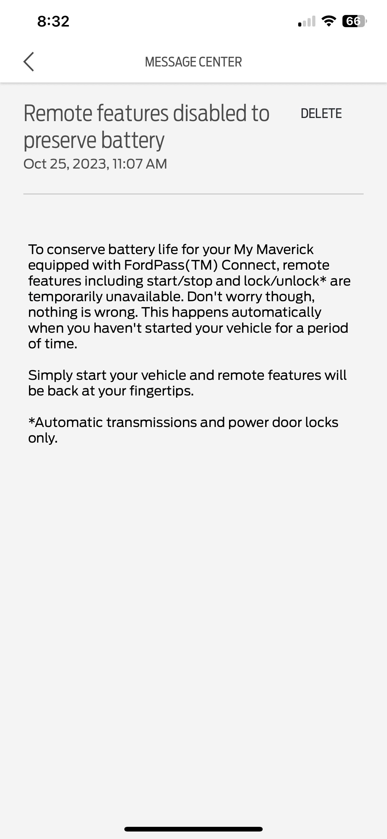

I haven’t even had my Hybrid Maverick for a month and already the 12V battery is an issue. Parked at the airport for two weeks and got a message on the Ford Pass App that the truck has gone into “preservation mode”

Maybe we should post our battery info from the label, and see if those having the issues are from the same batch of batteries? I've seen intermittent sleep & conservation messages since Labor Day weekend, with no rhyme or reason. Sometimes its after I've actually driven more, other times when I haven't driven much. - Although I have a hunch it relates to how I lock the truck, as posted in another thread.
Be interesting if all the those with the issue are from the same lot of batteries.
