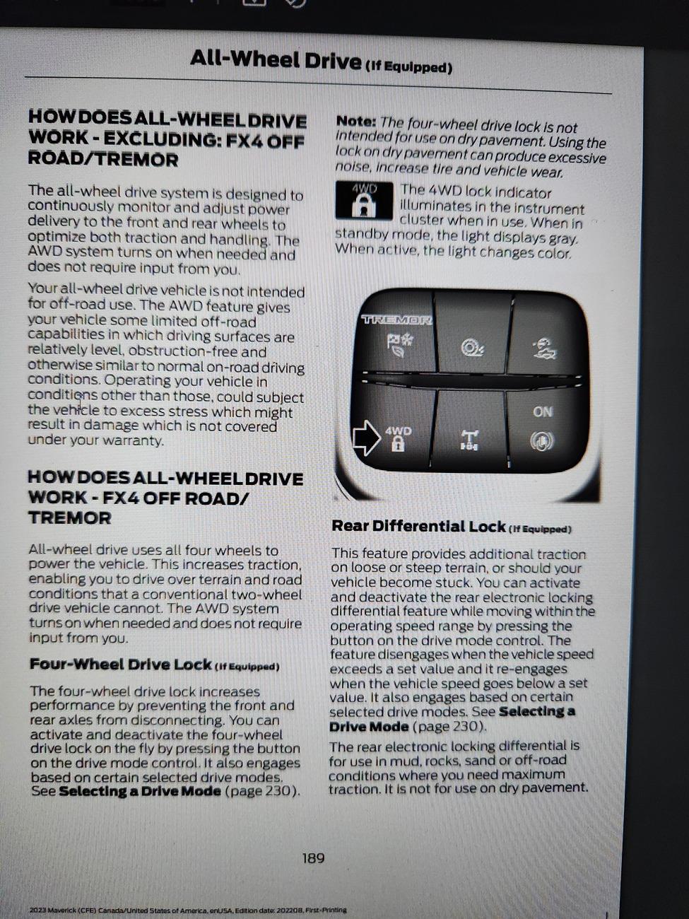

Is yours an FX4 with 4k TOW or just AWD with 4k tow?? The AWD systems apparently operate differently between those configurations.
From my owners manual
Mine is just a XL with towing package

If I understand correctly.tow modes main function is to keep the transmission from going into the lowest or highest range of gears to lessen the work it's doing while towing?
Exactly. So it doesn't make the awd system work any better. The slippery modes or whatever other high traction modes you have, i'm only familiar with my Tremor, will get you more aggressive rear power transfer.
